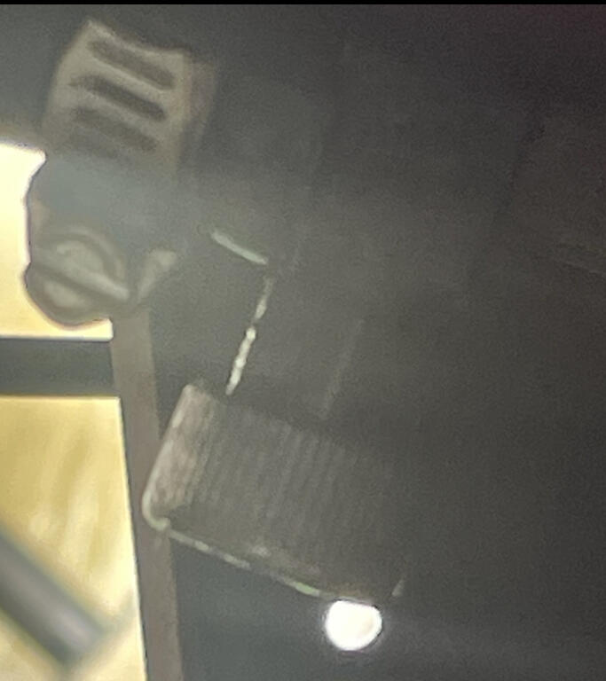

FLtractor 239 #1 Posted July 30, 2025 (edited) Started my 856 tonight after not starting it In probably 1- 2 months.. kept In non insulated, open to humidity and moisture air but not as rain or sun metal shed in central Florida… started and drove then it shut off.. gas tank (with previous owner regular gas still in it) just about empty.. so put half a tank in from plastic cans I keep outside under a lean too.. non ethanol fuel.. bought about 2 months ago.. turned key and played with throttle and choke over and over till engine wanted to start but only cranked then got weaker and weaker till no more engine turn over yet tractor dash light turns on.. and no noise from tractor now.. checked gas tank .. had same amout. Of gas as before filled.. looked under and the round knob leaking so I turned it tight but didn’t see any gas on under parts of tractor.. any thoughts on why this is occurring and how to get tractor running starting properly at this point? Battery dated 5/23. Only differences I’ve done tonight vs every other time started tractor is filled with gas and put on emergency brake for first time ever when on incline - but that’s not electrical so I don’t believe that would have any impact on what’s going on. Edited July 30, 2025 by FLtractor Share this post Link to post Share on other sites

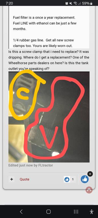

FLtractor 239 #7 Posted July 30, 2025 (edited) 5 minutes ago, ebinmaine said: A#1. Replace ALL fuel lines AND the TANK OUTLET. That's a maintenance item. And it's obviously broken. Fuel filter is a once a year replacement. Fuel LINE with ethanol can be just a few months. 1/4 rubber gas line. Get all new screw clamps too. Yours are likely worn out. Is this a screw clamp that i need to replace? It was dripping. Where do I get a replacement? One of the Wheelhorse parts dealers on here? Is this the tank outlet you’re speaking of? Edited July 30, 2025 by FLtractor 1 Share this post Link to post Share on other sites
ebinmaine 80,881 #8 Posted July 30, 2025 2 minutes ago, FLtractor said: Is this a screw clamp that i need to replace? It was dripping. Where do I get a replacement? One of the Wheelhorse parts dealers on here? Is this the tank outlet you’re speaking of? Yellow with "C" is the screw clamp. Red with the "V" is the valve. The valve will likely screw into the tank bottom. Check with @76c12091520h Brian Badman? Otherwise PLEASE PLEASE do yourself a favor and get good quality parts. Not off the jungle site. I've had great luck dealing with Aircraft Spruce Company for fuel related parts. 1 Share this post Link to post Share on other sites

FLtractor 239 #12 Posted July 30, 2025 25 minutes ago, ebinmaine said: Yellow with "C" is the screw clamp. Red with the "V" is the valve. The valve will likely screw into the tank bottom. Check with @76c12091520h Brian Badman? Otherwise PLEASE PLEASE do yourself a favor and get good quality parts. Not off the jungle site. I've had great luck dealing with Aircraft Spruce Company for fuel related parts. I know you said to get quality parts.. but would you recommend I see it I can order a bundle such as this? But with quality parts ? https://www.ebay.com/itm/325522697222?_skw=1966+wheelhorse+856+fuel+tank+valve&itmmeta=01K1EVR71TXV53YDVHE51ZYDTJ&hash=item4bcaaa2c06:g:uyEAAOSwwQpi6fxm&itmprp=enc%3AAQAKAAABAFkggFvd1GGDu0w3yXCmi1fLDFByXMR4geYgCFePo%2FsS5sm9EKwVSED6gs2cKc%2Fhd0zraI0RXLJB5eiWAKO%2FnYolFwF7z5sKaEmYGFNzLDAnJ2QXsNdMCtpww6LIa8LOmiUwL%2Fii3O4YXn2Uqhyzh%2FJiUuhBjLqPgXYy4qlY9%2FGDeAsqCel9boTGqzFk2T89MkVaLNg2u%2BI6ojGKX2gwXhXXnB7EuD3sFq6W3cj5lRxh5skgU8MxfdL0%2F8rvLBgtt26dcOG03c%2BCJduKsVsiMPON2EcIGxKCeVs4ygXxuQA19PWTWsB0NQSPntckqOhcK%2FSRnDJbAJr1cixDhVUhQH8%3D|tkp%3ABk9SR4Tx4NuLZg Share this post Link to post Share on other sites

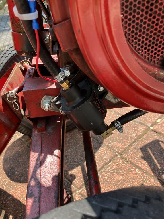

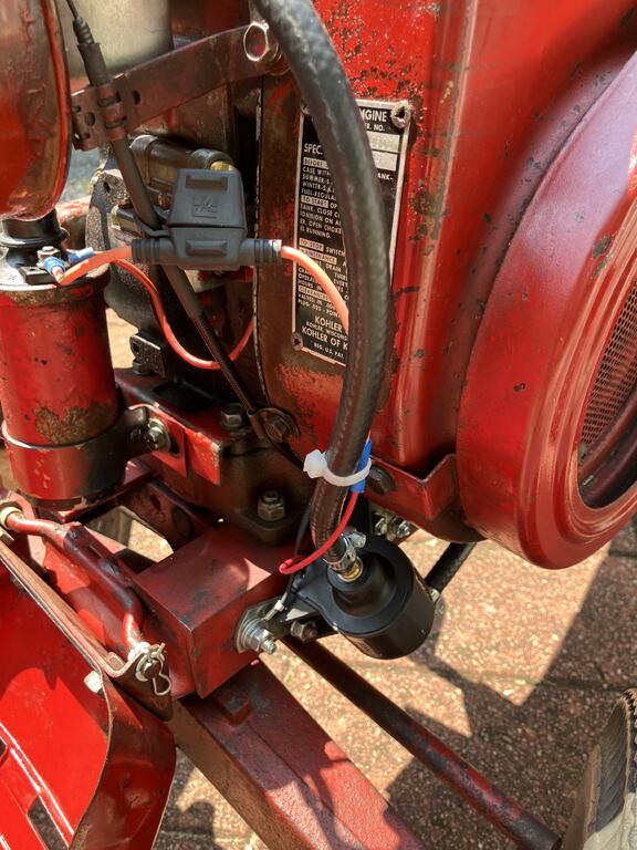

Retired Wrencher 6,993 #20 Posted July 31, 2025 (edited) 10 hours ago, FLtractor said: If I do accidentally destroy seal or it breaks crubbles from being so old .. is aircraft spruce best place for replacement? This is where I put my fuel pump on the 856.It calls for a low placement. Just start fresh and change every thing -lines -filters-carb rebuild.Good luck and hope it turns out well. Edited July 31, 2025 by Retired Wrencher 4 Share this post Link to post Share on other sites

FLtractor 239 #23 Posted July 31, 2025 2 hours ago, Retired Wrencher said: This is where I put my fuel pump on the 856.It calls for a low placement. Just start fresh and change every thing -lines -filters-carb rebuild.Good luck and hope it turns out well. What is this black piece on the yellow ish tubing for? Do you have a link for that and that fuel pump you have installed? Share this post Link to post Share on other sites

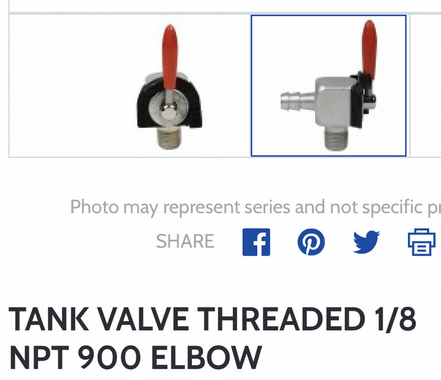

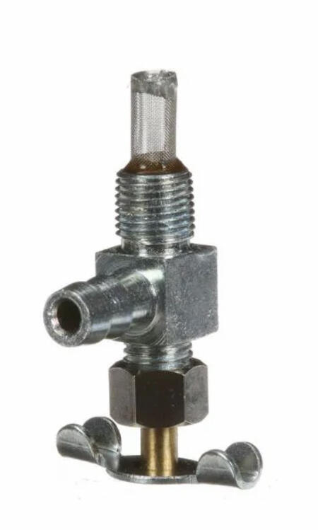

Kenneth R Cluley 712 #24 Posted July 31, 2025 Shut off Valve threads into fuel tank. Go to local hardware and get a "nipple" or better yet a brass hose barb adapter with proper thread (1/8"pipe?) and 1/4" hose barb. Tank will be empty to achieve this. Connect "new" 1/4" fuel line to hose barb with screw clamps(also at hardware store). 1 Share this post Link to post Share on other sites
FLtractor 239 #25 Posted July 31, 2025 (edited) 1 hour ago, Kenneth R Cluley said: Shut off Valve threads into fuel tank. Go to local hardware and get a "nipple" or better yet a brass hose barb adapter with proper thread (1/8"pipe?) and 1/4" hose barb. Tank will be empty to achieve this. Connect "new" 1/4" fuel line to hose barb with screw clamps(also at hardware store). I ordered one of the valves I was recommended on here from spruce aircraft but also found this one at a local store gonna go pick it up today.. to get it going sooner and also keep the other valve once it arrives for future replacement. Happen to have a video on carb removal and install on these old wheelhorses? Edited July 31, 2025 by FLtractor Share this post Link to post Share on other sites
