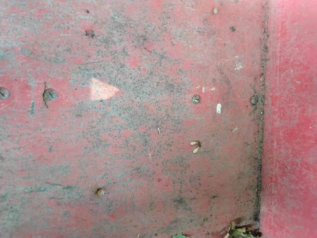

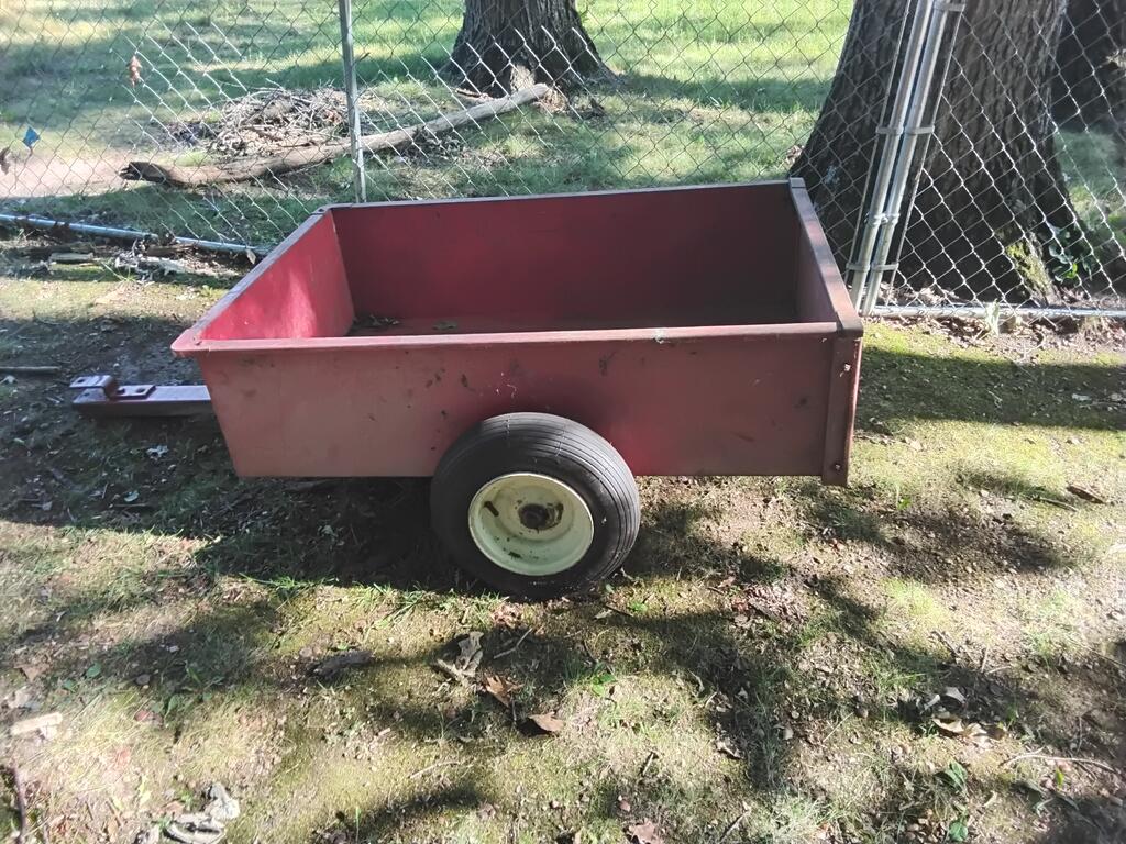

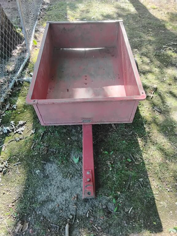

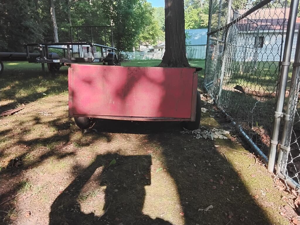

8ntruck 9,174 #8 Posted July 24, 2025 I took some 'before' pictures: 3 Share this post Link to post Share on other sites
