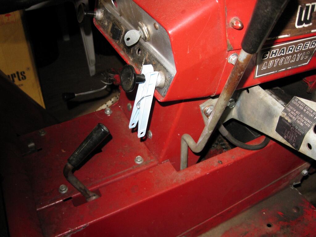

pfrederi 21,215 #2 Posted July 14, 2025 Choke cables will not lock...When I have a throttle cable that will no longer lock clothes pins to the rescue. one fast idle 2 full throttle 2 Share this post Link to post Share on other sites
ebinmaine 80,881 #3 Posted July 14, 2025 All of Trina's tractors have that wanna-lock cable. We've tried several different types. I/we don't have a favorite yet. PM @76c12091520h Brian Badman. My only other suggestion is to check with Aircraft Spruce Company yo see if they have a locking cable. It'll be $$$ because they sell AIRCRAFT parts. But it'll work. Share this post Link to post Share on other sites

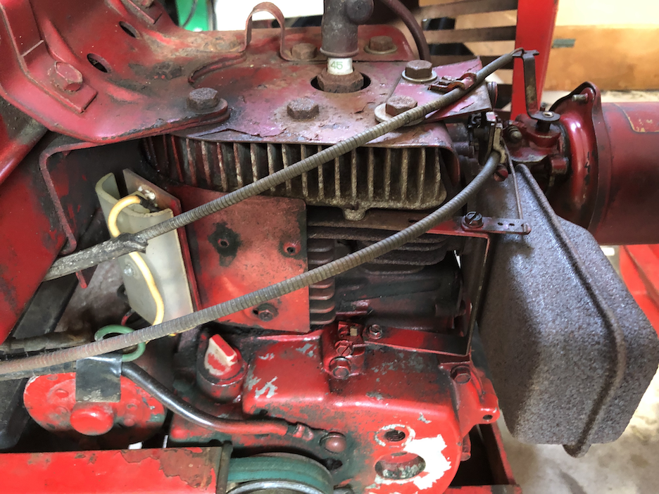

UNBOUND 73 #11 Posted July 16, 2025 Got the new cable today and of course it doesnt come with the nut. A 9/16-18 jam nut should work fine. Anyone know how long the cable should be on a Lawn Ranger, this one is way too long so will have to shorten it. The one that was on it is about 26 inches long. Share this post Link to post Share on other sites
ebinmaine 80,881 #12 Posted July 16, 2025 4 minutes ago, UNBOUND said: Anyone know how long the cable should be on a Lawn Ranger, this one is way too long so will have to shorten it. @Handy Don do you happen to know? My experience shows me to stay a little longer than stock. They seem to work better. Share this post Link to post Share on other sites
UNBOUND 73 #13 Posted July 16, 2025 Not sure what stock length is. A photo of one would be great. Dont want it to hang out from under the hood too far. Share this post Link to post Share on other sites
Handy Don 17,546 #14 Posted July 17, 2025 (edited) Thanks for the trip down memory lane, @ebinmaine & @ri702bill! I went digging through my LR images and came up with this one. Hope it helps. Choke upper & throttle lower. IMHO, these were a bit too short and if I’d replaced them I’d have added a an inch or two to each to let them bow outward more. Also note that this was an externally identical replacement engine (HH60) from ’71 or ’72, hence the incorrect muffler. Edited July 17, 2025 by Handy Don 1 Share this post Link to post Share on other sites
UNBOUND 73 #15 Posted July 17, 2025 Thats what I was looking for. Got the new one on and working good, At first it was binding so I put a little more angle on my z bend and that took care of the problem. 2 Share this post Link to post Share on other sites
