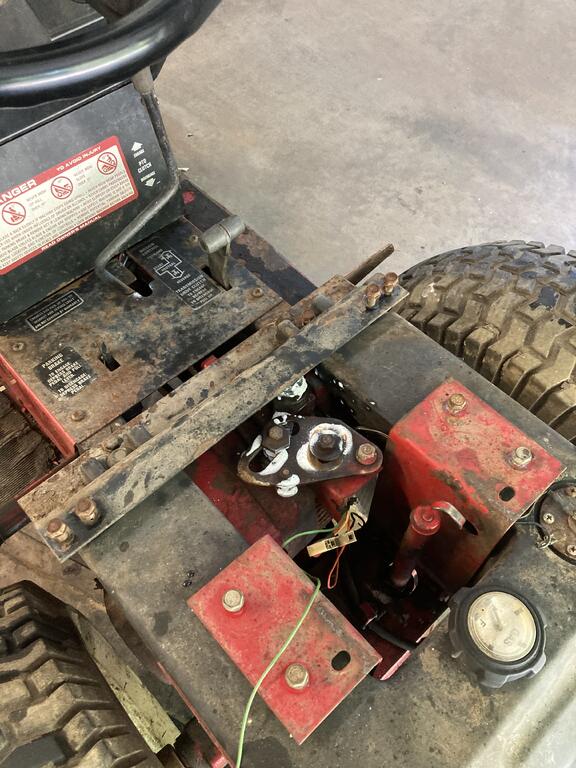

TonyToro Jr. 2,502 #54 Posted July 22, 2025 @peter lena how’s this for non friction?? IMG_1678.mov 1 1 Share this post Link to post Share on other sites
Handy Don 16,907 #55 Posted July 22, 2025 (edited) Ah, um, well...I have really bad news...you NEED friction! Better download and read the Eaton 11 manual about adjusting the linkage for the proper tension. Without friction, you’ll have to hold the lever in position by hand in order to keep moving--let go and it’ll change speed by itself! Edited July 22, 2025 by Handy Don 1 Share this post Link to post Share on other sites
TonyToro Jr. 2,502 #56 Posted July 22, 2025 9 hours ago, Handy Don said: Ah, um, well...I have really bad news...you NEED friction! Better download and read the Eaton 11 manual about adjusting the linkage for the proper tension. Without friction, you’ll have to hold the lever in position by hand in order to keep moving--let go and it’ll change speed by itself! Thanks for telling me! I’ll look into that. Share this post Link to post Share on other sites
lynnmor 8,875 #57 Posted July 22, 2025 10 hours ago, Handy Don said: Ah, um, well...I have really bad news...you NEED friction! Better download and read the Eaton 11 manual about adjusting the linkage for the proper tension. Without friction, you’ll have to hold the lever in position by hand in order to keep moving--let go and it’ll change speed by itself! Yep, you can lube anything else but that cam follower needs to stay dry. Take the cam off and clean it properly and sand the friction washers flat. 1 Share this post Link to post Share on other sites

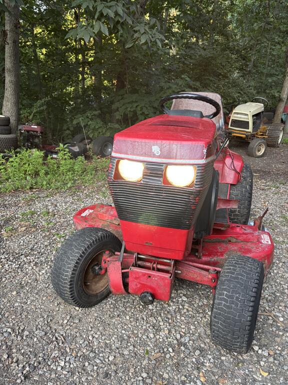

TonyToro Jr. 2,502 #63 Posted July 25, 2025 Figured something out today! So first degreased and washed the 520. Then tonight decided to figure out why the headlights aren’t working. Quite simple. Got the voltmeter and got 12 volts to both lights. Decided the bulbs are shot. Had a set of LED some Brian and K&B horse parts. Put them in. And found out why the lights weren’t working! They were broken in half! So now we have headlights and put bulbs in the taillights and a set of covers I had laying around on and we got a full set of working lights! Tommorow I’m going to dig into why the engine dies when I engage the PTO. Thinking it’s since I don’t have the seat safety hooked up 🤣 But washed the mower deck too and sharpened the blades. And mounted it back up. But probably won’t stay on for long. 1 Share this post Link to post Share on other sites
kpinnc 18,714 #64 Posted July 25, 2025 (edited) 55 minutes ago, TonyToro Jr. said: Figured something out today! Always great to figure out ANY electrical issue! Looks like your front wheels are way off from one another. Might better check to see if those tie rods are the same length... Looks like you'll get alot of service out of that machine. Well done! Edited July 25, 2025 by kpinnc Share this post Link to post Share on other sites
TonyToro Jr. 2,502 #65 Posted July 25, 2025 11 hours ago, kpinnc said: Always great to figure out ANY electrical issue! Looks like your front wheels are way off from one another. Might better check to see if those tie rods are the same length... Looks like you'll get alot of service out of that machine. Well done! Yep that’s next on my list. I have the pair just need to put them on. Share this post Link to post Share on other sites
