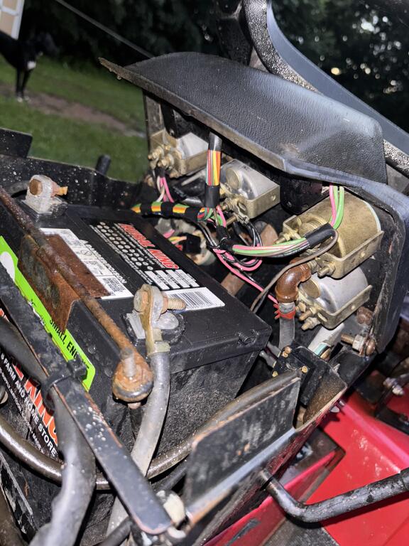

ri702bill 13,068 #2 Posted July 3, 2025 Look at the condition of the dreaded 9 pin connector. Even if it looks OK, undo it to see the terminals. It might be an unpleasant surprize..... 4 1 Share this post Link to post Share on other sites

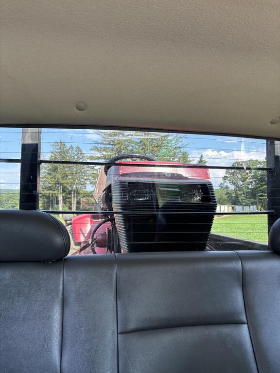

TonyToro Jr. 2,539 #15 Posted July 3, 2025 Now we are home so I can give you the story of the tractor. So this was the PO’s friends tractor. He passed away and it sat for a bit. His barn got cleaned out and the PO bought it from the family. He started to dig into it. He says it cranks over and one cylinder has spark and the other doesn’t. So probably going to dig into this weekend. Oil is not too bad and a tad low. Other then that the tractor is in decent condition with 1058 on the hour meter. Things it will need so far as we can see. Rear lenses for the taillights Gas cap 4 new tires Full tuneup Storm rolling through now. Pics either later or tomorrow morning. 4 Share this post Link to post Share on other sites

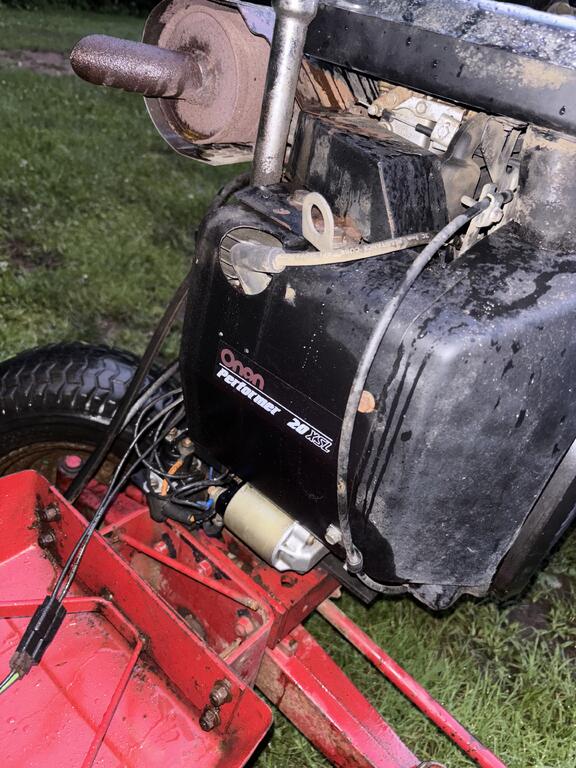

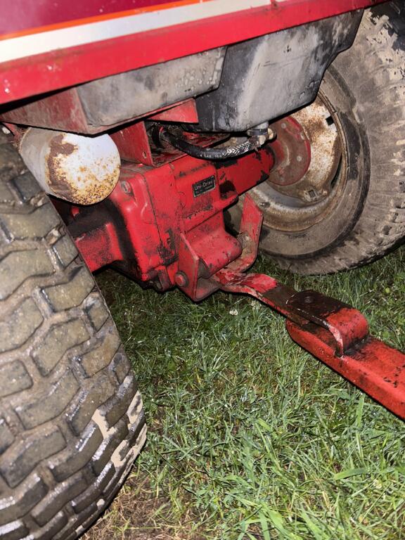

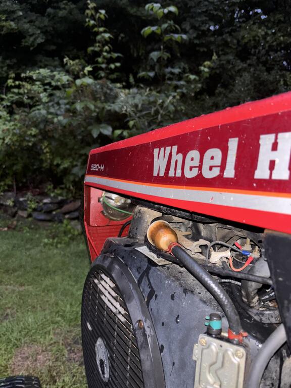

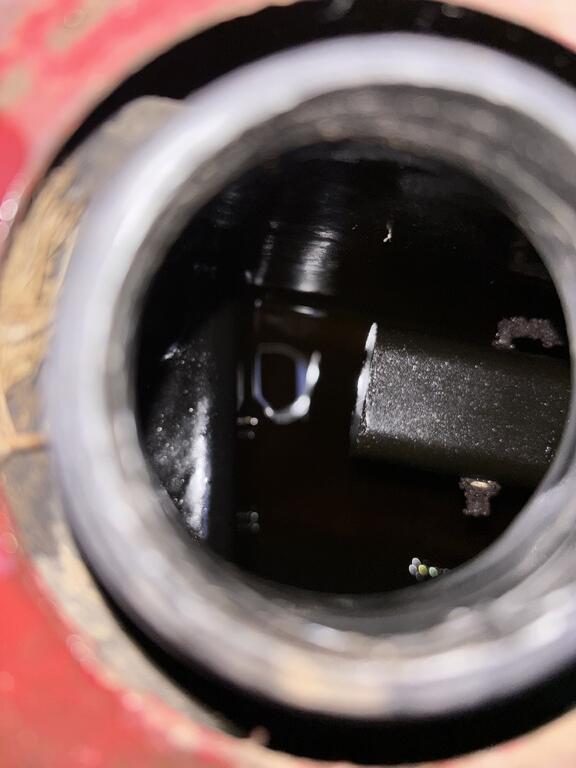

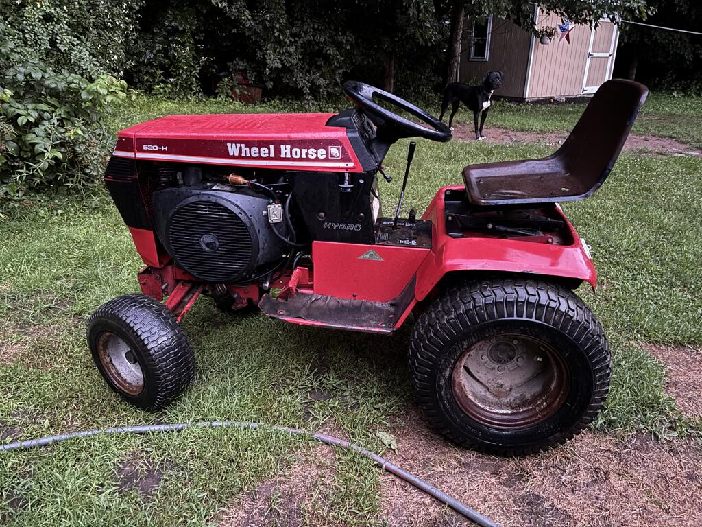

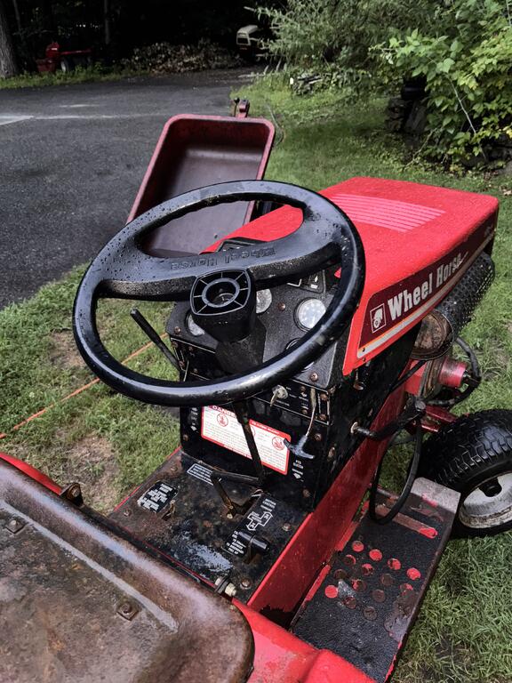

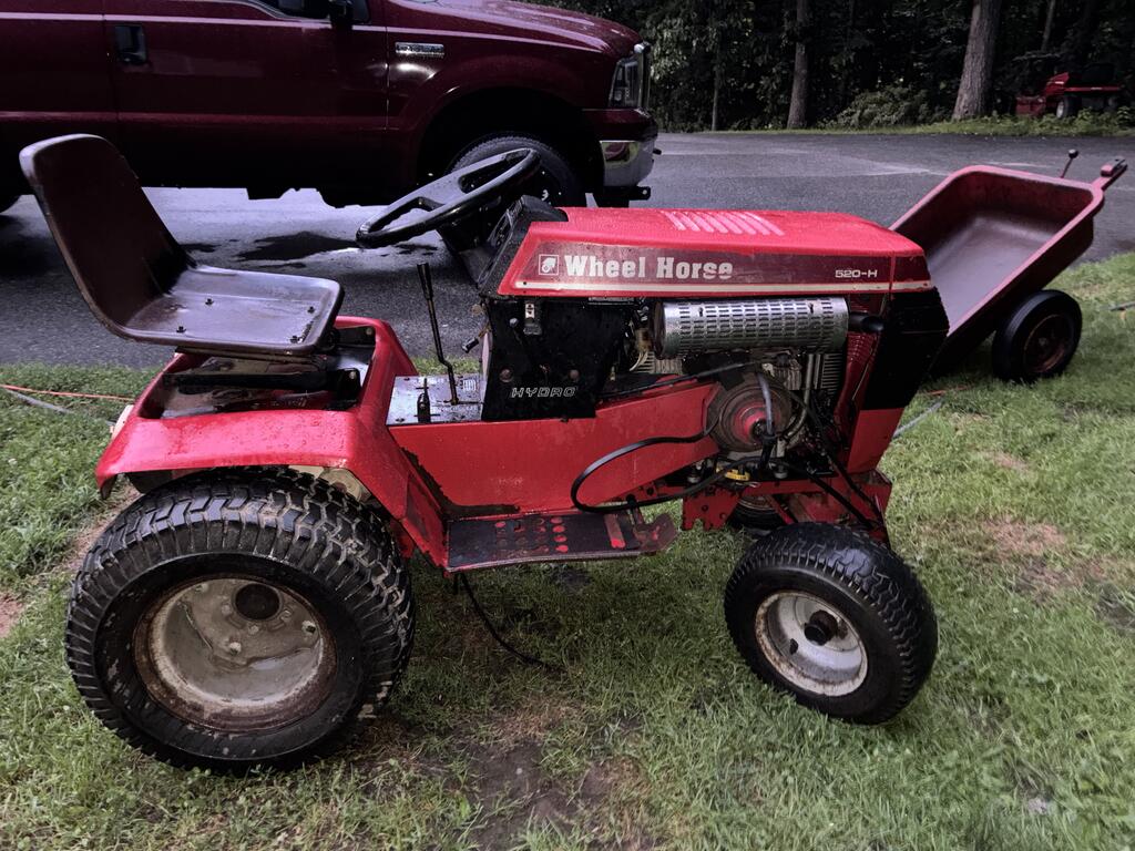

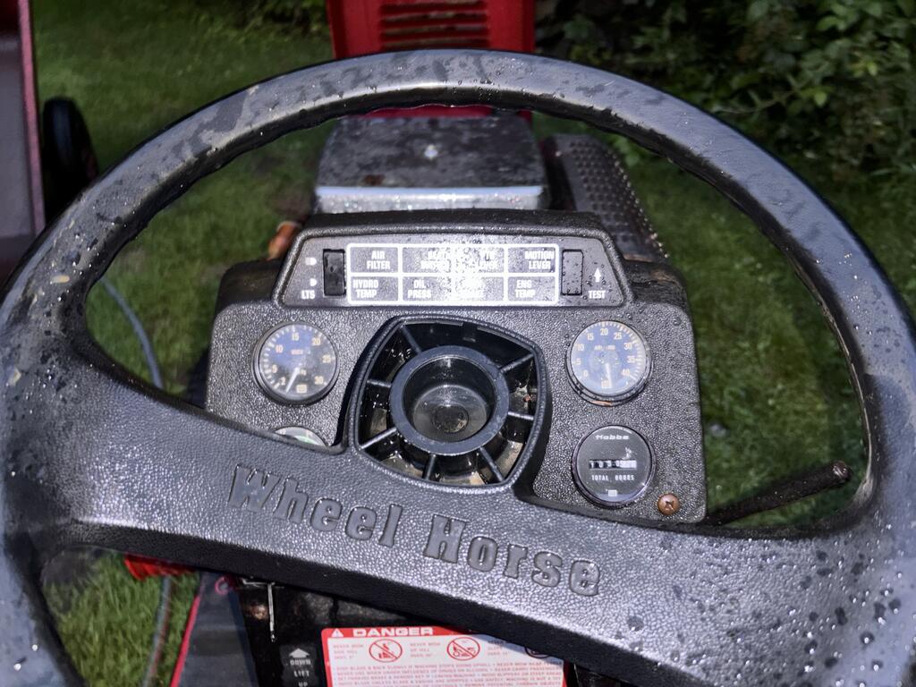

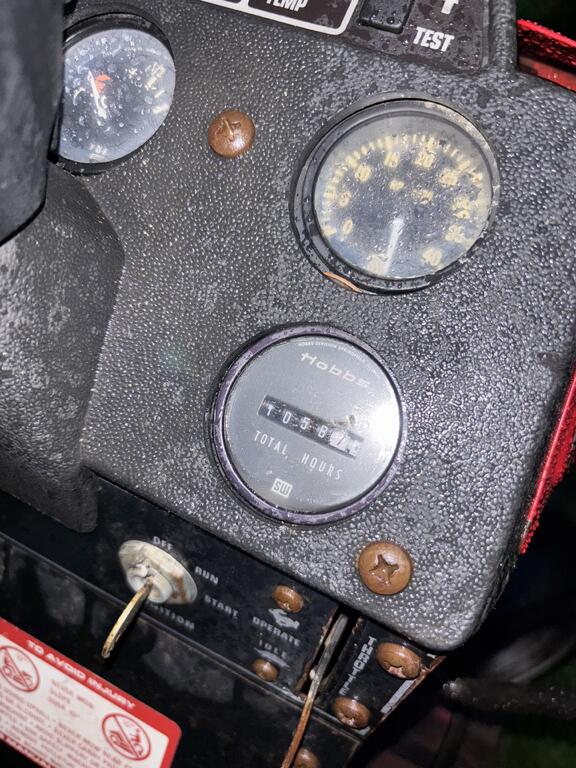

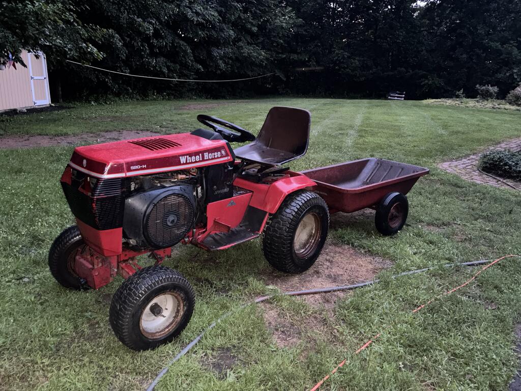

TonyToro Jr. 2,539 #16 Posted July 4, 2025 Now here’s some pictures. WARNING: PICTURE HEAVY 😂😂 2 1 Share this post Link to post Share on other sites

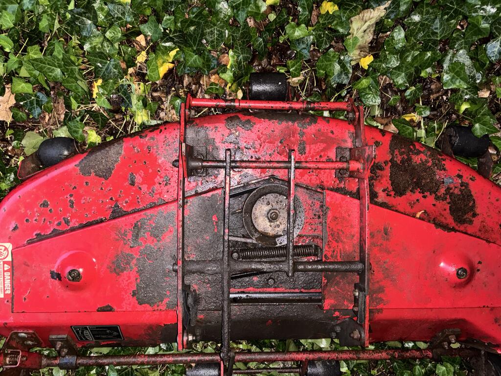

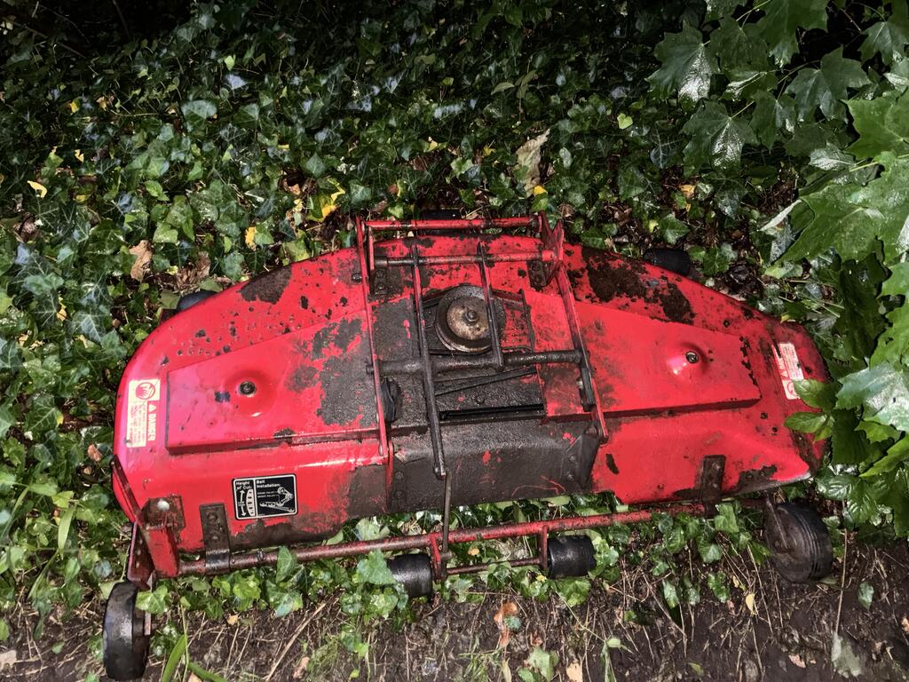

TonyToro Jr. 2,539 #17 Posted July 4, 2025 And here’s the deck: 1 Share this post Link to post Share on other sites

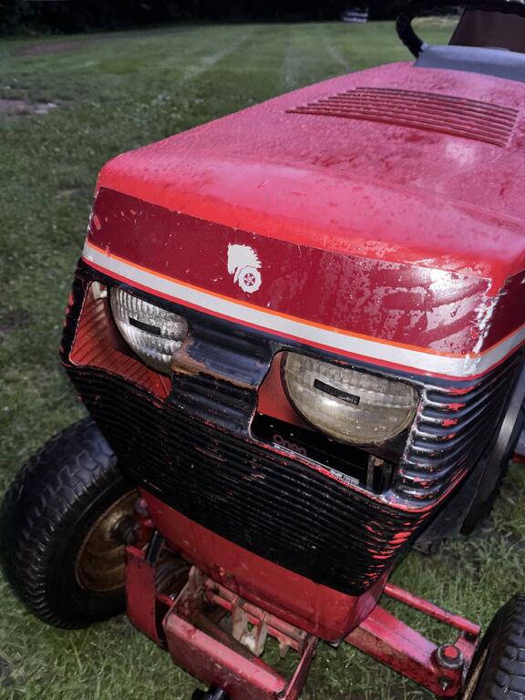

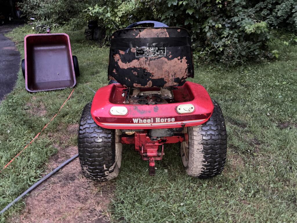

TonyToro Jr. 2,539 #18 Posted July 4, 2025 And shes already ready for the shows! 2 Share this post Link to post Share on other sites
WHX?? 58,143 #20 Posted July 4, 2025 Run & drives then? What was the spark issue? 1 Share this post Link to post Share on other sites
TonyToro Jr. 2,539 #21 Posted July 4, 2025 8 minutes ago, WHX?? said: Run & drives then? What was the spark issue? Nope not yet. She just wanted to see how she looked with a tub cart 😂😂 tommorow I may look into her a bit more. If not then definitely Saturday. 1 Share this post Link to post Share on other sites

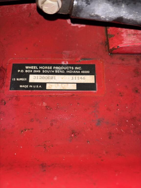

TonyToro Jr. 2,539 #22 Posted July 4, 2025 20 minutes ago, Chaz54 said: A 1988. How could you tell? Just with the model number or changes with the tractor? 1 Share this post Link to post Share on other sites
Sparky-(Admin) 26,362 #23 Posted July 4, 2025 59 minutes ago, TonyToro Jr. said: How could you tell? Just with the model number or changes with the tractor? Model number tells all: 31-20OE01 1988 520-H Garden Tractor Automatic OnanP220G-I/10540A 1 1 Share this post Link to post Share on other sites

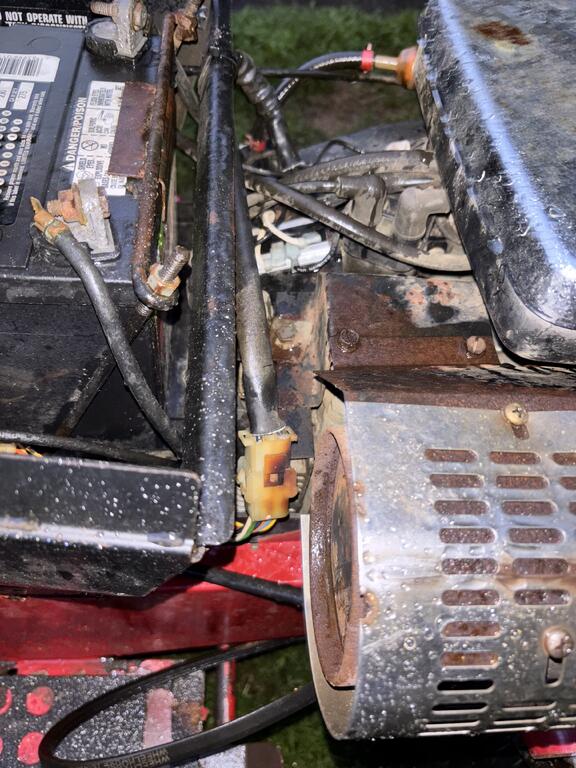

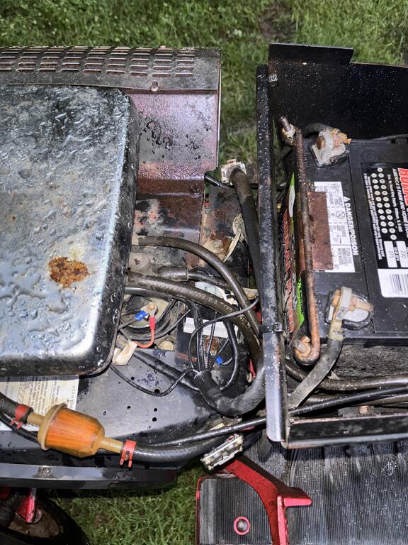

Sparky-(Admin) 26,362 #24 Posted July 4, 2025 Your 9 pin connector looks like it’s toasted. That’ll need to be added to your list of things to address. 1 Share this post Link to post Share on other sites
