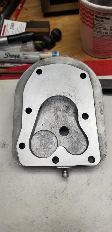

gt14rider 1,278 #1 Posted June 20, 2025 Morning all, I've been working on the 856 and would appreciate your thoughts on this head. These spots just don't want to disappear, first sandpaper grit was 180, worked for a while and this mark's don't want to clean up. Should I keep going? 0.001 feeler gauge won't go under the head. Thanks 1 Share this post Link to post Share on other sites
ebinmaine 80,279 #2 Posted June 20, 2025 18 minutes ago, gt14rider said: Should I keep going? 0.001 feeler gauge won't go under the head. Manual might say something like .003 or less? I don't see why you shouldn't be able to just run that on some 400 paper for a little while and smooth it out. Then reinstall. 1 1 Share this post Link to post Share on other sites
oliver2-44 11,694 #3 Posted June 20, 2025 Some you been sanding awhile, that spot had a little depth. Yes manual says .003 feeler gage. You have a lot of good smooth contact area around it. If a .001 won't go under it I’d would run it. 1 1 Share this post Link to post Share on other sites
8ntruck 9,216 #4 Posted June 20, 2025 Looks to me like that head casting has a bit of porosity. It might not sand out. I'll agree with the others - probably good to run. If it were mine, I'd use a new head gasket. Might think about using Copper Coat on the gasket as well 3 Share this post Link to post Share on other sites
ebinmaine 80,279 #5 Posted June 20, 2025 5 minutes ago, 8ntruck said: Copper Coat Not sure I've ever done that on any of my own but I thought about it several times. Then I forgot about it. Maybe a good idea here. 1 Share this post Link to post Share on other sites
gt14rider 1,278 #6 Posted June 20, 2025 (edited) 1 hour ago, 8ntruck said: Looks to me like that head casting has a bit of porosity. It might not sand out. That's what it looks like, did a little sanding with 500 grit, I'll get a genuine kohler head gasket , should work fine. Thanks for input , waiting on gaskets, every part I've ordered lately is taking 2-3 weeks, still don't have the tires yet,. Well it gives me time to brake something else, Can't feal those mark's with my fingernail. Edited June 20, 2025 by gt14rider Share this post Link to post Share on other sites
