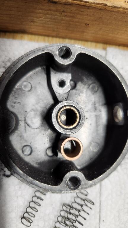

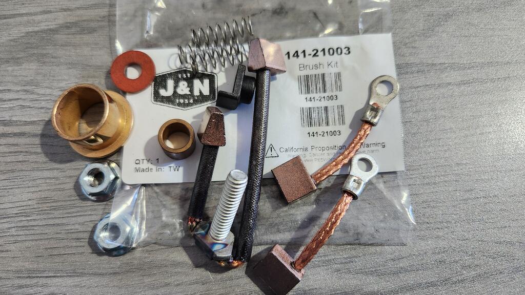

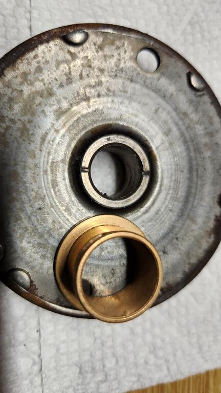

Racinbob 13,210 #10 Posted June 20, 2025 On the starter subject, I want to rebuild the original as a spare. Every kit I've found has the wrong bushing for one of the ends. I want to remove the old bushing for a better measurement but it's been at the bottom of the priority list. Has anybody found a kit with the correct bushing? 1 Share this post Link to post Share on other sites
oliver2-44 11,767 #11 Posted June 20, 2025 I’ve used the kit you show. I’ve found that far end bushing has very little wear, so I’ve not replaced it on several future project ones I’ve rebuilt. 3 Share this post Link to post Share on other sites
Racinbob 13,210 #12 Posted June 20, 2025 3 minutes ago, oliver2-44 said: I’ve used the kit you show. I’ve found that far end bushing has very little wear, so I’ve not replaced it on several future project ones I’ve rebuilt. What do you think about drilling a small hole to allow some lube now and then? 1 Share this post Link to post Share on other sites
ebinmaine 80,881 #13 Posted June 20, 2025 2 hours ago, Racinbob said: On the starter subject, I want to rebuild the original as a spare. Every kit I've found has the wrong bushing for one of the ends. 5 minutes ago, oliver2-44 said: I’ve used the kit you show. I’ve found that far end bushing has very little wear, so I’ve not replaced it on several future project ones I’ve rebuilt. Same & same. I did one on Cinnamon Horse (??) Years ago. Been fine. Share this post Link to post Share on other sites
ebinmaine 80,881 #14 Posted June 20, 2025 1 minute ago, Racinbob said: What do you think about drilling a small hole to allow some lube now and then? Could go either way on that. Me personally I would leave it alone. 1 Share this post Link to post Share on other sites

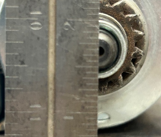

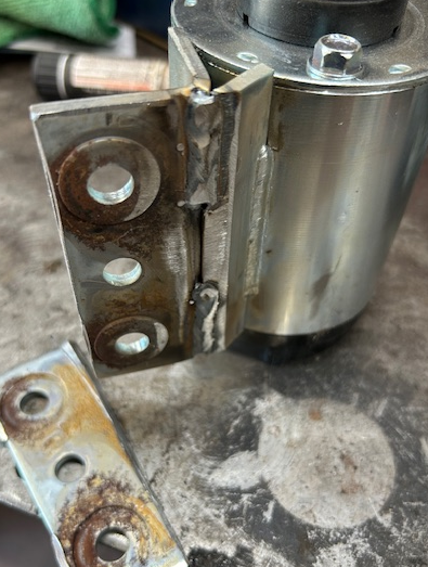

JoeM 10,316 #21 Posted June 27, 2025 Talked with @Ed Kennell about the starter issue at the show. After confirming the problem of being about an 1/8" too far away, we thought we could remove the double plate. I measured the old starter clamping it to the table and it was 1 3/4" to the center of the shaft. The new one was just over 1 7/8" to the center. After slicing the outer plate the new one was just under 1 3/4". That would allow the starter to be shimmed out to the correct engagement. First thought was to remove the outer plate completely. I think it would have held up just fine but opted to slice and weld. The original problem with the old starter was the gear. it was stripped internal and would not spin the engine. We did remove the gear from the new one and placed it on the old. One issue is the new gear kits are just about as expensive as a aftermarket starter. 1 1 Share this post Link to post Share on other sites
