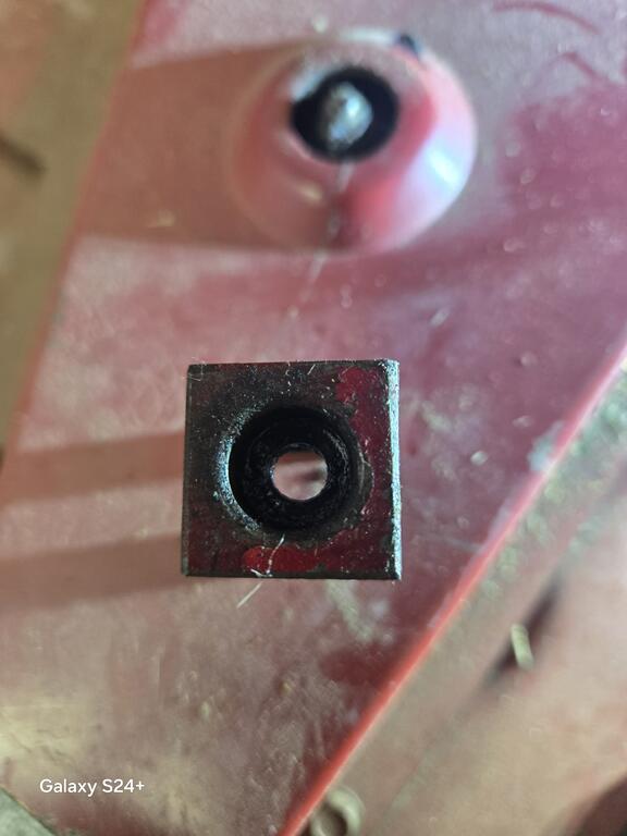

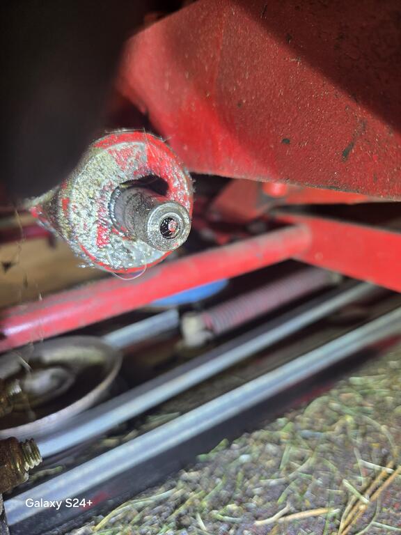

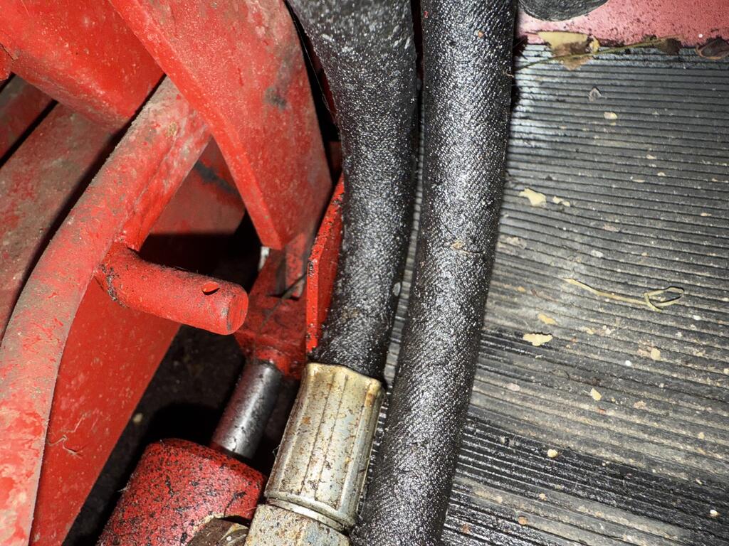

indywheelhorsenut 63 #1 Posted June 9, 2025 Guys... a bit of a challenge here.. I hauled my '74 C160 from Indiana to my new summer home in Black Hills near Mt. Rushmore, (you would have been amazed at the reactions of people along the interstate to the tractor during that trip). Anyway, I left ALL my spare parts and manuals back in Indiana and I just had the deck come disengaged from the hydraulic lift. Looked all over acreage for the missing parts but no luck. The end of the cylinder is no longer connected to anything and I just need a pic, parts list or schematic to figure out what I need.. then onto ebay or whatever for the solution... If you could help I would certainly appreciate it. Share this post Link to post Share on other sites

pfrederi 21,043 #7 Posted June 9, 2025 I had the coupler at the end of the cylinder fall off on one of my Sunstrand Chargers...the coupler is threaded on and apparently the cylinder shaft can rotate and eventually unscrews it self. That was quite a surprise ...have to keep and eye on her make sure I do not see threads. Share this post Link to post Share on other sites

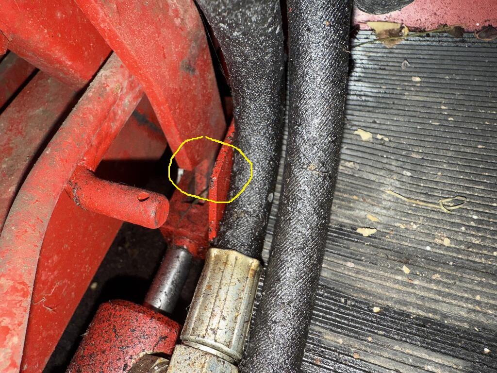

squonk 47,886 #8 Posted June 9, 2025 There is a pin and hitch pin on the coupler that secures it to the rock shaft arm. Share this post Link to post Share on other sites
nylyon-(Admin) 9,040 #9 Posted June 9, 2025 Right, so to lose the part it would have to come off the rock shaft AND the cylinder piston. Share this post Link to post Share on other sites
ineedanother 2,801 #10 Posted June 9, 2025 Great points @nylyon and @squonk. The clevis should be hanging on the rock shaft. It's still beyond me how it cam off of the cylinder shaft though... Share this post Link to post Share on other sites
indywheelhorsenut 63 #11 Posted June 10, 2025 (edited) Will post some pictures of what I found after Nylon sent me picture of his cylinder. Yes. The coupler at end of my hydraulic cylinder is threaded on. Can't figure out how it came off, (second time now) but replaced bolt and added some locktight. It's on and operating. Edited June 10, 2025 by indywheelhorsenut 1 Share this post Link to post Share on other sites
pfrederi 21,043 #12 Posted June 10, 2025 As I said in a similar post one of mine unscrewed it self apparently the piston and shaft can rotate within the cylinder... 1 Share this post Link to post Share on other sites
