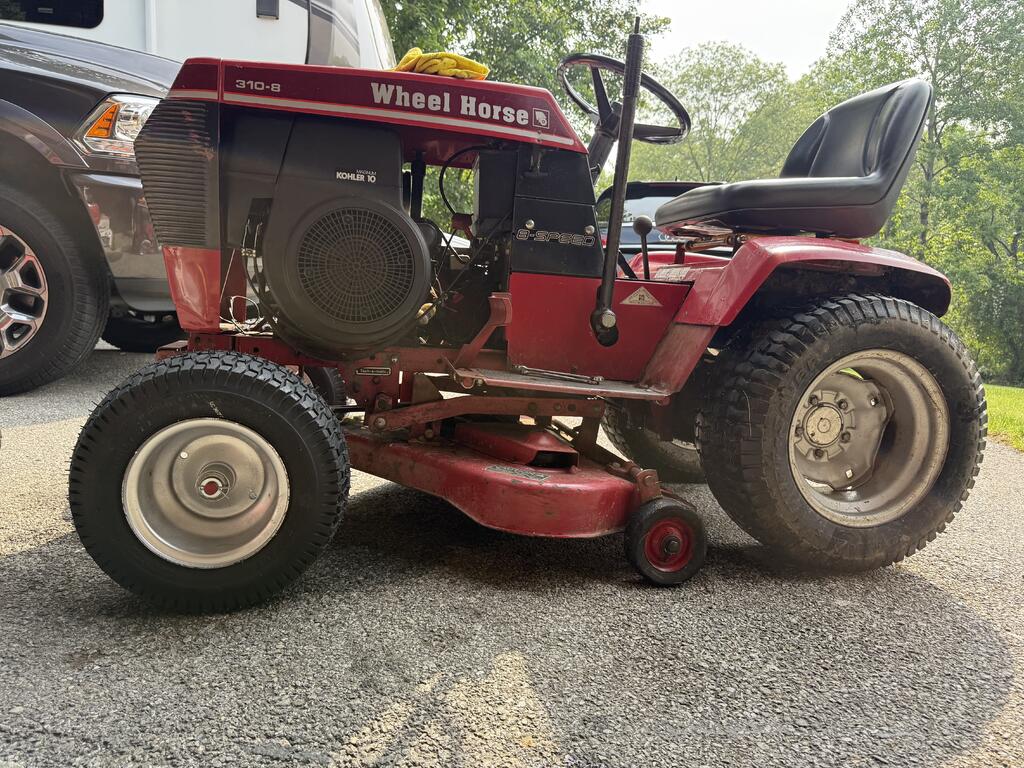

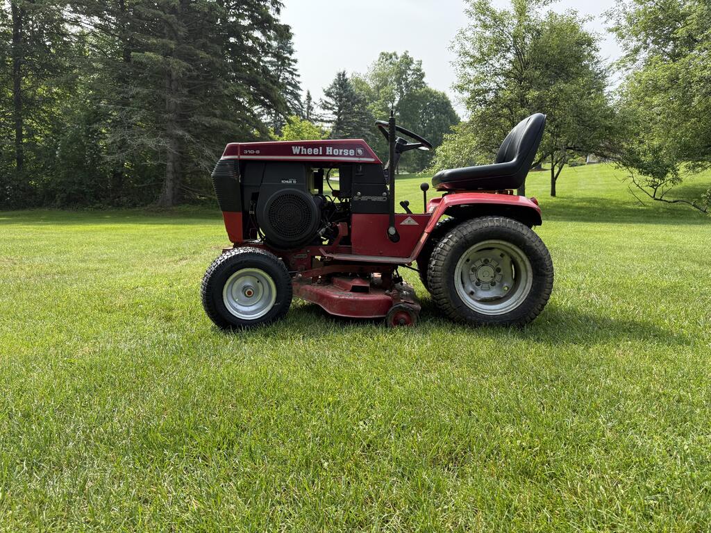

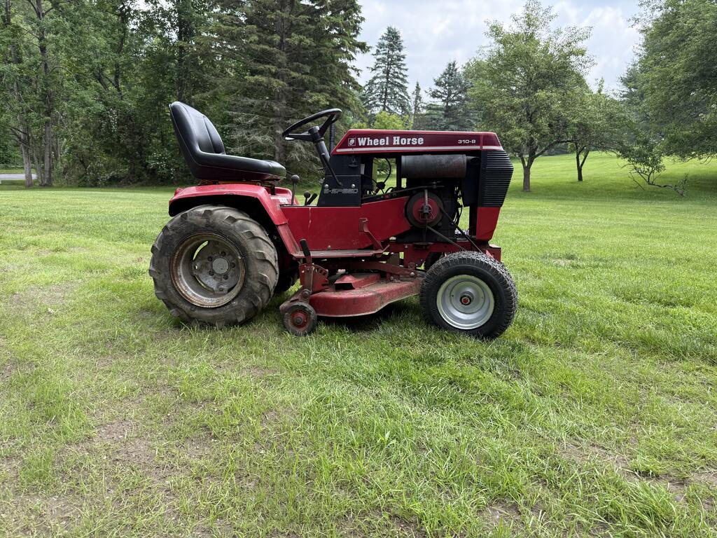

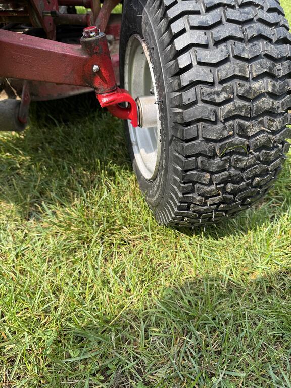

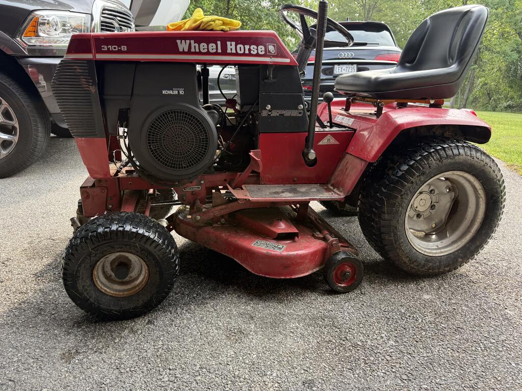

nylyon-(Admin) 9,039 #1 Posted June 8, 2025 Install of the new tires and HD wheels and Spindles is complete. I bought the 310-8 from @Sparky for my daughter when she gets her house. Like all 310’s it came with 6” rims which made it look like a little tractor. I put a wanted ad in and received a response from @grinchsr and @ebinmaine for spindles and rims. Eric only had a set of HD spindles with rims and was gracious enough to send them down to me. Taking advantage of the deal @RED-Z06 found on the 8” tires, I was able to complete the new front for the 310-8, looks more proper now I think. Thank you to all of you for your help with this! Now I just need the HD hub caps! 10 4 Share this post Link to post Share on other sites
nylyon-(Admin) 9,039 #2 Posted June 8, 2025 Oh, and with the HD spindles, I was able to use thrust bearings for easier turning (actually I don’t notice any difference, but it has bearings there now). 4 Share this post Link to post Share on other sites
RED-Z06 2,718 #3 Posted June 8, 2025 Those HD spindles look sharp. Is anyone reproducing them? 2 Share this post Link to post Share on other sites

Sparky-(Admin) 26,185 #5 Posted June 8, 2025 That’s a great upgrade! Agree about the 6” fronts looking lousy on a full size GT 4 Share this post Link to post Share on other sites

Sodaking27 1,318 #7 Posted June 8, 2025 (edited) Looks great. Are those the HD rims that take the 3/4 x 1/2 x 1 3/4 bearing? If so these work great for dust caps from the jungle site. Edited June 8, 2025 by Sodaking27 3 Share this post Link to post Share on other sites

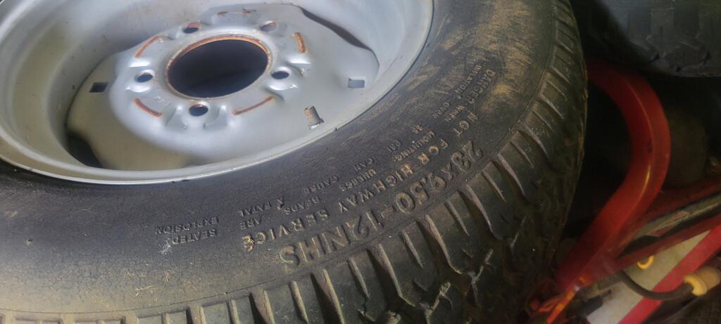

nylyon-(Admin) 9,039 #10 Posted June 8, 2025 26 minutes ago, RED-Z06 said: You could go to a 23" and even out the rake difference from the 15s to the 16s up front Geez didn’t realize they were 22’s, fixed now 1 1 Share this post Link to post Share on other sites
RED-Z06 2,718 #11 Posted June 8, 2025 4 minutes ago, nylyon said: Geez didn’t realize they were 22’s, fixed now Never understood the WH fascination with the 22 when the 23 has been the medium GT standard size forever. 24x12x12 will clear height wise but its close to the tank width wise, spacer clears it all. 2 Share this post Link to post Share on other sites
nylyon-(Admin) 9,039 #12 Posted June 8, 2025 Interesting, I checked my other 310-8 (which I had put 8” wheels and tires on a couple years ago) it already had 23’s on the back, guess that’s why I assumed this one had 23’s. 1 Share this post Link to post Share on other sites
RED-Z06 2,718 #13 Posted June 8, 2025 (edited) 19 minutes ago, nylyon said: Interesting, I checked my other 310-8 (which I had put 8” wheels and tires on a couple years ago) it already had 23’s on the back, guess that’s why I assumed this one had 23’s. My 416-H books with 23x9.50s but it had 22s on it new..and i worked for the original dealer that sold it. it was the awful Deka tires with the round profile, same style as was on the last 315 classic. Edited June 8, 2025 by RED-Z06 Share this post Link to post Share on other sites
RED-Z06 2,718 #14 Posted June 8, 2025 Ill eat those words. My 416 had 23s on it, just seemed smaller like 22s, hated those tires. 2 Share this post Link to post Share on other sites

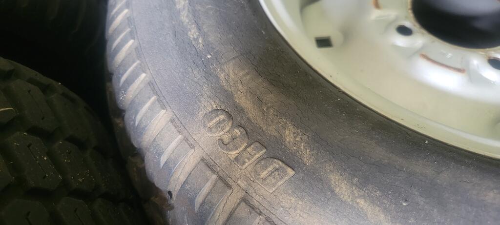

nylyon-(Admin) 9,039 #15 Posted June 8, 2025 I actually like the Dico R/S tire, but they haven’t made them in 9.50 for years. 2 Share this post Link to post Share on other sites
Sparky-(Admin) 26,185 #16 Posted June 8, 2025 1 hour ago, nylyon said: Interesting, I checked my other 310-8 (which I had put 8” wheels and tires on a couple years ago) it already had 23’s on the back, guess that’s why I assumed this one had 23’s. They were 22’s?? Huh, I didn’t realize that. 1 Share this post Link to post Share on other sites
nylyon-(Admin) 9,039 #17 Posted June 8, 2025 Yep, they were 22’s on the back 2 Share this post Link to post Share on other sites
John2189 599 #18 Posted June 8, 2025 6 hours ago, nylyon said: Install of the new tires and HD wheels and Spindles is complete. I bought the 310-8 from @Sparky for my daughter when she gets her house. Like all 310’s it came with 6” rims which made it look like a little tractor. I put a wanted ad in and received a response from @grinchsr and @ebinmaine for spindles and rims. Eric only had a set of HD spindles with rims and was gracious enough to send them down to me. Taking advantage of the deal @RED-Z06 found on the 8” tires, I was able to complete the new front for the 310-8, looks more proper now I think. Thank you to all of you for your help with this! Now I just need the HD hub caps! Just curious, So does putting bigger tires on the front, change the way the mower cuts? Wouldn’t that make the front of the deck higher than the rear? 2 Share this post Link to post Share on other sites
nylyon-(Admin) 9,039 #19 Posted June 8, 2025 20 minutes ago, John2189 said: Just curious, So does putting bigger tires on the front, change the way the mower cuts? Wouldn’t that make the front of the deck higher than the rear? The spindles for the 6” tires are longer than those for the 8”, so when changing the wheels from 6” to 8”, need to change to the 8” spindle to keep the height the same. RED-Z06 also pointed out that the 310 had 22” rear tires, where the others have 23”. So in effect, changing the 6” to 8” front wheels and spindles and 22” to 23” tall rear tires it is the same as tractors such as the 416. 4 Share this post Link to post Share on other sites
RED-Z06 2,718 #20 Posted June 8, 2025 28 minutes ago, John2189 said: Just curious, So does putting bigger tires on the front, change the way the mower cuts? Wouldn’t that make the front of the deck higher than the rear? About a half inch, but going from a 22 to a 23 rear evens it out 2 Share this post Link to post Share on other sites
John2189 599 #21 Posted June 8, 2025 6 minutes ago, nylyon said: The spindles for the 6” tires are longer than those for the 8”, so when changing the wheels from 6” to 8”, need to change to the 8” spindle to keep the height the same. RED-Z06 also pointed out that the 310 had 22” rear tires, where the others have 23”. So in effect, changing the 6” to 8” front wheels and spindles and 22” to 23” tall rear tires it is the same as tractors such as the 416. Ok didn’t know the spindles were different Share this post Link to post Share on other sites
nylyon-(Admin) 9,039 #22 Posted June 9, 2025 For some reason, the AG’s aren’t doing it for me on this machine so I just ordered up a set of matching Carlisle Turf Saver 23x9.50-12 rear tires, and mount them on the rims the 22’s were on. Should even out the look a little bit, and be gentler on the lawn. 3 1 Share this post Link to post Share on other sites
ebinmaine 80,084 #23 Posted June 9, 2025 4 hours ago, John2189 said: Ok didn’t know the spindles were different It's that difference in height that makes the 6" spindles advantageous to me. They're an inch taller. That inch doesn't seem like much but it helps with forest floor clearance on our rough terrain. 2 Share this post Link to post Share on other sites

kpinnc 18,853 #25 Posted June 9, 2025 23 hours ago, nylyon said: I actually like the Dico R/S tire, but they haven’t made them in 9.50 for years. 10.50 turfs will fit those wheels easily with no issues for the mower decks. I ran them on my 310-8 and a 37 SD deck for years. Share this post Link to post Share on other sites
