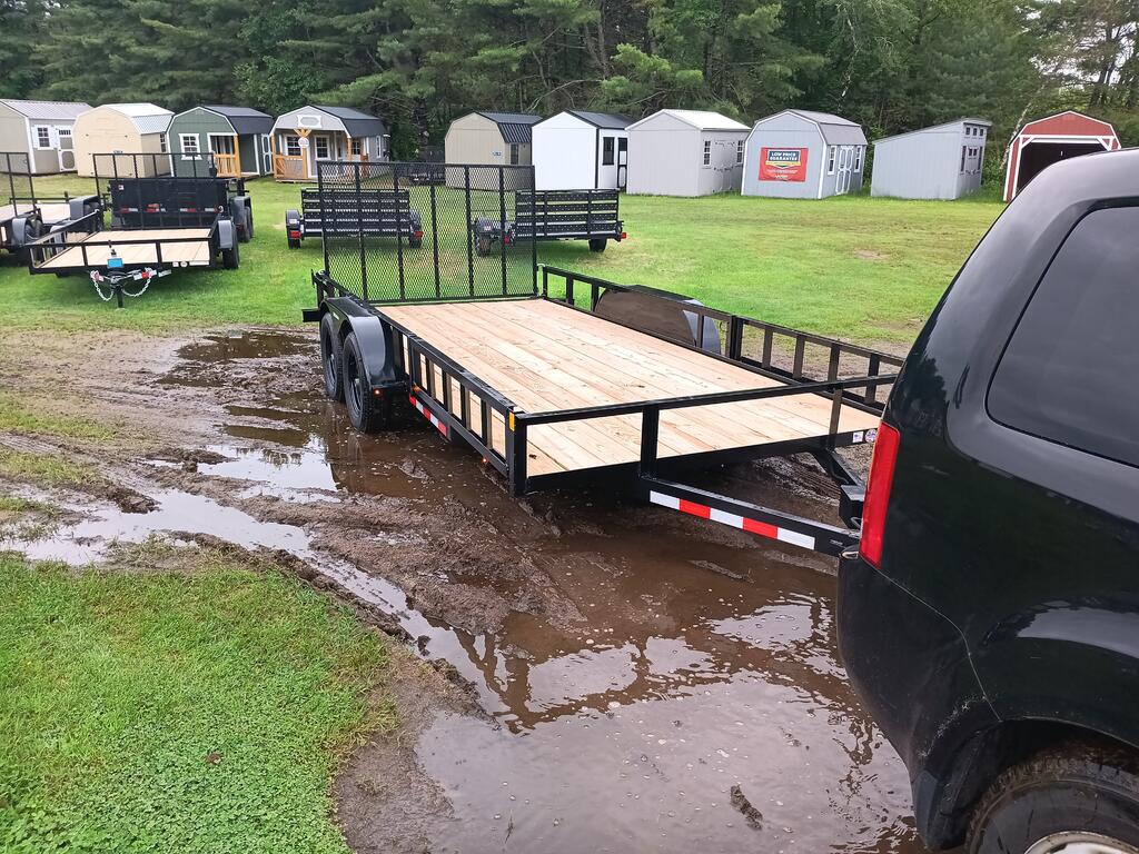

ebinmaine 80,461 #20 Posted June 7, 2025 On 6/5/2025 at 9:59 AM, ebinmaine said: the 16 ft length of this trailer: https://lakeregiontrailersme.com/atv/ BOUGHT! 6 2 Share this post Link to post Share on other sites

Sparky-(Admin) 26,263 #22 Posted June 7, 2025 First tow is right thru the mud! Breaking it right in…. Congrats! 3 Share this post Link to post Share on other sites
MainelyWheelhorse 3,079 #23 Posted June 7, 2025 (edited) @ebinmaine Cool, looks like plenty of room for tractors too. Edited June 7, 2025 by MainelyWheelhorse 1 Share this post Link to post Share on other sites

ebinmaine 80,461 #25 Posted June 7, 2025 FYI: This particular trailer has a 5500 lb GVW. Payload is around 3800 lbs. That works out perfect for someone wanting to move tractors and lighter things. Dry weight is approximately 1700. Tows great. Share this post Link to post Share on other sites
