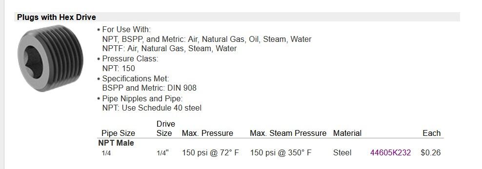

pfrederi 20,823 #12 Posted June 2, 2025 If you are having to use a Torx to get the plug out time to buy a new one a whole $ 0.26 3 Share this post Link to post Share on other sites
