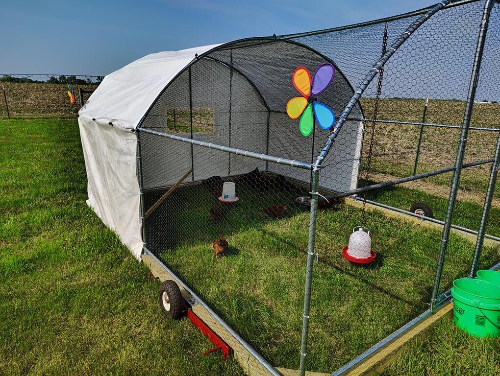

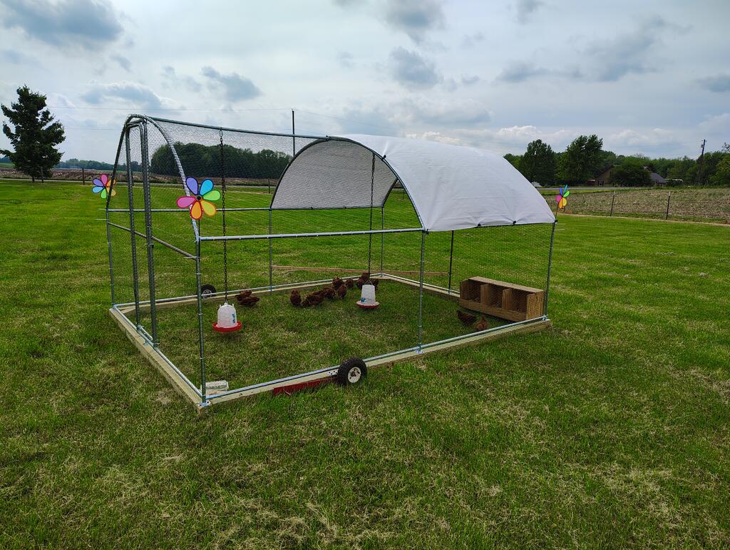

AlexR 3,083 #1 Posted May 29, 2025 (edited) So I have been working on this chicken tractor coop I thought I would share with you guys. The coop is from vevor not sure I can fully recommend it as it's not that great, but it is cheap I paid about $180 for it. However I also bought the 4x4's which were about $70. And couple bushings, bolts, and screws The coop I had to add some additional bracing with some old galvanized water line piping I had pulled out of the house and barn. Cut those to fit and used self tappers to attach those. All the metal I used, I already had laying around, the wheels too. I have not yet attached the "hitch" to the front of the coop yet. The other part goes to the sleeve hitch on the Wheelhorse so that will lift the front. It's all getting painted regal red! I am thinking about enclosing the coop more but have not yet decided if I will used this for the egg laying hens or if I need to build a actual coop and possibly use this for broilers. I had been thinking of building a coop into the bottom of my barn but reconsidering that now, due to dust from the chickens and I have a concrete pad they would be pooping all over. Edited May 29, 2025 by AlexR 11 7 2 Share this post Link to post Share on other sites

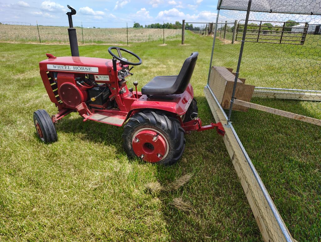

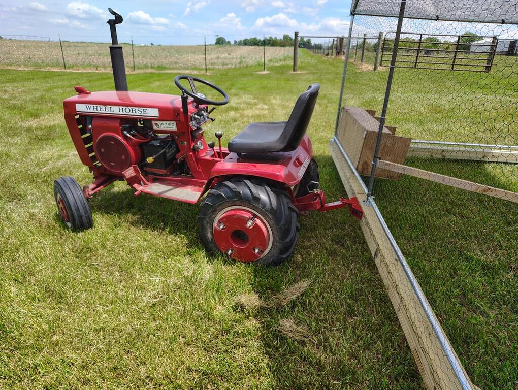

AlexR 3,083 #10 Posted May 30, 2025 Proof of concept. 4 2 Share this post Link to post Share on other sites

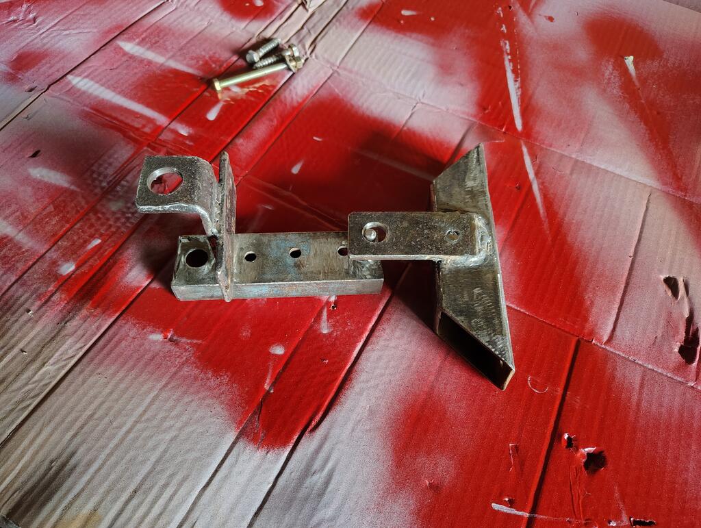

Handy Don 17,382 #11 Posted May 30, 2025 2 hours ago, AlexR said: Proof of concept. The short tongue means no sharp turns, but that may be what you wanted. 1 Share this post Link to post Share on other sites
AlexR 3,083 #12 Posted May 30, 2025 28 minutes ago, Handy Don said: The short tongue means no sharp turns, but that may be what you wanted. You are correct sharp turns are a no go. No it's not what I wanted, it was a compromise. I couldn't make the hitch on the Wheelhorse longer because the high point where the lift lever locks would make it to high, unless I created more bends and drop it a lot lower. And it would make it harder to lift. I didn't want to make the "tongue" on the coop longer because it would stick out a lot more and I didn't really want that, also would cause more of a twisting action on the 4x4 when it's lifted up. 1 Share this post Link to post Share on other sites

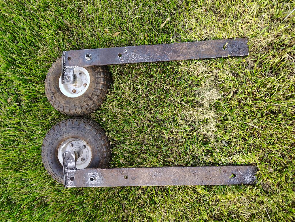

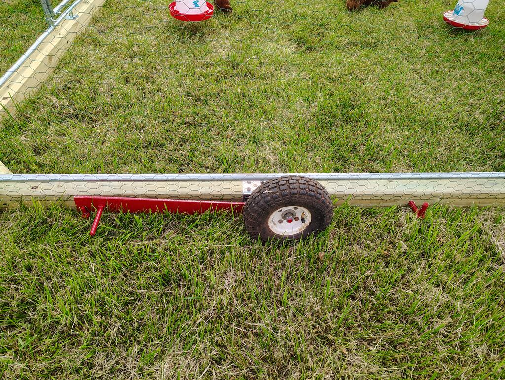

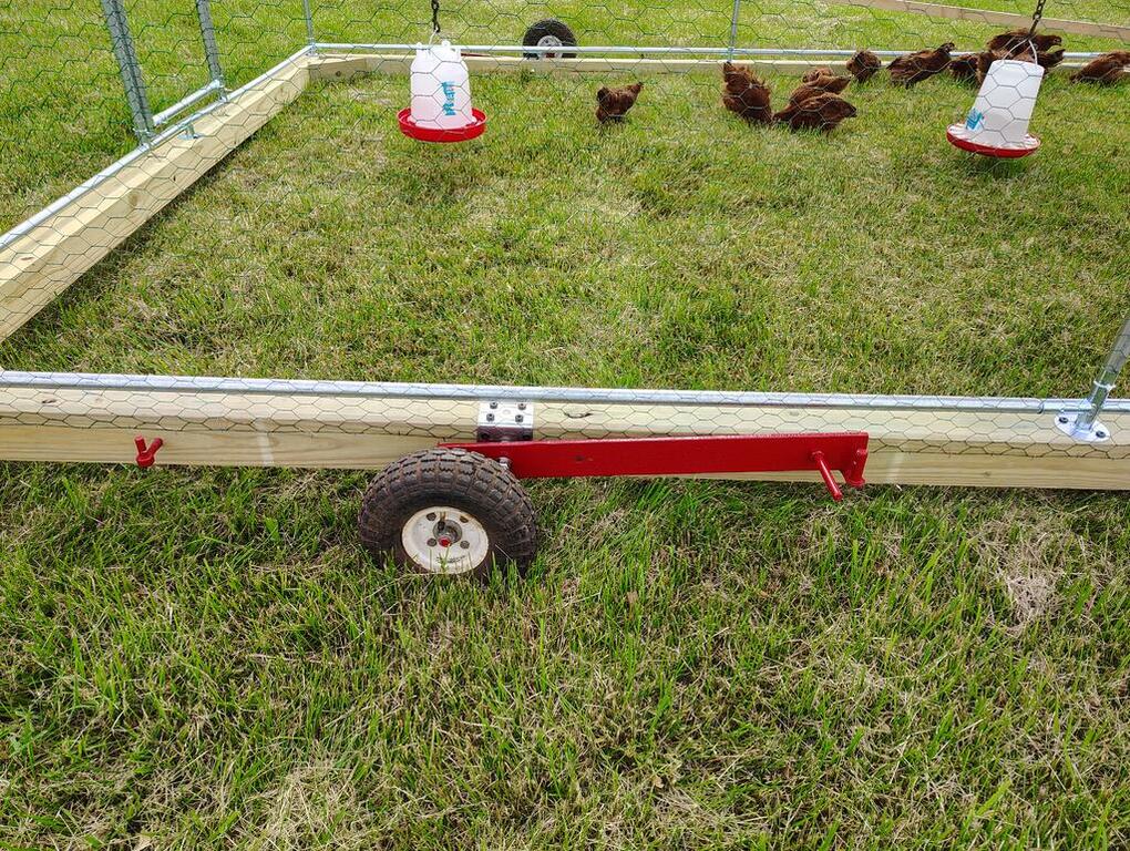

Handy Don 17,382 #13 Posted May 31, 2025 (edited) 3 hours ago, AlexR said: You are correct sharp turns are a no go. No it's not what I wanted, it was a compromise. I couldn't make the hitch on the Wheelhorse longer because the high point where the lift lever locks would make it to high, unless I created more bends and drop it a lot lower. And it would make it harder to lift. I didn't want to make the "tongue" on the coop longer because it would stick out a lot more and I didn't really want that, also would cause more of a twisting action on the 4x4 when it's lifted up. Yeah, compromise.... You did make those nifty wheel lifts for the sides and they got me thinking (uh oh).... A lever that brings a caster wheel down might work here. The lifting force would be upward at the caster’s tire patch so it’d stay close to the 4x4 and lessen the long leverage “twist” risk. Then you’d only need a (long) tow bar from the cage to the tractor (which wouldn’t be providing lift). Another thought was putting 4 of those clever side wheels near the corners and then just towing it and watching it shimmy over the undulating lawn! Edited May 31, 2025 by Handy Don 1 Share this post Link to post Share on other sites
AlexR 3,083 #14 Posted May 31, 2025 2 minutes ago, Handy Don said: A lever that brings a caster wheel down might work here. I actually did have that thought, my Delta table saw has that kind of thing, obviously on a small scale. I think what will determine if I do anything more, is just to use it. And if it ends up being a problem or too annoying to not be able to turn sharp, at that point I can do something about it. 1 1 Share this post Link to post Share on other sites

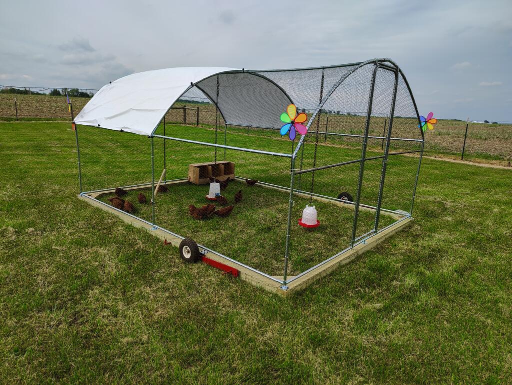

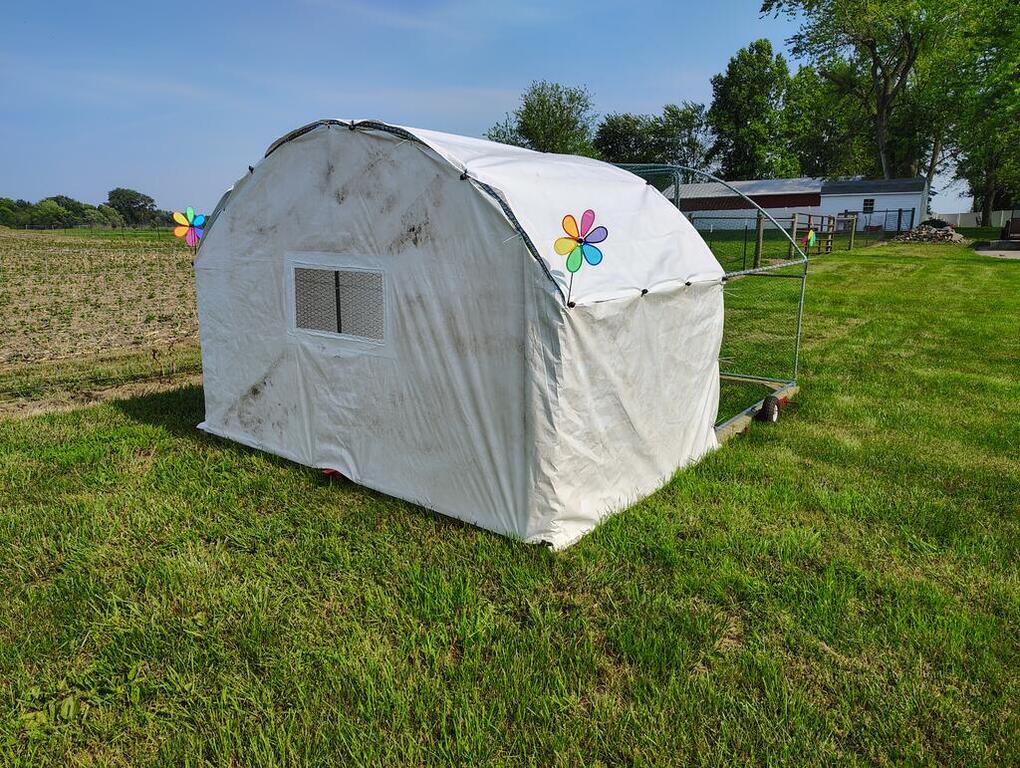

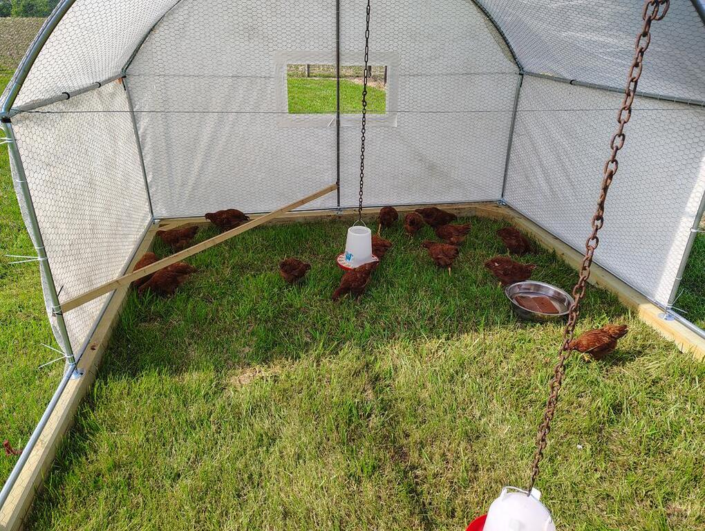

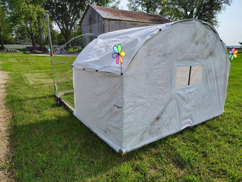

AlexR 3,083 #21 Posted June 11, 2025 Made a couple changes. Didn't feel like they were protected enough in wind storms and rain. So enclosed the back and sides with thick woven plastic. And removed the nesting boxes because they were just pooping in them right now. Don't need to keep that habit up. Going to keep the open side pointed south most of the time 3 Share this post Link to post Share on other sites
Handy Don 17,382 #22 Posted June 11, 2025 1 hour ago, AlexR said: Made a couple changes. Looks good. You might want to have a plan for securing it during a high wind event! 1 Share this post Link to post Share on other sites
Wayne0 1,631 #23 Posted June 11, 2025 So, where are they laying with out the nesting boxes? All over the ground? 1 Share this post Link to post Share on other sites

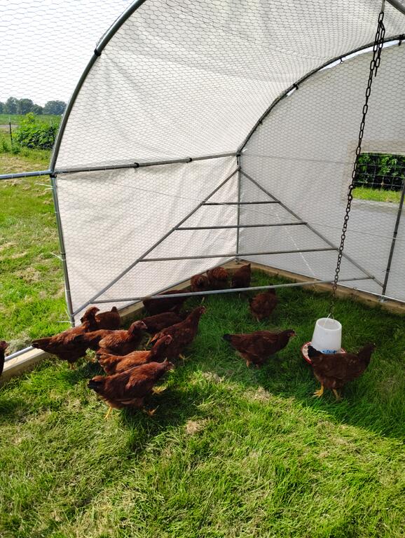

AlexR 3,083 #24 Posted June 11, 2025 9 minutes ago, Handy Don said: Looks good. You might want to have a plan for securing it during a high wind event! If it's a high enough wind to worry about it I will tuck it back behind the barn. 6 minutes ago, Wayne0 said: So, where are they laying with out the nesting boxes? All over the ground? Yes that or they can roost on the board I got up for them. That will be part of the next modification I will add more permanent roosting bars. 1 Share this post Link to post Share on other sites
AlexR 3,083 #25 Posted August 5, 2025 Finally got those roosting bars up. Only thing I had to buy was the self tapping screws all this galvanized pipe was water lines from the barn and house. I am thinking about maybe getting some pipe insulation to put on the pipes and wrapping it tightly with ducktape just to make it easier for the chickens to hold on. 4 Share this post Link to post Share on other sites
