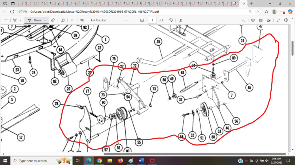

Pullstart 71,561 #2 Posted May 27, 2025 @953 nut do you have any examples of smaller style attach-a-matics being used on 953s or 1054s? Share this post Link to post Share on other sites
953 nut 70,653 #3 Posted May 27, 2025 23 minutes ago, Pullstart said: @953 nut do you have any examples of smaller style attach-a-matics being used on 953s or 1054s? I don't have any pictures of "Hot Wheels" with a mower on it. Just a matter of installing the pre-mule drive (1967 to 1972?) Mid Mount Tach-A-Matic to the frame of the 1054. Another option would be mounting a mule drive at the front and the later mid mount. @Ed Kennell may have all the parts and pieces you will need. Share this post Link to post Share on other sites

953 nut 70,653 #8 Posted May 27, 2025 5 hours ago, squonk said: I think the 953/1054 frames are wider so the std. Mid tach a matic and deck will not work. You mount the plates inside the frame rails. It has been several years since I did it, may have been a spacer involved too. 1 Share this post Link to post Share on other sites
squonk 48,427 #9 Posted May 28, 2025 16 minutes ago, 953 nut said: You mount the plates inside the frame rails. It has been several years since I did it, may have been a spacer involved too. Any drilling involved? I was thinking of mounting a mid hitch on my 953 to use my mid grader. Share this post Link to post Share on other sites

Cjwv1975 117 #12 Posted May 30, 2025 Would a deck off a 1057 work Share this post Link to post Share on other sites
WHX?? 58,388 #13 Posted May 30, 2025 48 minutes ago, Cjwv1975 said: Would a deck off a 1057 work I almost think it would with the parts In Richard's post, some Pullstart fabbing and some newly learned french language. Wouldn't be for lack of trying anyway. Share this post Link to post Share on other sites

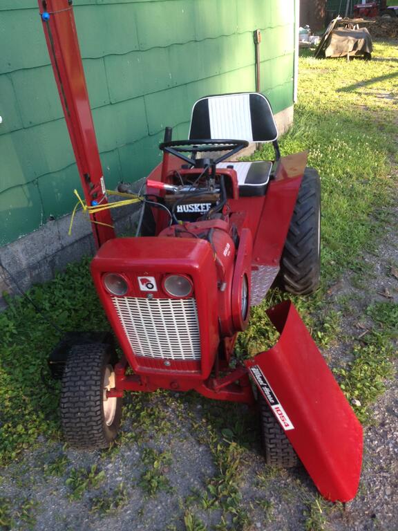

Wvtroutbum81 327 #14 Posted May 31, 2025 On 5/27/2025 at 8:49 AM, Lane Ranger said: I have a couple of good 1054/953 48 Inch Mower decks and related parts I would sell very reasonably to a 1054/953 owner but they are located in Gary, Indiana. Ley me know if untreated. I also have a new old stock blade set to include. These are the original 48 inch mower decks and heavy duty. Man those are some nice tractors 1 Share this post Link to post Share on other sites
WHX?? 58,388 #15 Posted May 31, 2025 11 minutes ago, Wvtroutbum81 said: Man those are some nice tractors Dem ain't nothin you oughta see his thundering herd of round hoods! Share this post Link to post Share on other sites
Wvtroutbum81 327 #16 Posted May 31, 2025 29 minutes ago, WHX?? said: Dem ain't nothin you oughta see his thundering herd of round hoods! Im up for adoption! 1 Share this post Link to post Share on other sites
Lane Ranger 12,167 #17 Posted May 31, 2025 13 hours ago, Wvtroutbum81 said: Man those are some nice tractors The 1054 with 50 inch sickle bar mower is one of the best ! 2 Share this post Link to post Share on other sites
