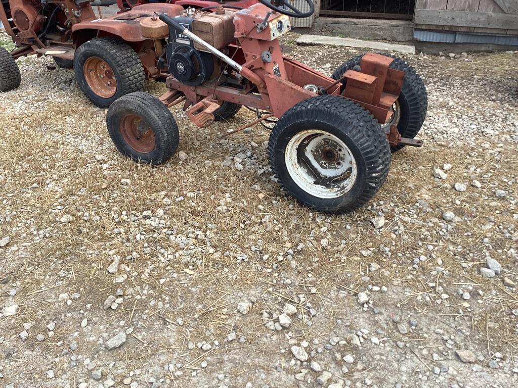

Easton Rich 1,260 #1 Posted May 23, 2025 This is my 653 I just acquired today, yep not much here but just wait. Why did I get it? I don’t really know, but it’s cool and I like round hoods. Follow along as it gets nut and bolt restoration, and I will finally have a trailer queen! Pictures when the rain passes 2 Share this post Link to post Share on other sites

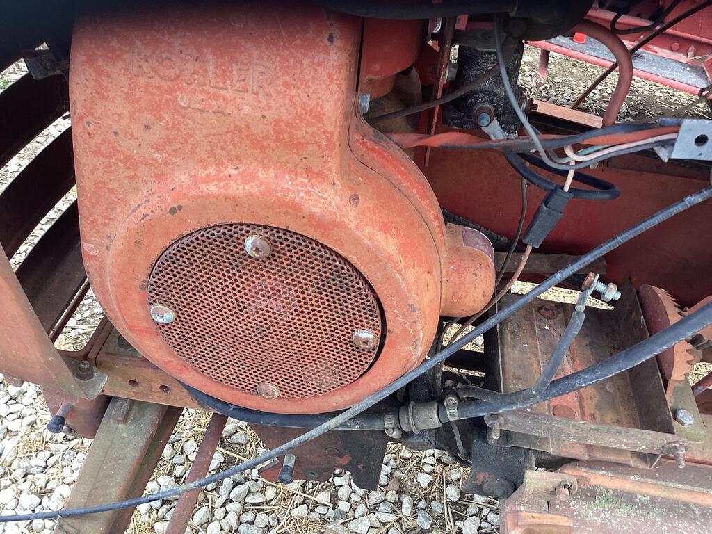

Easton Rich 1,260 #2 Posted May 23, 2025 The motor is a K181 which is going on. As you see it needs fenders and a gas tank, I have a wanted ad in the classifieds so pm me if you’ve got something. This will be a longer build so stick with me! 7 Share this post Link to post Share on other sites

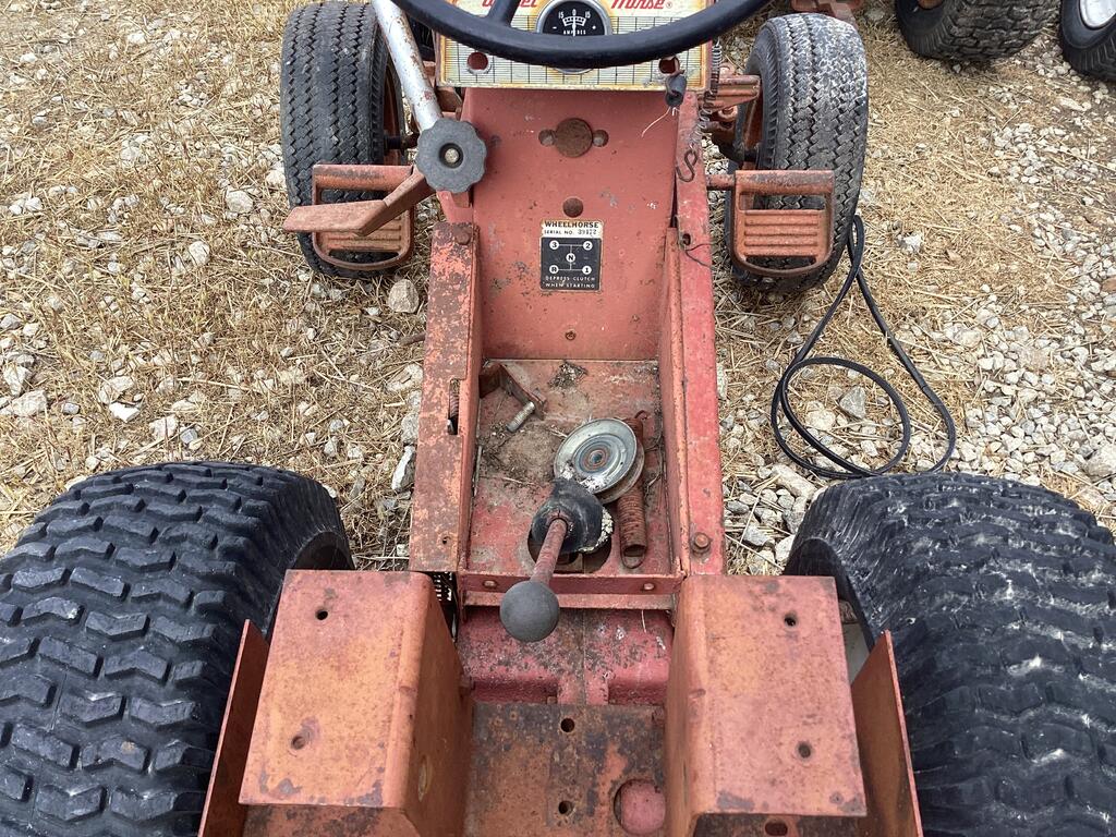

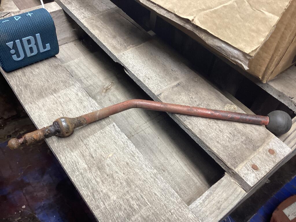

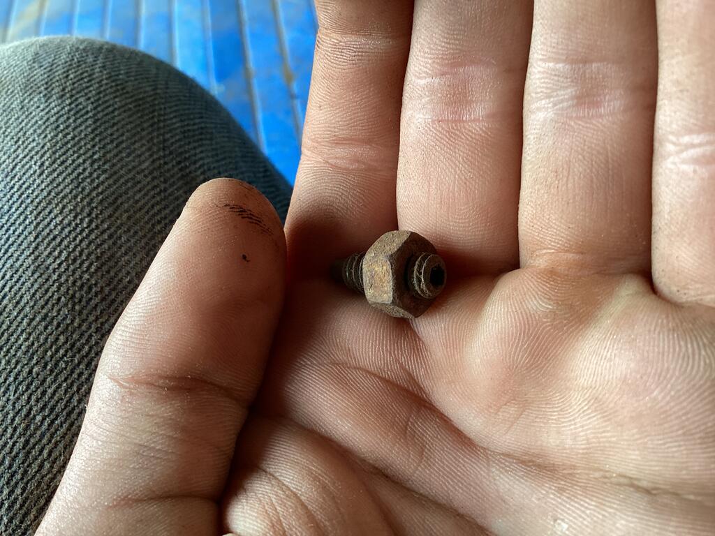

Easton Rich 1,260 #5 Posted May 24, 2025 Weird question, why did my shifter COME OUT when I tried to shift into gear and it turned in a 360? 1 Share this post Link to post Share on other sites

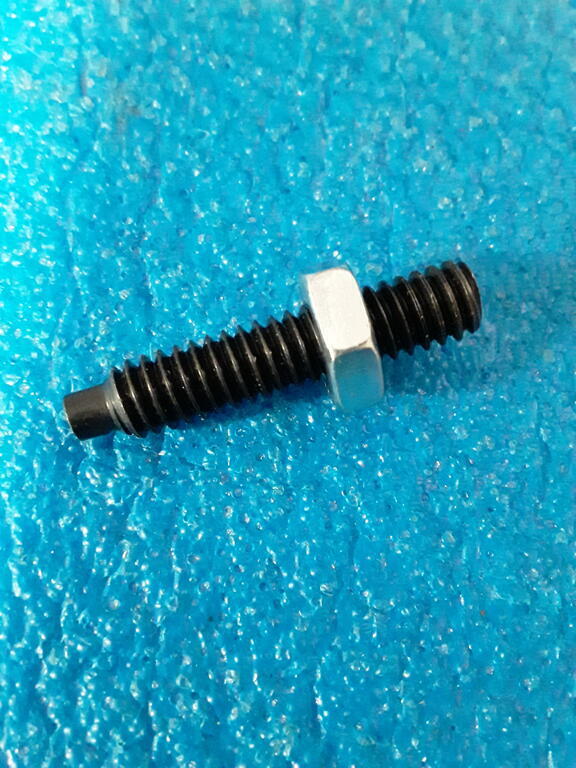

kpinnc 18,968 #6 Posted May 24, 2025 1 hour ago, Easton Rich said: Weird question, why did my shifter COME OUT when I tried to shift into gear and it turned in a 360? Might be missing this little guy. Part number 1239. Screws into the front of the tranny case and the pin goes in that hole in the shifter ball. 3 Share this post Link to post Share on other sites
Easton Rich 1,260 #7 Posted May 24, 2025 I’ll check, I was just messing with it to see if it would go into gear because the rear end is LOCKED UP. Thanks 1 Share this post Link to post Share on other sites
Easton Rich 1,260 #8 Posted May 25, 2025 If any of you have an old round hood with a fuel tank let me know! @Chris G might have me covered for fenders 1 Share this post Link to post Share on other sites
953 nut 69,345 #9 Posted May 25, 2025 19 hours ago, Easton Rich said: I’ll check, I was just messing with it to see if it would go into gear because the rear end is LOCKED UP. Thanks Read this thread. 1 Share this post Link to post Share on other sites
Easton Rich 1,260 #10 Posted May 26, 2025 Yeah, that’s what I’m missing. The stud with the jam nut. Thanks! 1 Share this post Link to post Share on other sites

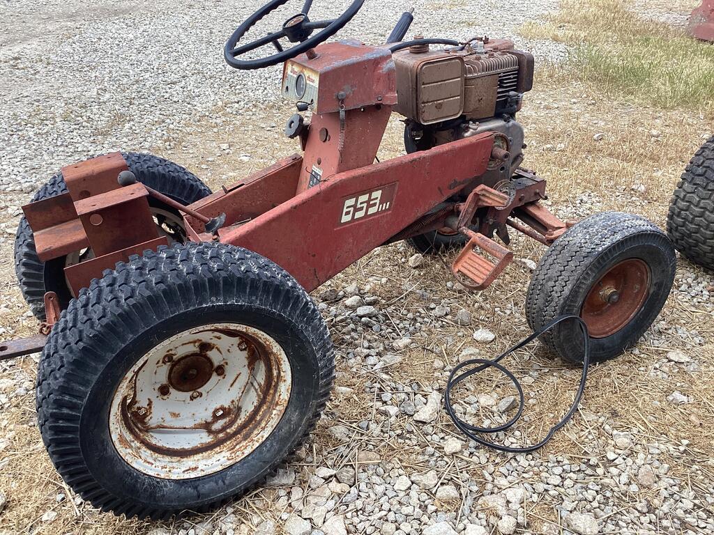

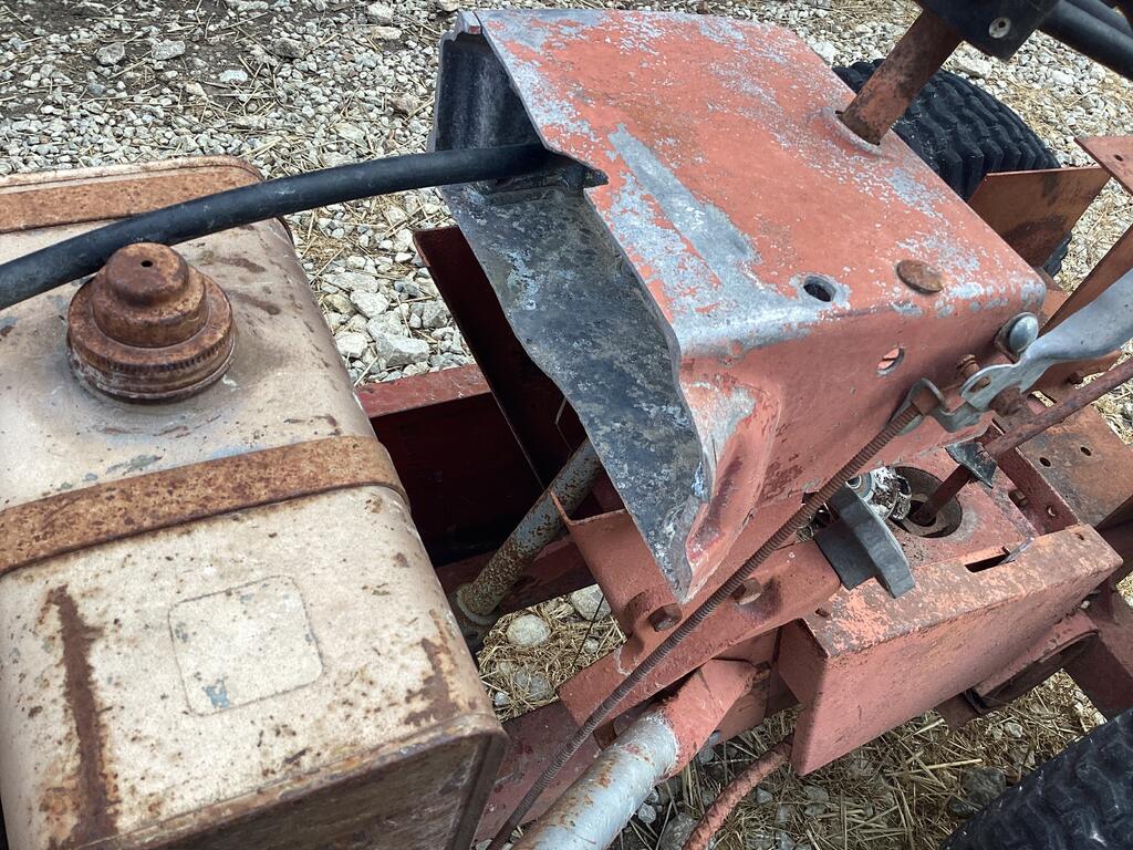

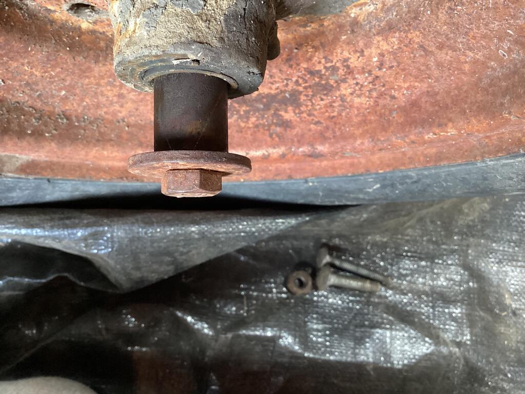

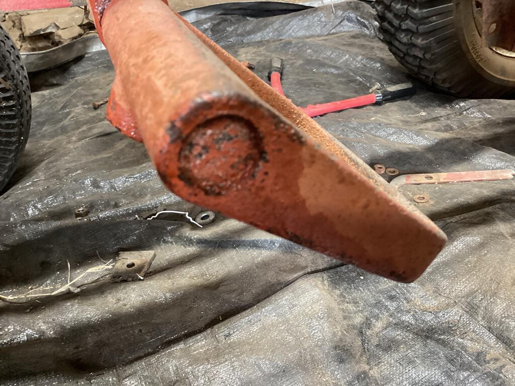

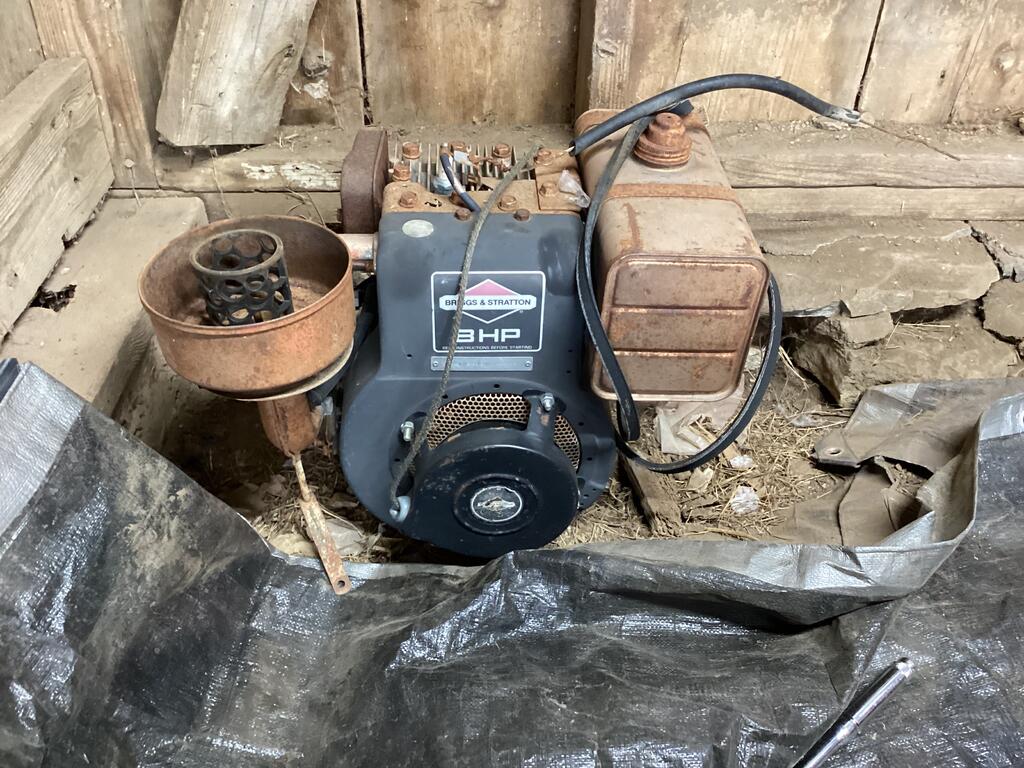

Easton Rich 1,260 #11 Posted June 11, 2025 Well back on this turd now that I got everything running for this season (I hope). Guess what I found in the pile of parts I got with the tractor? That little jam nut! I’ve got that jank start 8hp Briggs off and my cut fuel tank along with my dash tower. Ive got three questions, 1 How long are these spindles supposed to be? 2. What’s the best way to get this steering wheel of the shaft? 3. How do you get these food board off? I know I know you want pictures Share this post Link to post Share on other sites

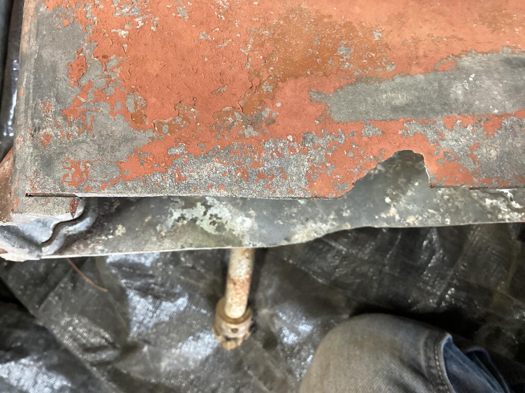

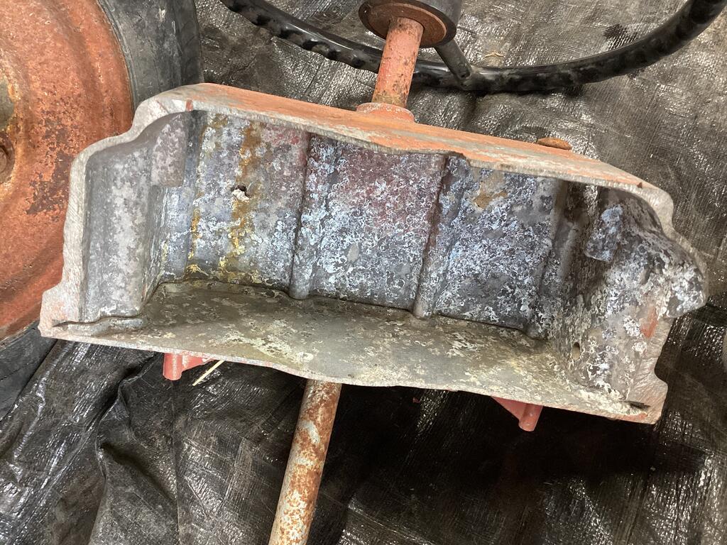

Easton Rich 1,260 #12 Posted June 11, 2025 For those who don’t believe me when I say they cut the fuel tank, I mean they literally chopped the other half. Is this Briggs that came off worthy of fixing? It’s not locked up and it’s complete. If any of you are interested let me know Share this post Link to post Share on other sites

Handy Don 17,474 #17 Posted June 15, 2025 Interesting re-power to the B&S 8 and the sacrifice of the fuel tank! That would have had a Lausen/Tecumseh 6hp electric start when new with the tank sticking out of the rearward part of the hood. Share this post Link to post Share on other sites
Easton Rich 1,260 #18 Posted June 16, 2025 Yes. I still can’t seem to find a tank Share this post Link to post Share on other sites
Handy Don 17,474 #19 Posted June 16, 2025 14 hours ago, Easton Rich said: Yes. I still can’t seem to find a tank There are two flavors of this tank. A one-piece from 61-62 and a two-piece (like the cut one in your picture) from 63-64. The early one needs a separate dashboard and the latter has the dash built in. Clearly, the tank on your 653 was cut to accommodate the shape of that bulky B&S with the attached fuel tank. They are not all that hard to find. Put a “want” in the classifieds and post your interest in the Big Show buy & sell thread. Share this post Link to post Share on other sites

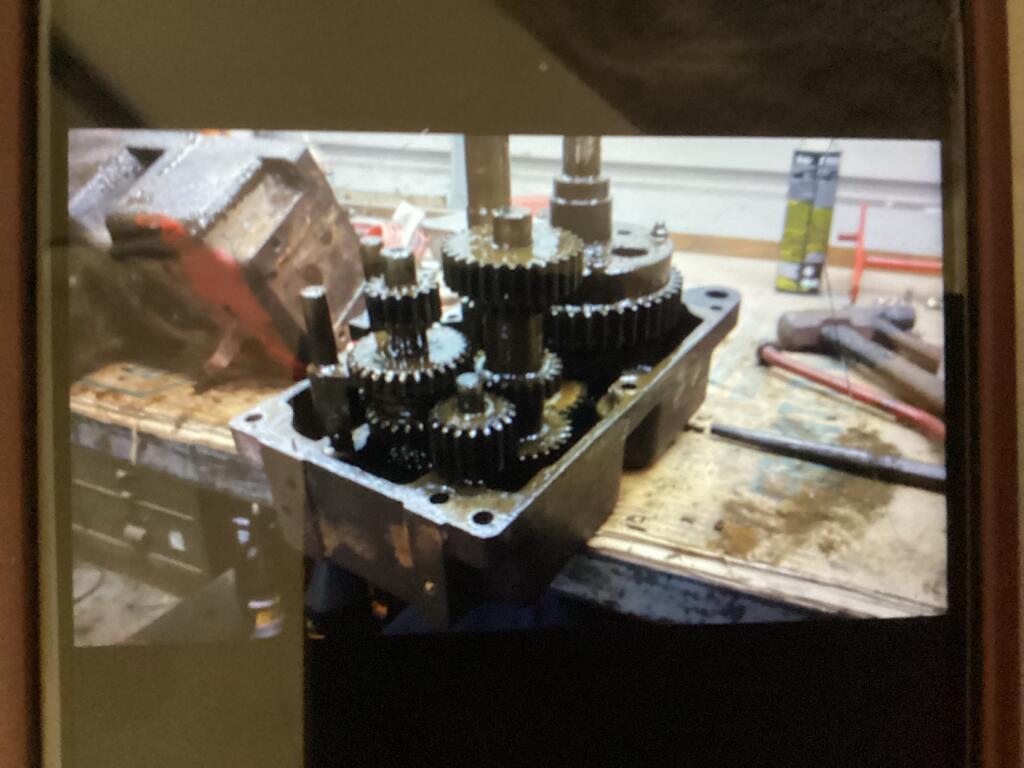

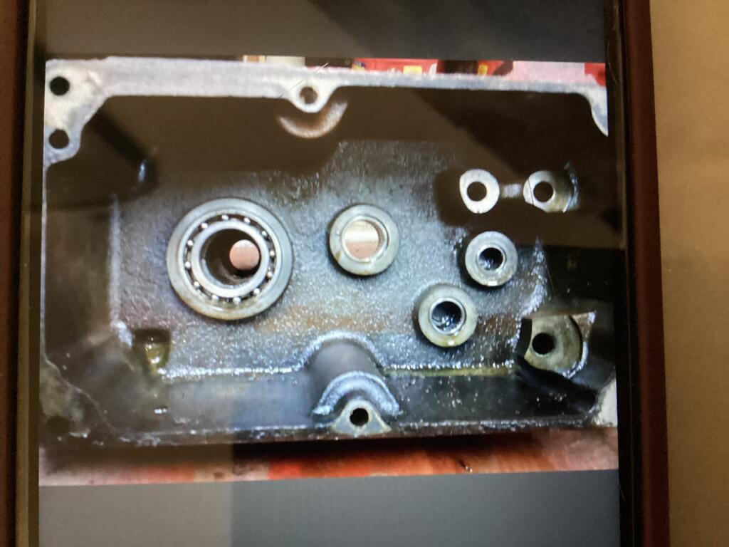

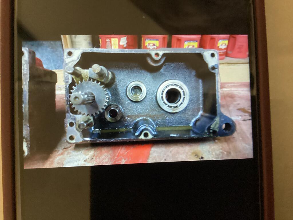

Easton Rich 1,260 #21 Posted January 2 Back on the 653! Today was a interesting day for sure, I pulled apart the transmission with my friend George Sleezer and it looked very nice. Really the trans is off a 69 Commando, but it’s what I’ve got and I think they are the same. I need some assistance on finding a rebuild kit off of Wheel Horse Parts and more that is the correct one. I need the #1533 bearings also. Thanks for the help Share this post Link to post Share on other sites
kpinnc 18,968 #23 Posted January 2 (edited) 2 hours ago, Easton Rich said: Today was a interesting day for sure, I pulled apart the transmission with my friend George Sleezer and it looked very nice. Really the trans is off a 69 Commando, Looks great to me! Is the Commando in the 3rd pic above? Only reason I ask is because those axles are a couple inches longer than standard because of the 10 inch wheel deeper offset. It won't hurt anything, but if you use standard WH wheels the rear will have quite a bit wider track. Edited January 2 by kpinnc Share this post Link to post Share on other sites
WHX?? 58,145 #24 Posted January 2 (edited) 3 hours ago, Easton Rich said: need some assistance on finding a rebuild kit off of Wheel Horse Parts and more that is the correct one Give Lowell a jingle at parts n more. He'll help you order the right kit. He's got a cheat sheet that will tell you what kit you need but he'll want to know what tranny you have. @wheelhorseman Edited January 2 by WHX?? Share this post Link to post Share on other sites

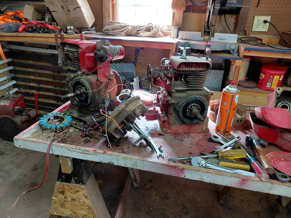

Easton Rich 1,260 #25 Posted February 22 Back on this project! Went over the George's to pay a visit and get some work done! I ordered the rebuild kit, but it didn't make it in time. We started on the engine. Here is a K181 and a K161 that we are combining to make one good one. In the end, we will have a 702 starter motor style tractor. Share this post Link to post Share on other sites
