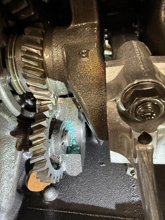

953 nut 67,451 #31 Posted May 12, 2025 7 hours ago, svt721 said: From what I can tell from the engine model #, these M12s don't have the balance gears. That would be true for the 8 HP Magnum but not in the 10, 12, 14 and 16. look at page 12B-3 of this manual. 33 minutes ago, svt721 said: has a small amount of wobble. That is a sure sign the grenade- gears were about to cost you some serious money. 37 minutes ago, svt721 said: Attached are pictures, let me know what you guys think. I see plastic everywhere and that is only what shows on the surface. As was said by another person, the governor gear is plastic and if a chunk were to get wedged in tis teeth you would have a problem for sure. Time to do it right rather than wishing you had later. Share this post Link to post Share on other sites
953 nut 67,451 #32 Posted May 12, 2025 27 minutes ago, WHX?? said: I'll let @953 nut chime in on that. He's got a post to check the bore to see if boring or just honing will get it done. I was suggesting leave it in for now to get her back mowing quicker. A full rebuild if measurements dictate when you can lay it up over winter. This is a down and dirty way to check the bore. If you can find the .003 over rings you will want to check the end gap on each ring at the top of the cylinder bore so you don't have then pinched too tight. The manual in the previous post has this information in it. 1 Share this post Link to post Share on other sites

svt721 27 #38 Posted May 13, 2025 Great information guys, I really appreciate it. I pulled the balance gears last night - the OCD in me wants to replace bearings and put them back in, how much vibration am I going to see compared to running with the gears? Richard - you're speaking the same words of wisdom that run through my head, do it right the first time. I have a friend who can lend me a spare Deere 115 - never mowed with anything modern before haha. Otherwise it may have been worth the drive to take you up on your offer. Said friend knows a machinist that can take care of the machine work on the block. That said, what do you recommend for a rebuild kit? I see a few that have every internal component, but I don't know that it's necessary to replace valves or the rod (or the carb, coil, etc which is included in one kit). My plan would be to take the block to the machinist and let him measure it, then order the parts. I'm thinking I'd need piston, rings and gaskets. Since there's so much plastic in the crank bearings I'm thinking it would make sense to replace those and the crank seals as well unless you think otherwise. Is there anything related to the governor that I should replace? Machine has a little over 1000 hours on it. Squonk - I've heard of richmondred and would bring him the block for the machine work, but Richmond is a 10 hour drive round trip which I can't really justify right now if I can get it done locally. 1 Share this post Link to post Share on other sites

WHX?? 57,446 #40 Posted May 13, 2025 10 minutes ago, svt721 said: the OCD in me wants to replace bearings and put them back in, I can relate to that but let it pass ... your much better off without them. I have never done it but I heard tell it's a real pain to install them and get them timed right. Read the manual on doing it, it can be quite confusing for this simpleton anyway. Some of the guys report no additional vibration or lack of smoothness ... some do. kinda like going to solid mounts on a shaker plate motor. 25 minutes ago, svt721 said: what do you recommend for a rebuild kit? Some guys prefer the master rebuild kits which includes darn near everything. Personally I prefer to piece every thing out as some things like valves can be cleaned up and lapped. Much less costly that way and when you have 30 ... gulp... tractors to tend to. 16 minutes ago, svt721 said: related to the governor that I should replace? No ... just make sure the flag is secured to the shaft yet. 1 Share this post Link to post Share on other sites

WHX?? 57,446 #42 Posted May 13, 2025 5 minutes ago, svt721 said: replacing the crank bearings or just clean them out and let them roll? Inspect them I guess is all I can tell you. Most guy are are going to tell you to replace them. Richmond Red would but he is a pro builder and wants no call backs for his customers. His price reflects that but then again If that's what folks want. I think of all the rebuilds I have done I replaced them once. Share this post Link to post Share on other sites

Fordiesel69 272 #48 Posted May 16, 2025 I usually do not take the magnum grenade gears out till 2500+ hours. Their construction seems to be more durable than the K series. Share this post Link to post Share on other sites
kpinnc 18,754 #49 Posted May 17, 2025 On 5/13/2025 at 9:11 AM, svt721 said: I pulled the balance gears last night - the OCD in me wants to replace bearings and put them back in, how much vibration am I going to see compared to running with the gears? In a 12hp engine that is direct mounted (no isolation cradle mount), the vibration will be minimal just due to the shorter throw of the crankshaft. On a 14 or 16 it is more evident, but still not terrible. It is also usually more noticeable at lower RPM. 1 1 Share this post Link to post Share on other sites
oliver2-44 11,632 #50 Posted May 17, 2025 On 5/13/2025 at 8:11 AM, svt721 said: I pulled the balance gears last night - the OCD in me wants to replace bearings and put them back in, how much vibration am I going to see compared to running with the gears The shafts also wear. If I recall correctly they have 0.0005 the wear tolerance. So many are worn just like the bearings. Share this post Link to post Share on other sites
