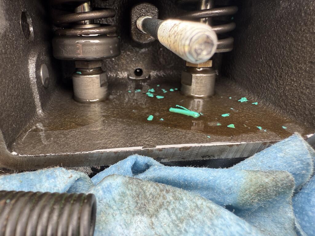

svt721 27 #1 Posted May 10, 2025 Hey Group, The last couple times I've checked the oil in my '87 312-8, I've found little chunks of green plastic on the dipstick. I've scoured the internet and other than the breather filter I can't find any other green plastic component inside the engine that would leave chunks like this. I got a new breather element (this one was in there for around 300 hours) and took the valve cover off. The old breather element seemed thin compared to the new one (both genuine Kohler) but there was a ton of that green plastic inside the valve housing. Have any of you seen anything like this before and am I right to think this was the result of the breather element disintegrating? Attached are a few pictures. Thanks! Mike 1 Share this post Link to post Share on other sites
953 nut 69,724 #2 Posted May 10, 2025 Only blue/green plastic I am aware of is the low oil switch. 3 Share this post Link to post Share on other sites
Ed Kennell 47,552 #3 Posted May 10, 2025 Did someone use a liquid gasket material as a seal? Share this post Link to post Share on other sites
wallfish 20,652 #4 Posted May 10, 2025 Looks like too much green gasket sealer was used. Is it soft and rubberie? Share this post Link to post Share on other sites
Fordiesel69 272 #5 Posted May 10, 2025 I believe that is the float for the low oil level switch. 1 Share this post Link to post Share on other sites

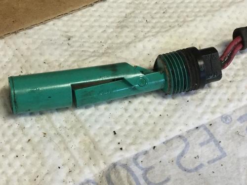

svt721 27 #12 Posted May 11, 2025 953 nut - that’s the one component I never considered but I think you hit the nail on the head. The oil switch hasn’t worked since I’ve had it (7 years) but I figured it had just failed electrically. But it looks like the float must have broken off and has been rattling around inside the crankcase. The color of the plastic is exactly the same. I guess it makes sense being 38 years old, but I just hope it hasn’t done any major damage to the engine. It’s been like that since the beginning of the season and it doesn’t run any different than it always has. How hard is it to pull the engine off the oil pan to clean it out, or is this going to require complete disassembly? I adjusted the valves yesterday and noticed there were tiny pieces of plastic in the adjuster screws in the lifters. Share this post Link to post Share on other sites
953 nut 69,724 #13 Posted May 11, 2025 26 minutes ago, svt721 said: How hard is it to pull the engine off the oil pan to clean it out, or is this going to require complete disassembly? That is a question only you can answer. Removing the engine block from the oil pan is a rather straight forward operation, unhook a few belts, wires and cables and remove four bolts, BINGO, its out of there. That is the easy part, deciding if any of those little plastic gremlins have gotten into places the will eventually cause a catastrophic failure is the hard question that only you can answer. The fact that they have migrated into the valve gallery leads me to think they are everywhere including the piston rings and the crankshaft journal. If it were my engine I would completely disassemble the engine, clean and inspect each part, have the cylinder bore measured and buy the appropriate rebuild kit. 3 Share this post Link to post Share on other sites

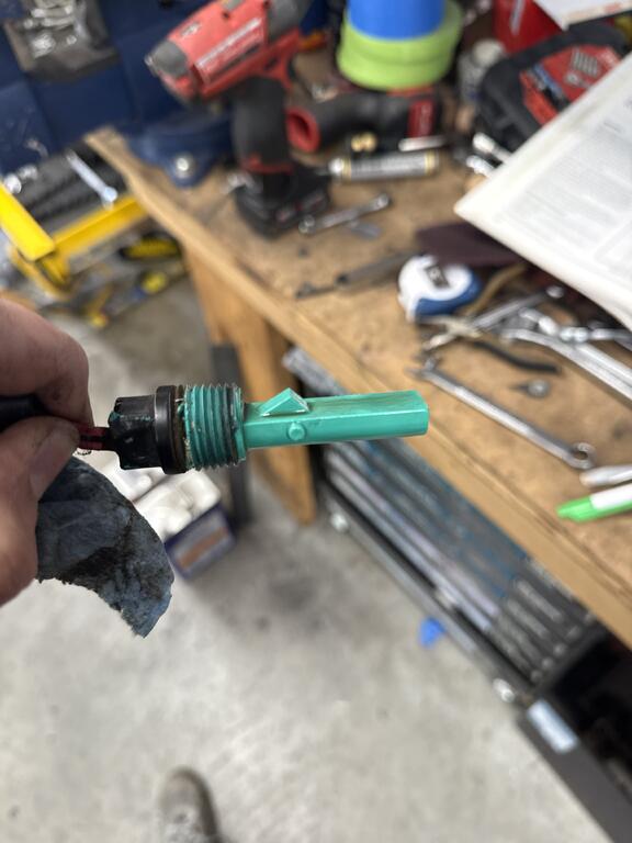

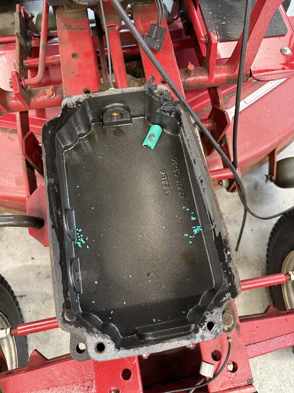

svt721 27 #18 Posted May 12, 2025 That's my plan, already have a new pan gasket on order. It turns out the entire float piece of the oil level sensor came off and has been rattling around in the crank case. Picture attached is what the sensor looked like when I removed it yesterday. That'll be replaced with a pipe plug! I'm hoping the plastic hasn't gotten packed into the crank bearings but my plan is to pull the engine off the pan and try to flush everything out with brake clean. I may pull the head and pop the piston out to make sure plastic isn't stuck in the rings, but that'll depend on initial inspection. I can see 2 big chunks of the float in the pan but there's no way to get them out. Tried flushing the pan out with some old 2 cycle mix a couple times but all the plastic shavings are stuck to the cast iron. Hoping this is a relatively quick job, need to get back to mowing the end of the week! 2 1 Share this post Link to post Share on other sites

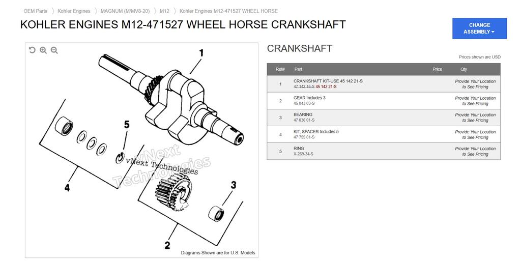

pfrederi 21,215 #24 Posted May 12, 2025 2 hours ago, svt721 said: Oh no, no sympathy, I do this to myself From what I can tell from the engine model #, these M12s don't have the balance gears. Interesting difference in data The Toro parts diagram for 471527 does not show balance gears....However the parts listing on the Kohler website does Share this post Link to post Share on other sites

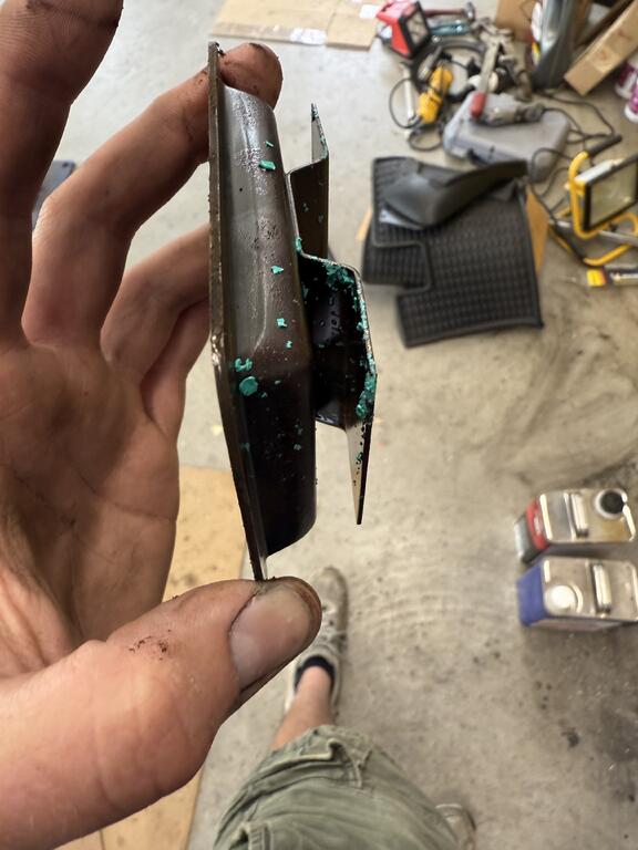

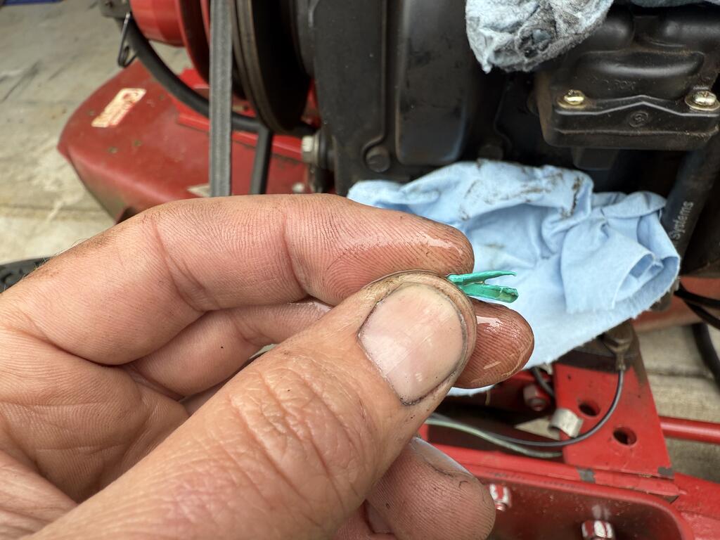

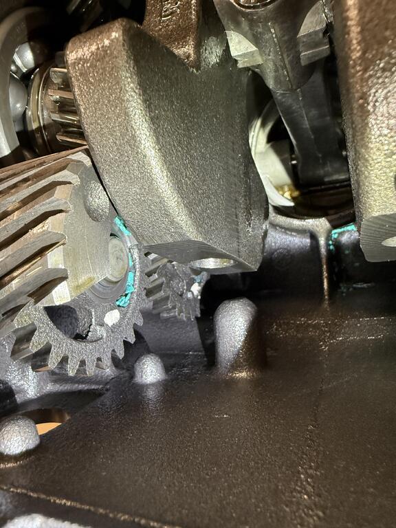

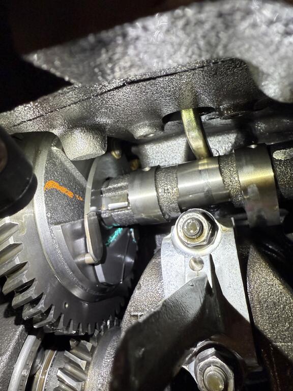

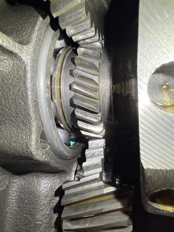

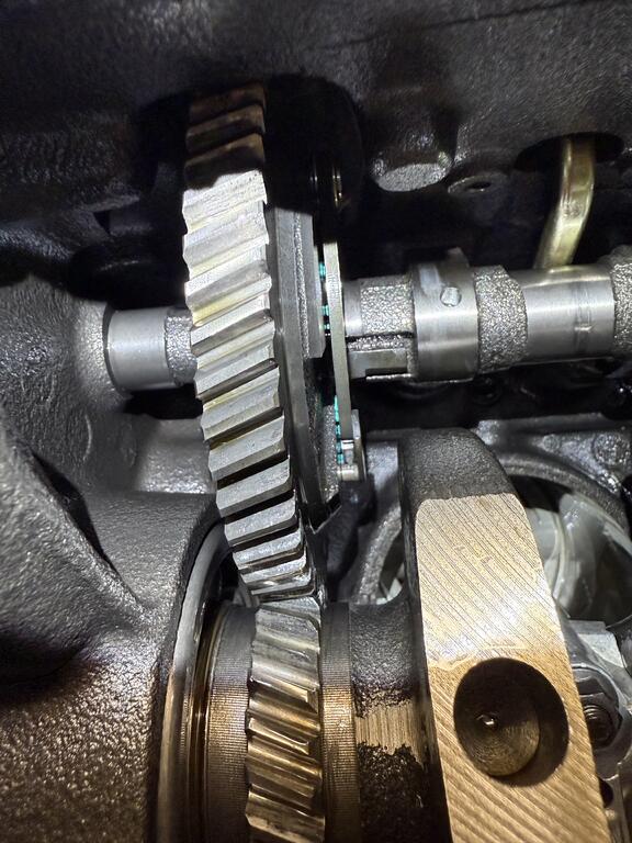

svt721 27 #25 Posted May 12, 2025 (edited) The Carnage... Paul - you're right, there are balance gears in there after all. That bugs me because I absolutely hate removing something they put in there from the factory, but reading about them now I'm paranoid. The bottom gear (closest to pan) has a small amount of wobble. I've never noticed any noise or knocking and I suppose if I did I figured it was coming from the mower deck. But I guess I'd be wise to pull them out for now. Perhaps rebuild and reinstall in the future. Here's what I found. The main body of the float was laying in the pan, but the thing sides that attach to the sensor body are shredded. The pieces are everywhere, in the side of the cam gear, I see pieces in the crank bearings, the hole in the bottom of the rod was full of it. I'm going to pop the piston out to check the rings and then do my best to flush all this crap out of here. My main concern is the crank bearings that the plastic will block oil splash to keep them lubricated. Attached are pictures, let me know what you guys think. How has this never happened to anyone else?!? Edited May 12, 2025 by svt721 1 Share this post Link to post Share on other sites
