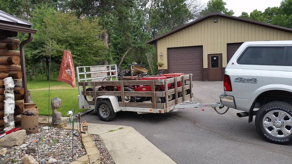

Sparky-(Admin) 26,263 #5 Posted May 6, 2025 If your planning to haul full size tractors such as C series a 6’6”x12‘ is the way to go. Will hold 4 machines nicely. This is mine from last week loaded for a local show. The 520-8 and 308-8 are full size, there is also an 857 and a B-80 on the trailer. 9 Share this post Link to post Share on other sites

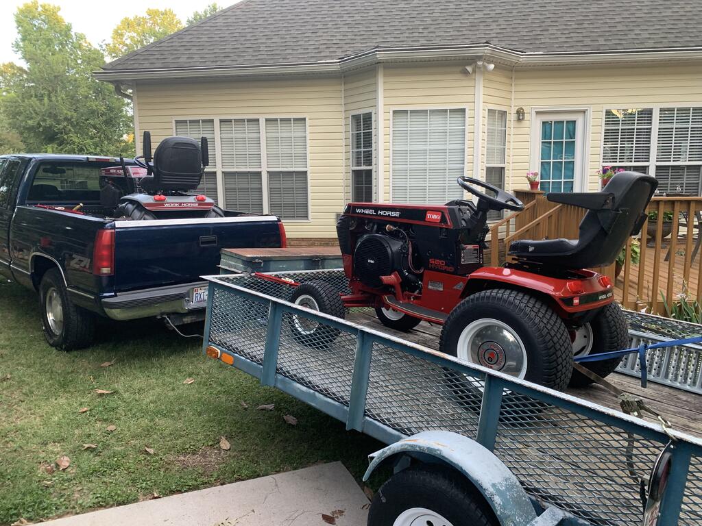

squonk 47,990 #6 Posted May 6, 2025 Gotta go 6 1/2. My trailer is 6' X 10' I like the skinny 6-12 tires on most of my tractors. So I could fit 3 on it. A short frame (857) with the skinnies on the front sideways then my 953 and a 1267 ( with skinnies) next to it. Tight fit. 3 Share this post Link to post Share on other sites

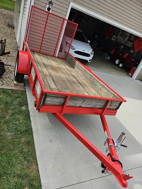

Pullstart 71,160 #10 Posted May 6, 2025 I realize that this is not for everyone, but I have as much into this trailer with brand new tires, as a TSC 5x8 deluxe model costs. I’m not saying everyone needs this, but used with some TLC may bring a decent value vs cost. 5 2 Share this post Link to post Share on other sites

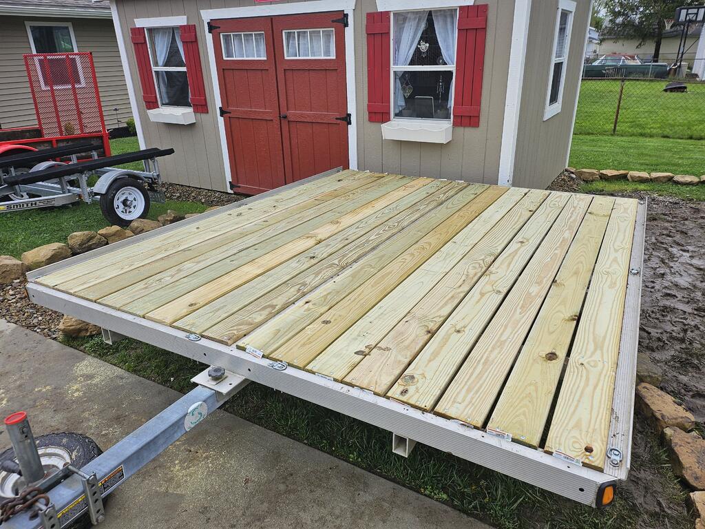

ML3 2,489 #12 Posted May 6, 2025 Have 8x10 snowmobile trailer that I bought new in 2007. Just finally had to re-deck it last Sunday. Original floor lasted since new despite trailer always sitting out. I like cause it's really lightweight. Also have 5x10 utility trailer I bought new at county fair 20yrs ago for $895. Gotten a lot of use outta it. Last summer I went thru it- stripped & painted, new lights/wiring, new hardware, new hubs. Considered replacing trailer but comparable new ones are almost $3k & definitely aren't built as good. Decided to put some $$ in it & get another 20yrs outta it. Fortunately in Ohio is pretty inexpensive to register a trailer. 6 1 Share this post Link to post Share on other sites

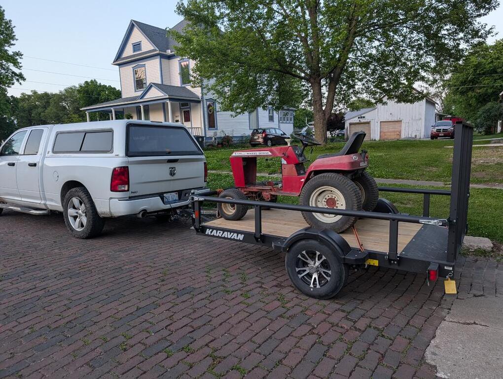

8ntruck 9,246 #20 Posted May 29, 2025 Here it is, with its first load. You happy with this @953 nut? That tailgate eats up about 4mpg with the trailer empty. More than I expected for a low utility trailer that weighs somewhere between 800 and 900 lbs. Interestingly, put 600 pounds of tractor on it and you get about 1mpg better than empty. I'm thinking the gain comes from the turbulence caused by the tractor reducing drag for the tailgate. Kind of like the wat dimples on a golf ball work. 4 1 Share this post Link to post Share on other sites
SylvanLakeWH 32,279 #21 Posted May 29, 2025 7 hours ago, 8ntruck said: That tailgate eats up about 4mpg with the trailer empty. I typically take the tailgate off and put it in the trailer when driving empty... makes a difference... 3 Share this post Link to post Share on other sites
wallfish 20,553 #22 Posted May 29, 2025 8 hours ago, 8ntruck said: That tailgate eats up about 4mpg with the trailer empty. More than I expected for a low utility trailer that weighs somewhere between 800 and 900 lbs. Interestingly, put 600 pounds of tractor on it and you get about 1mpg better than empty. Will it fold down inside and lay on the bed? I'm considering removing mine and just using ramps to load and unload. Not like I'm a landscaper using the ramp 10 times a day. Ramps can be held with a bolt or 2 and wing nuts on the inside of the side rails. 2 Share this post Link to post Share on other sites
