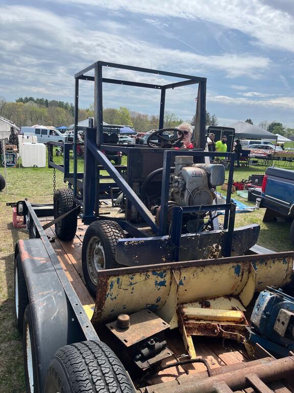

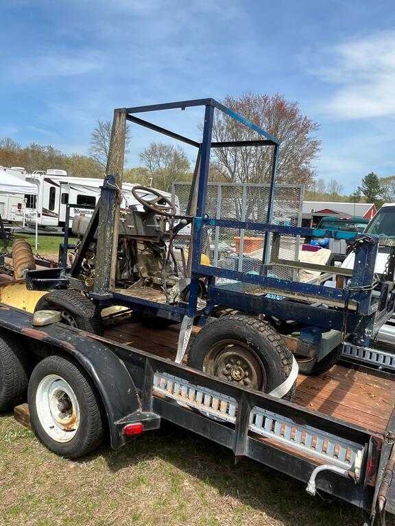

Not sure how much time this is going to take but the bones are already there for truck project. Obviously won't be all WH parts like every other build but oh well. Lots of time saved and still a cool project.
Bought this at the Zag show yesterday. @Sparky and @Docwheelhorse were kind enough to go grab it for me since there was no room to haul it home but the seller is close by to them.
169443479_truckprojestside.jpg.e181a299f7658cee0c62015f3ef0ec99.jpg1770288994_Truckproject.jpg.3588b7b505c057ad80628444777cf481.jpg

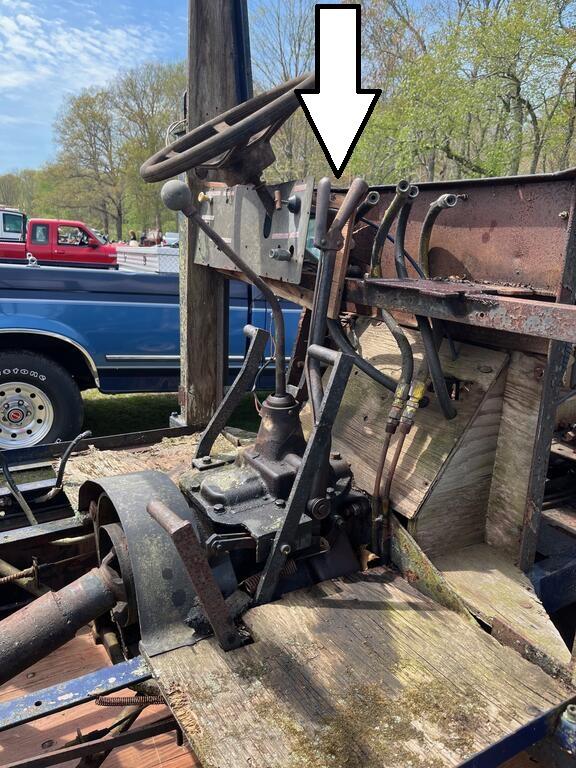

Anyone familiar with that type of trans? What's this handle for?
@Stepney
squonk
Either the ejection seat or it lets out the emergency brake (boat anchor) :)

ebinmaine
I was thinking brake but ejection seat is WAY more fun.

wallfish
The handle in question is connected right into the trans. There's a regular flywheel and clutch assembly operated by a pedal but it's likely/possible the trans is older than that setup is. Could be a trans brake used for a parking brake maybe??? This stuff is out of my wheelhouse and it's not here yet to play with.
Those 2 homemade levers in the pic are connected to the E brake cables for steering brakes.
The rear drum brakes are plumbed to an auto style master cylinder with front and rear lines Tee'd together.
The hydraulics are old and need replacement of lines, no pump, no valve. I have an old style Jeep hydraulic setup that runs off 12v starter so that might be cool.
Planning to power it with an old twin cylinder Onan CCK 6v engine. Think it's 13.5 Hp but...

Handy Don
That extra handle on the “truck” is attached to a band brake on the final-drive end of the transmission.
So there are:
- separate levers activating the “parking brakes” on each rear wheel,
- a single brake pedal activating the rear drum brakes on both rear wheels, and
- that lever for the band brake.
Plenty of “stop”. Need to explore the “go”.
There was no diagram covering the shift pattern so it’ll be fun exploring the trans--I suspect you’ll find a 3- or 4-speed and reverse.

Ed Kennell
Parking brake.

oliver2-44
Does the transmission have a 2nd output shaft (or blank removable cover for one) which was typically used for a winch or hydraulic pump.
