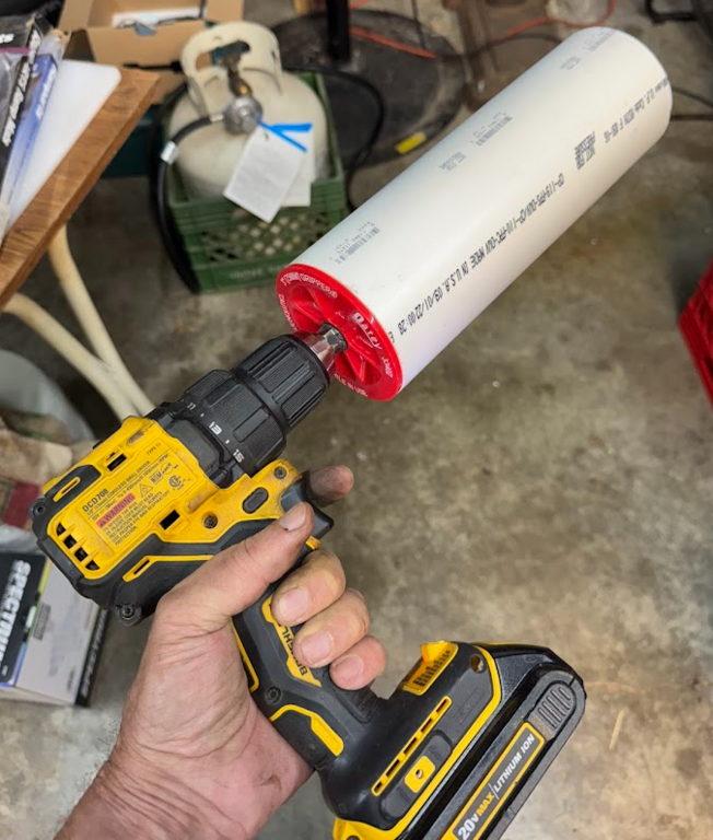

Bar Nuthin 3,115 #1 Posted April 26, 2025 Ran across a couple videos while looking for a paint shaker and saw this contraption for spray cans. I already had a piece of 3" PVC the right length. Just bought the 3" plug - stupid thing works like magic!!! 6 1 Share this post Link to post Share on other sites
ebinmaine 80,461 #2 Posted April 26, 2025 Interesting concept! 1 Share this post Link to post Share on other sites
Bar Nuthin 3,115 #3 Posted April 26, 2025 1 minute ago, ebinmaine said: Interesting concept! When you stop the drill, you can hear the shaker ball whizzing around inside the can. Can of Rust-Oleum, prolly setting a couple years, sprayed like a dream. 1 1 Share this post Link to post Share on other sites
HyperPete 939 #4 Posted April 26, 2025 So, the one Adam likes has the shaft slightly off-center to facilitate shaking & mixing through wobble. How does the one in the 2nd video achieve that? Sorry, a bit critical, I know. Share this post Link to post Share on other sites
Bar Nuthin 3,115 #5 Posted April 26, 2025 (edited) 53 minutes ago, HyperPete said: So, the one Adam likes has the shaft slightly off-center to facilitate shaking & mixing through wobble. How does the one in the 2nd video achieve that? Sorry, a bit critical, I know. The pipe is 3" - about a half inch wider than the spray can. The shop rag holds it against the side wall, plus allows you to retrieve the can. If you don't hold on tight, it takes on quite a wobble. I'm not sure the wobble is as important as the cyclone action it gets from spinning so fast. I don't think the wobble in Adam's video was intentional. I'll try to get a video of the one I made so you can see it. Edited April 26, 2025 by Bar Nuthin 1 1 Share this post Link to post Share on other sites

HyperPete 939 #7 Posted April 26, 2025 Well it looks like It works well, and it's obviously very cheap, so I guess I'll have to give this a shot too! I think I have some three inch PVC, all I need is a test plug. Thanks for posting this! 1 Share this post Link to post Share on other sites

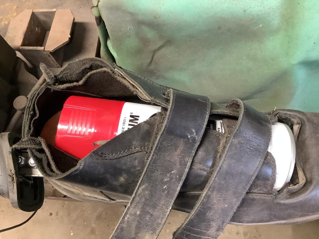

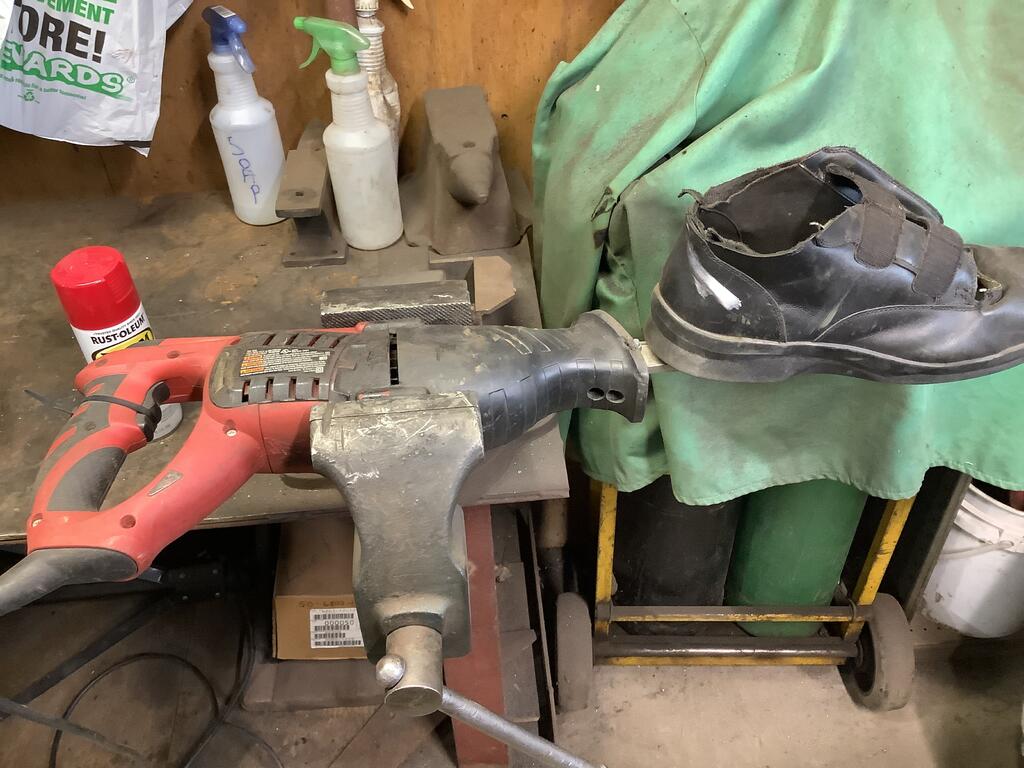

CRF857 673 #13 Posted April 26, 2025 13 hours ago, Bar Nuthin said: Ran across a couple videos while looking for a paint shaker and saw this contraption for spray cans. I already had a piece of 3" PVC the right length. Just bought the 3" plug - stupid thing works like magic!!! I purchased a skill reciprocating saw at a garage sale. The blade mounting component was broken. After finding out i was NLA I turned it into a paint shaker. BIL donated a shoe with velcro straps. If straps are slightly loose the can will rotate while being shaken. Turn it on and walk away for a few minutes. BIL’s shoe was big enough to accommodate the tall cans also. 13 hours ago, Bar Nuthin said: Ran across a couple videos while looking for a paint shaker and saw this contraption for spray cans. I already had a piece of 3" PVC the right length. Just bought the 3" plug - stupid thing works like magic!!! 3 3 Share this post Link to post Share on other sites
