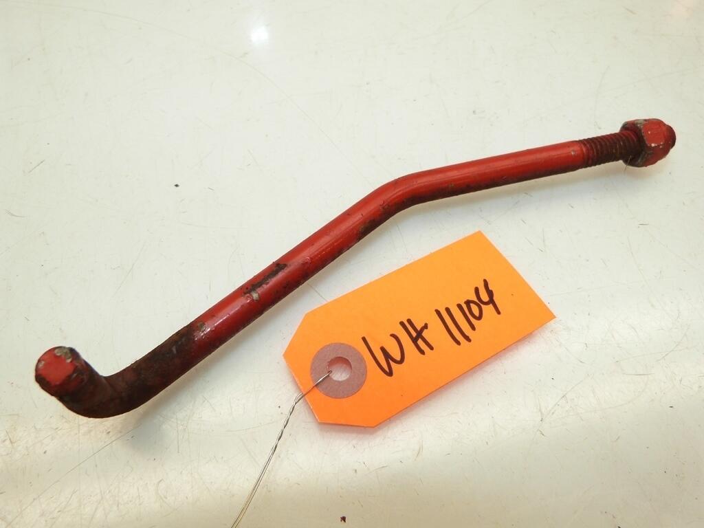

ri702bill 12,230 #18 Posted April 23, 2025 (edited) One of the key pieces is using a brake rod from a Raider 10 or 12 hp tractor. The brake band mounts "backwards" from the 4 speed..... See file picture. Edited April 23, 2025 by ri702bill 2 Share this post Link to post Share on other sites
