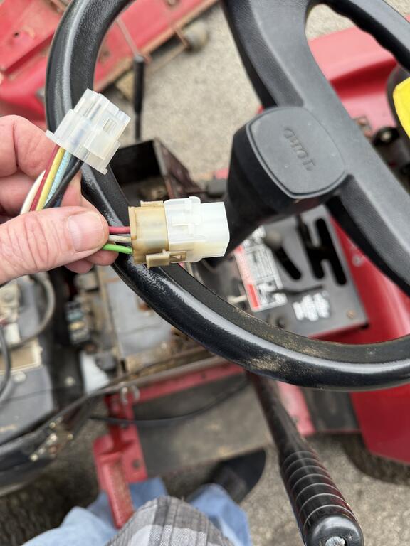

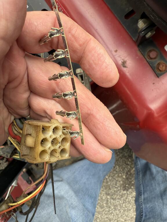

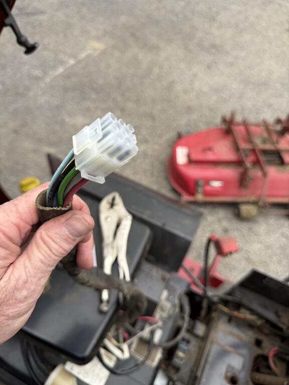

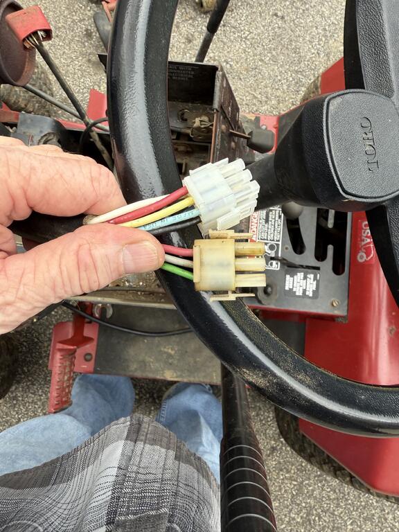

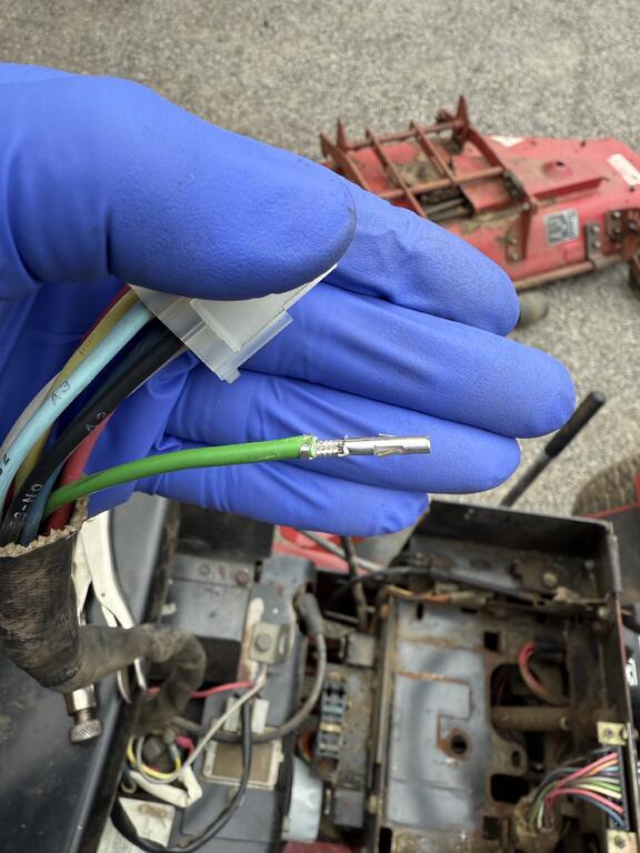

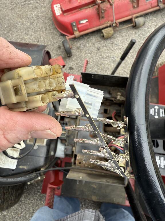

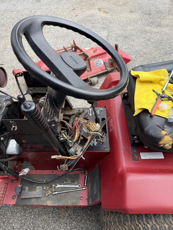

nylyon-(Admin) 9,059 #12 Posted April 21, 2025 Testing both ends before depinning, perfect fit and look identical. next to be certain that the pins are identical, and they are. I depinned the pins on the engine side and replaced them is they came out bad or were burnt. If the pins were good, they got reused. old and new one side done. The tractor side has less room, so taking a break for a moment. 1 1 Share this post Link to post Share on other sites
nylyon-(Admin) 9,059 #13 Posted April 21, 2025 @TC10284 the Amazon link is what I bought. It is exactly identical, at least for my 1995 416-8. 1 Share this post Link to post Share on other sites
WHX?? 58,156 #14 Posted April 21, 2025 4 minutes ago, rmaynard said: Check the ones that you have in the HVAC business and see if they are interchangeable with Wheel Horse. They were Bob ... Dan and I did a motor swap on these two girls and only replaced one side. My company even sprung for the terminal crimper. Looks like Coach has the crimper too! 1 Share this post Link to post Share on other sites

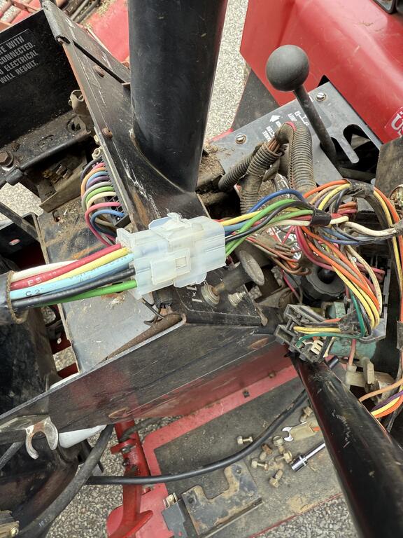

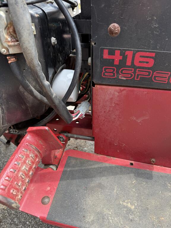

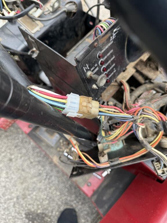

nylyon-(Admin) 9,059 #15 Posted April 21, 2025 Less room on the tractor side so I decided to take some time to make the wiring easier. again, this is an exact match Share this post Link to post Share on other sites
nylyon-(Admin) 9,059 #16 Posted April 21, 2025 Now to reassemble the tractor! Share this post Link to post Share on other sites
nylyon-(Admin) 9,059 #17 Posted April 21, 2025 Amazon Molex 9-pin is the exact same plug and connectors, and best of all at the time of this post April 21, 2025 it is only $4.84 USD which includes Prime shipping. For those interested, these are the tools I had to do this (or at least similar to these) Pin extractor Crimping tool For me I was getting intermittent power loss, but jiggling that harness I could get it going again. I took a shot on Amazon for a connector that looked the same and bought it with the pins. It was a perfect match, absolutely identical in every way. I decided to replace only the pins which were bad with the red “hot” wire being the worst. The engine side of the harness is pretty easy to do since you can get to the wiring easily. I found that some of the factory crimps weren’t as solid as they should have been, those terminals were replaced. The tractor side was more challenging since there is far less working room to get the crimper tool in there, for me it was easier to disassemble that area and move the harness out the dash panel where it was way easier to reach. It’s all back together now, hope it lasts another 30 years! 1 1 Share this post Link to post Share on other sites

nylyon-(Admin) 9,059 #20 Posted April 21, 2025 Just mowed the lawn, zero issues definitely fixed my problem. There is another 9-pin connector, which I believe is the same part, which is used to connect the indicator lights to the tractor harness. While my indicator lights are working, that connector has seen better days so I just ordered 3 more from Amazon, one for the indicator lights on this machine, and 2 more for my 416-H just in case. The other options above will probably work just as well (maybe better) but my OCD won’t allow me to do those, so I opted for the replacement part. 1 Share this post Link to post Share on other sites

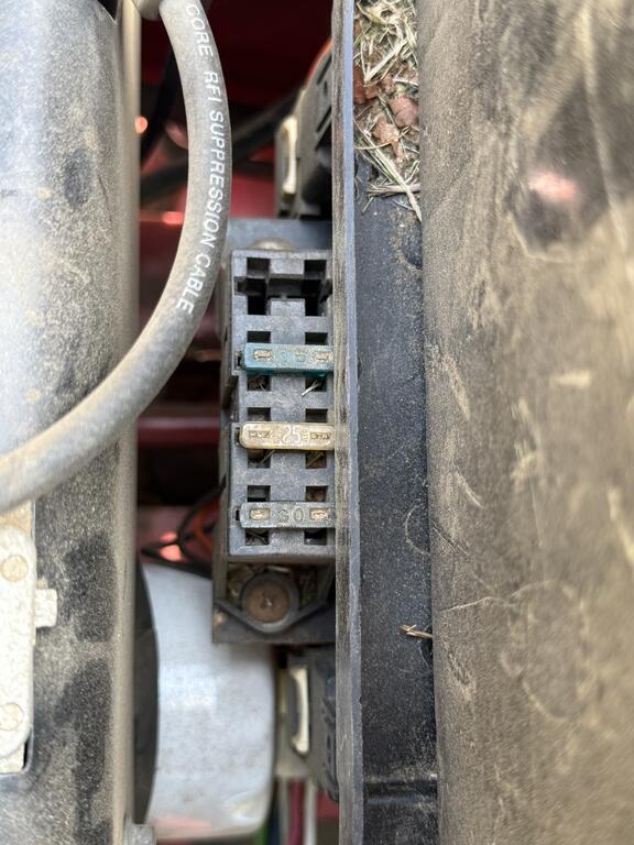

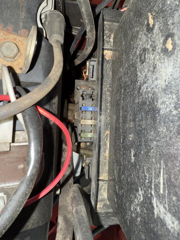

TC10284 121 #25 Posted April 25, 2025 (edited) 3 hours ago, nylyon said: Interesting, you have only 2 fuses. Both of mine have 3 with the 15A powering the lights, volt and hour meter, and oil pressure switch (and indicator light) which would not affect the running of the engine. You can test this bu pulling the 15A and see if it runs? Fig. 1 (1994 416-H) Fig 2. (1995 416-8) What year / model do you have, maybe the wiring is different than mine? If the fuse block needs to be replaced, this would work as a replacement: https://www.amazon.com/Dorman-85668-Black-Block-Holds/dp/B000CO7I04 It's because one fuse has already been bypassed with the the single wire and single fuse holder style on this tractor, by the former owner. I may as well redo it properly. As long as I can get those Phillips screws out... Edited April 25, 2025 by TC10284 Share this post Link to post Share on other sites
