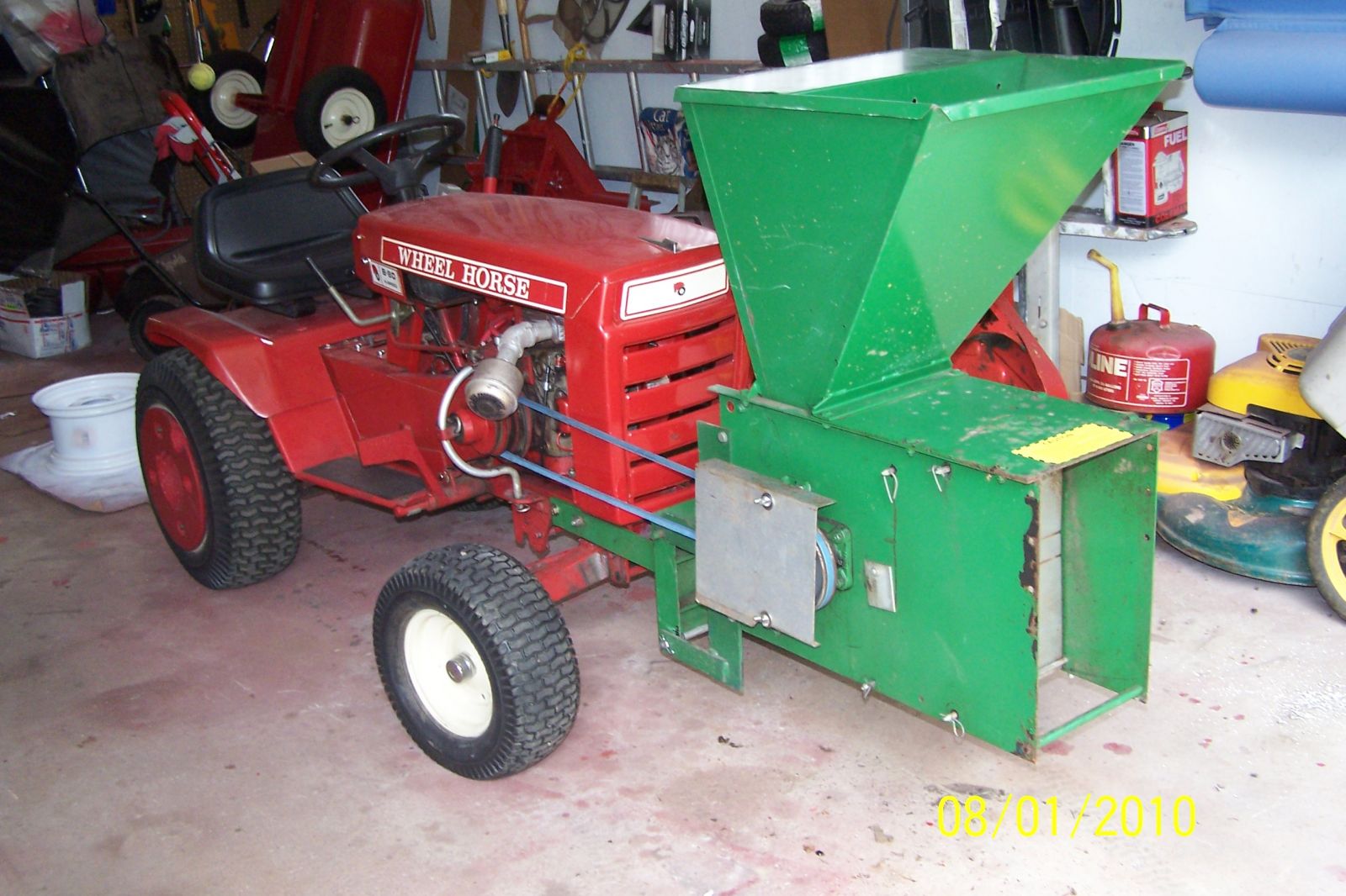

Bar Nuthin 3,229 #1 Posted April 10, 2025 (edited) After seeing some other threads on here about Mighty Mac chipper shredders, attached to WH tractors, I decided to keep watch for one at a decent price. I ended up finding this one on marketplace and negotiated the price down to $100 - knowing it was non-running ($45 cheaper than the replacement screen I had to order ) . Since my plan was to convert it to a WH attachment, the "non-running" part didn't bother me. After a few messages back and forth with @ebinmaine, and looking at his previous threads on the topic, I decided to pull the trigger! Here's a video of my progress, so far. Edited April 10, 2025 by Bar Nuthin 2 6 Share this post Link to post Share on other sites

Bar Nuthin 3,229 #4 Posted April 10, 2025 (edited) The next step will be figuring out how to mount it. I'll post my thoughts and see what kind of feedback I get. I have a parts snowblower I got for free. I measured the attachment bracket it uses, and it is about an inch and a half narrower than the Mac housing. The idler setup looks like it will line up with the Mac's pulley if I mount it flush to the left side and make a spacer for the right. I'm not sure, but I don't think this thing weighs as much as the snowblower, however it will hang out further. I'm hoping I can.... leave the front wheels on (or replace with feet) add a post to attach the snowblower lift tube use the snowblower's attachment point and idler system raise the Mac to move to location, then set it down on the wheels/feet for operation. Working out of state next week, so may be a bit before another update. By the way, I need a side hopper if anyone has a lead on one. Oh, and 1 long pin that adjusts the discharge flap in position. Edited April 10, 2025 by Bar Nuthin 1 Share this post Link to post Share on other sites
ebinmaine 80,695 #5 Posted April 10, 2025 11 hours ago, Bar Nuthin said: how to mount it. I MAY have a JD front mount you could modify >> IF << you want to do a tractor mount like mine 12 hours ago, Bar Nuthin said: need a side hopper Likely you'll rarely, if ever, use the hopper. I find that it gets in the way quite a lot. 12 hours ago, Bar Nuthin said: long pin that adjusts the discharge flap in position. Those look like a standard Hardware type issue. I can measure mine if it would help you. But you should have two or three just like that on the machine already. 1 Share this post Link to post Share on other sites
Bar Nuthin 3,229 #6 Posted April 10, 2025 1 hour ago, ebinmaine said: I MAY have a JD front mount you could modify >> IF << you want to do a tractor mount like mine Thanks, I'm hoping to set it up for easy attachment & removal with the front hitch. If I'm unsuccessful, I may hit you up. 1 hour ago, ebinmaine said: Likely you'll rarely, if ever, use the hopper. I find that it gets in the way quite a lot. Any problems running limbs without the chute, other than probably some flying debris? 1 hour ago, ebinmaine said: Those look like a standard Hardware type issue. I can measure mine if it would help you. But you should have two or three just like that on the machine already. Yeah, I'll probably just make a rod. 1 Share this post Link to post Share on other sites
ebinmaine 80,695 #7 Posted April 10, 2025 7 minutes ago, Bar Nuthin said: Any problems running limbs without the chute, other than probably some flying debris? Read the following note 68 times and then read it a few times after that... DO NOT WEAR GLOVES!! Now what I need you to do is look at the line before this one and read that note again. I bring that up because gloves are going to get caught on branches and you do not want them pulling you and your hands in places you don't need to be. That said, glasses are extremely important. Flying debris is going to happen. These things are very aggressive. Even without the long chute in place there is still several inches of travel before you get to the chopping blades. No intake chute is much easier. That's how I've been running mine since I got it. 2 Share this post Link to post Share on other sites
gwest_ca-(File Mod) 12,488 #8 Posted April 10, 2025 6 hours ago, ebinmaine said: No intake chute is much easier. That's how I've been running mine since I got it. I leave my chute off also. The shredder plastic shield on mine says to not put anything over 1" in diameter in the shredder. That is far too large if working with wood. The 1" limbs are fed into the chipper as far as can be fed and the last handful goes into the shedder. That may be what broke up the screen. 2 Share this post Link to post Share on other sites
ebinmaine 80,695 #9 Posted April 10, 2025 2 minutes ago, gwest_ca said: I leave my chute off also. The shredder plastic shield on mine says to not put anything over 1" in diameter in the shredder. That is far too large if working with wood. The 1" limbs are fed into the chipper as far as can be fed and the last handful goes into the shedder. That may be what broke up the screen. We do the same. Our screen has been shredded since long before our ownership. I'm in the habit of putting anything broomstick sized or bigger through the side chute. Any short leftover sticks (the last few inches) I just chuck in the woods. Share this post Link to post Share on other sites

Lane Ranger 12,105 #13 Posted April 11, 2025 15 hours ago, Bar Nuthin said: First test run. Don't forget if you ever wear the hammer mill blades on the cutting edge they can be removed and turned over to a new hardened edge for use! I sed this one for five years! Great machine! 2 Share this post Link to post Share on other sites
Bar Nuthin 3,229 #14 Posted April 11, 2025 (edited) 42 minutes ago, Lane Ranger said: I sed this one for five years! Great machine! Interesting, looking at the position of your flapper door. Mine is currently pinned at the top-front hole. I haven't found much information on the different positioning. Any insight as to advantages of different positions? Here is a picture I stole from one of @ebinmaine's threads. I think I get it now. Edited April 11, 2025 by Bar Nuthin 1 Share this post Link to post Share on other sites

ebinmaine 80,695 #16 Posted April 11, 2025 1 minute ago, OoPEZoO said: watched Ebay for a few months and managed to score some NOS screens IF you have an extra screen with either 3/4" holes or 1" holes I'd be interested. 36 minutes ago, Bar Nuthin said: . I haven't found much information on the different positioning. Any insight as to advantages of different positions? Not sure if it's mentioned in any manuals.....? My impression is that the flapper door is to guide the output for flight direction and distance AND safety of surrounding people or other creatures and property. I keep mine mid level. @Lane Ranger shows his at a low setting. His would allow very limited travel of output materials at that setting. We don't have much for limitations here. I usually point the whole machine in the direction of the intended usage. Want chips on a pathway? Park the tractor IN the pathway. 2 Share this post Link to post Share on other sites

Bar Nuthin 3,229 #20 Posted April 13, 2025 For as quick as I put this together, with scrap parts, I think it came out pretty good! It's easy to take on and off and roll around for storage. Have a look. 7 Share this post Link to post Share on other sites
ebinmaine 80,695 #21 Posted April 13, 2025 This is excellent! I like the double pulley idler. What size screen holes did you end up buying? 2 Share this post Link to post Share on other sites
