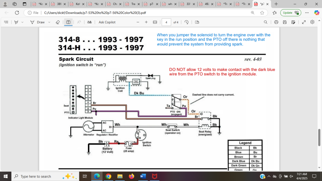

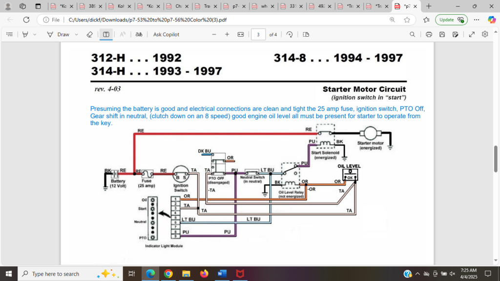

HyperPete 949 #8 Posted April 4, 2025 Im working on my 414-8. I just had to replace the solenoid ($9 on amazon). Maybe these diagrams will help, too: 1 Share this post Link to post Share on other sites
gwest_ca-(File Mod) 12,557 #9 Posted April 4, 2025 The 73400 was produced 1993-1996. The tractor serial number's first 2 digits reversed is the model year. Hope the wiring is the same for all years. Download this file for simple diagrams for each circuit. 1 Share this post Link to post Share on other sites
953 nut 70,654 #10 Posted April 4, 2025 Here are two pages from the Demystification Guide for your 314 with added notes that should be helpful. Cleaning and tightening ALL electrical connections including grounds is very important when searching for an electrical problem. 1 Share this post Link to post Share on other sites
