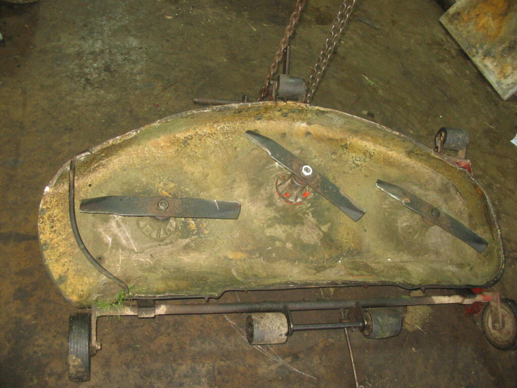

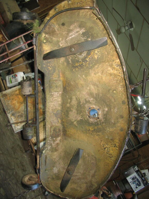

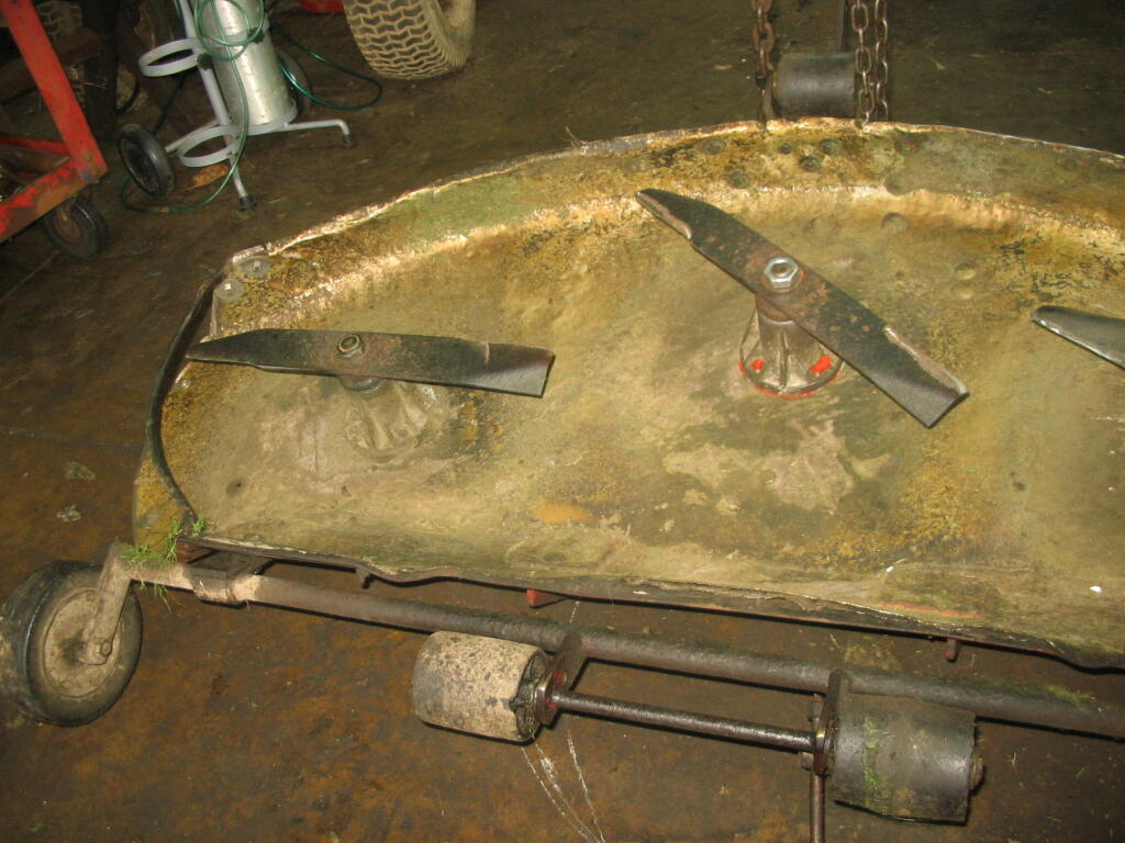

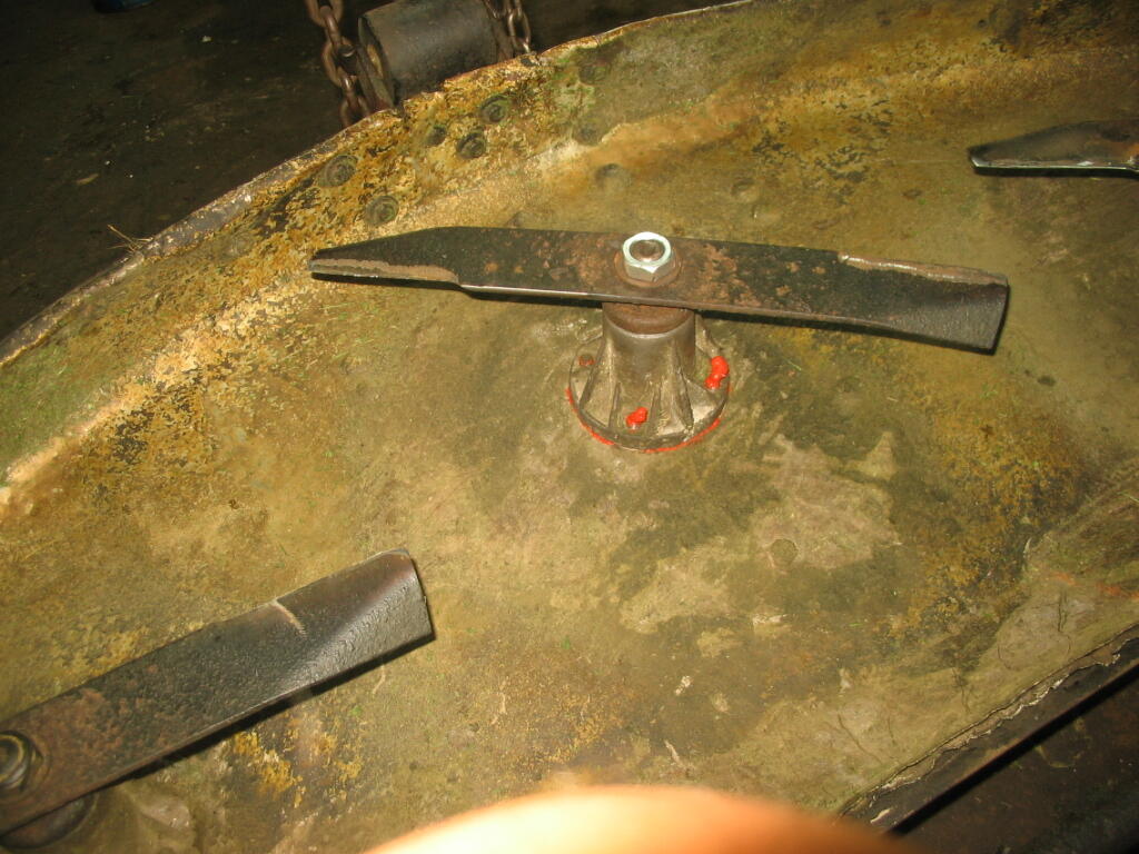

daveoman1966 3,884 #14 Posted February 17, 2025 The 48" deck I use on my Bronco 14 (1972) is from a 1975 C-160. I made this "Upgrade" in 1995 or so and ---to this day---no more rust or rot-out. I cost me no more than a single 'C' note and is a perfect permanent fix--- I also had the problem of deck-rot out from rust. My solution: I made a Stainless Steel liner for the 48" deck. Not difficult to do. Just strip EVERYTHING off the deck...EVERYTHING. Flip it and make a cardboard template of the FLAT are of the deck shell...to include the rear slope and ALL mounting holes. Use that template & cut a SS sheet metal to exact shape of the deck shell and BOLT it in place...all except the 3 spindles. Next, cut a strip of SS metal about 5 to 6" wide and long enough to form the ONE-PIECE front and sides of the deck. Locate the APPROXIMATE 'corner' bends of this strip and make 1" cuts so it will form around the left and right corner sides without crumpling. This strip should also overlap-- by at least one inch-- the main flat SS piece already bolted in place. Having made an approximate fit, use several 'C' clamps to hold in place. Drill 6 or 8 holes thru the front and sides to mount permanently. Now, using a Ball-Peen hammer, gradually hammer the 1" 'overlap' to better fit the contour of the front and side. Share this post Link to post Share on other sites
ssarg95 2 #15 Posted April 13 On 2/17/2025 at 4:36 PM, daveoman1966 said: The 48" deck I use on my Bronco 14 (1972) is from a 1975 C-160. I made this "Upgrade" in 1995 or so and ---to this day---no more rust or rot-out. I cost me no more than a single 'C' note and is a perfect permanent fix--- I also had the problem of deck-rot out from rust. My solution: I made a Stainless Steel liner for the 48" deck. Not difficult to do. Just strip EVERYTHING off the deck...EVERYTHING. Flip it and make a cardboard template of the FLAT are of the deck shell...to include the rear slope and ALL mounting holes. Use that template & cut a SS sheet metal to exact shape of the deck shell and BOLT it in place...all except the 3 spindles. Next, cut a strip of SS metal about 5 to 6" wide and long enough to form the ONE-PIECE front and sides of the deck. Locate the APPROXIMATE 'corner' bends of this strip and make 1" cuts so it will form around the left and right corner sides without crumpling. This strip should also overlap-- by at least one inch-- the main flat SS piece already bolted in place. Having made an approximate fit, use several 'C' clamps to hold in place. Drill 6 or 8 holes thru the front and sides to mount permanently. Now, using a Ball-Peen hammer, gradually hammer the 1" 'overlap' to better fit the contour of the front and side. Do you remember what gauge SS sheet metal you used? Share this post Link to post Share on other sites
