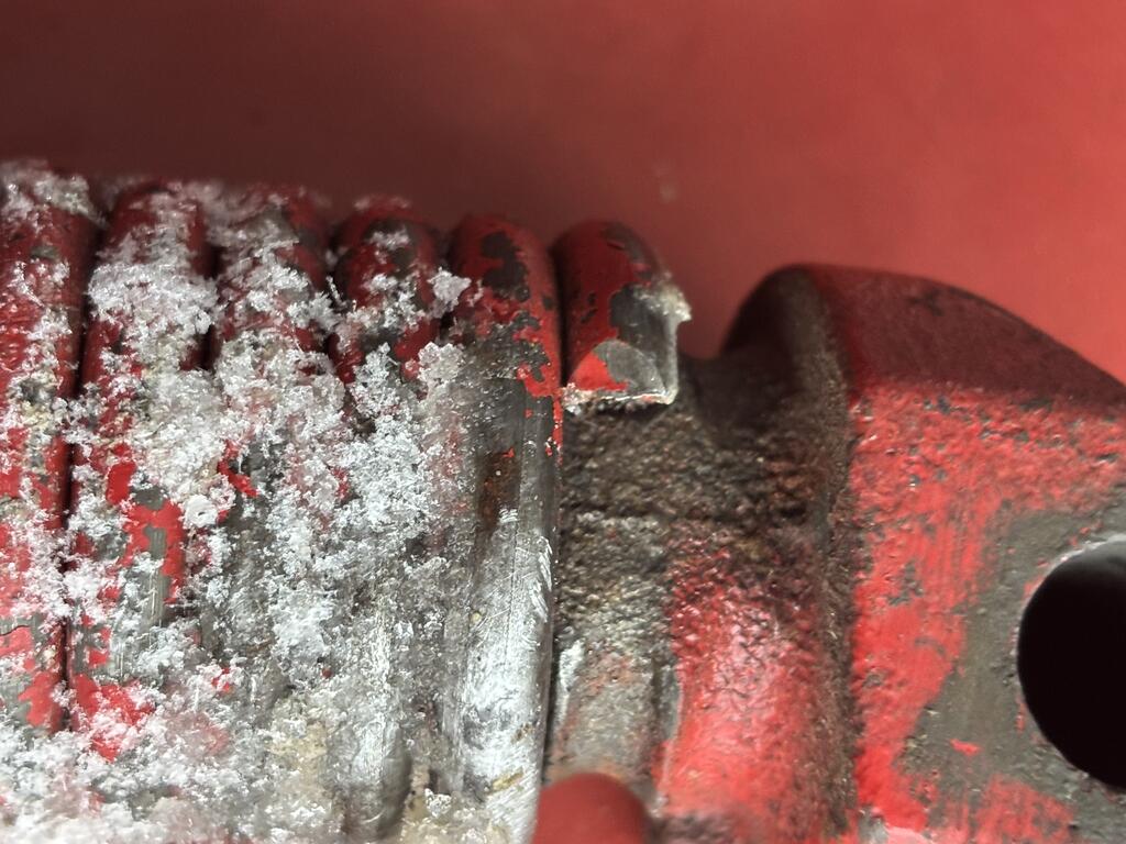

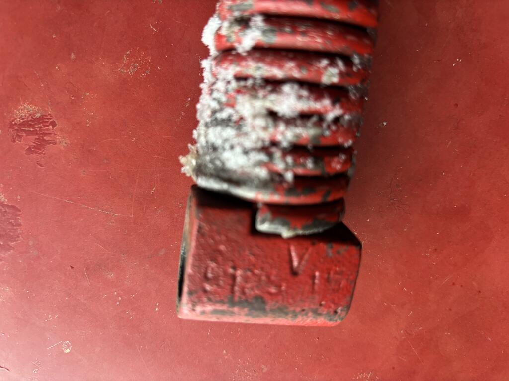

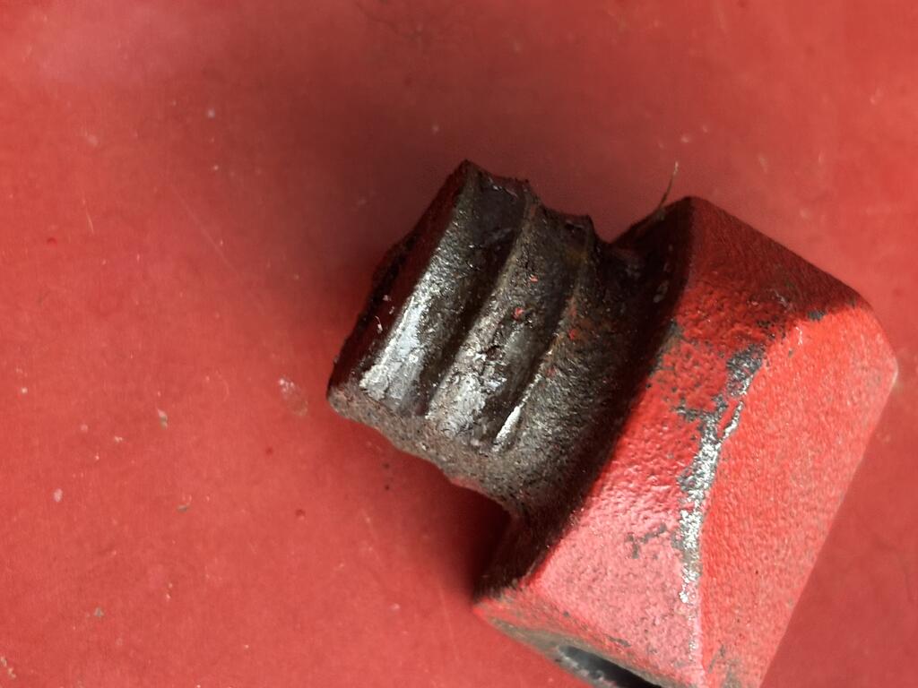

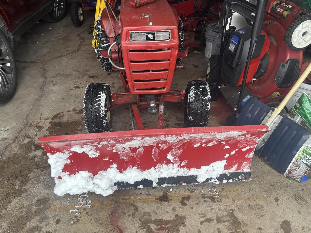

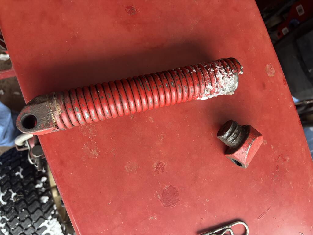

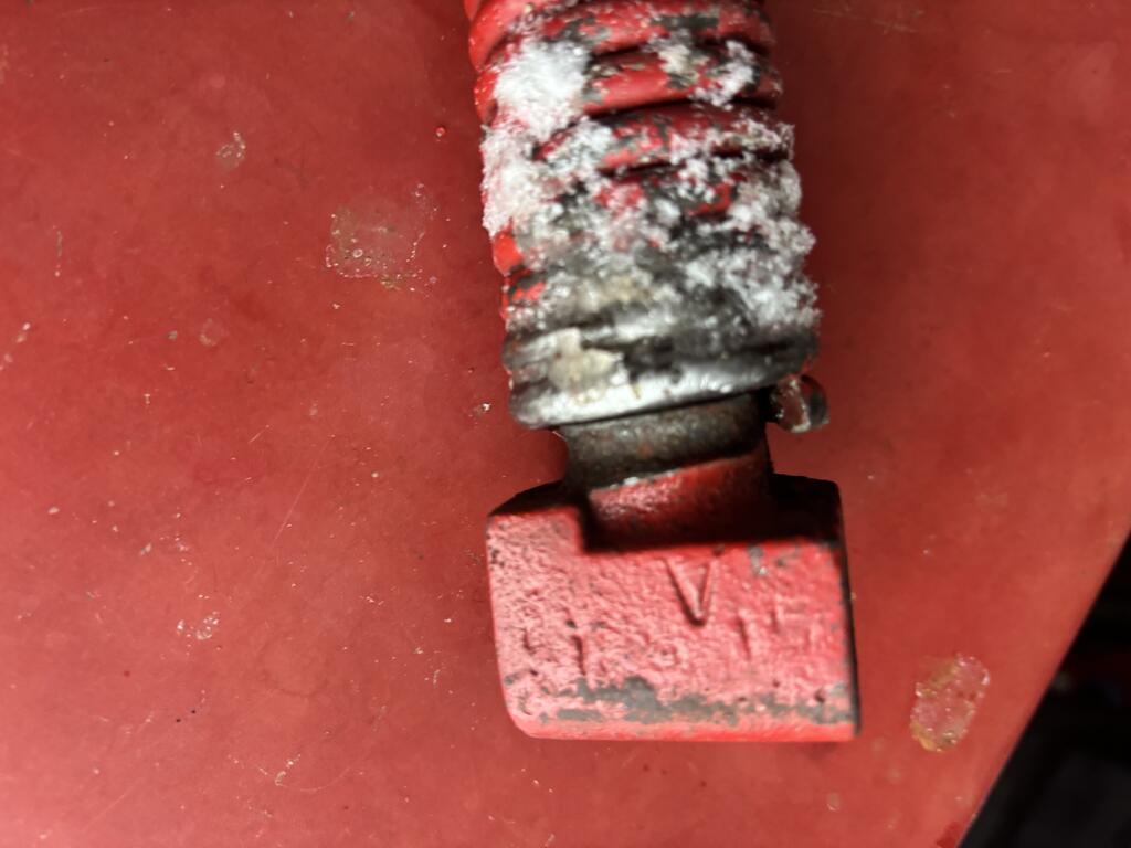

Lane Ranger 11,842 #1 Posted February 16, 2025 (edited) I never knew this until today! I had a snowplow/dozer blade drop down off of the plow. I pulled the pins and placed on top of the tractor to look. I have seen these in the past where the spring broke in half and you either need a new one or welded it. But I never knew the top and bottom cast piece was threaded to go on the spring like a hex nut! 🔩 we had about 3 inches of snow early this am and I cleared my drive and two neighbors. Edited February 16, 2025 by Lane Ranger 5 1 Share this post Link to post Share on other sites
ebinmaine 77,565 #2 Posted February 16, 2025 Yep. I found this a few years ago when I had a new to us pair of springs that were badly corroded snap an end. Share this post Link to post Share on other sites
lynnmor 8,651 #3 Posted February 16, 2025 Those "threads" on the block can wear to the point that the spring can pop off, maybe @peter lena has a grease for that. 3 Share this post Link to post Share on other sites

Handy Don 16,024 #6 Posted February 16, 2025 3 hours ago, Lane Ranger said: top and bottom cast piece was threaded to go on the spring like a hex nut My son had the caps come off on both springs on his plow. The flexing of the springs had worn away metal from BOTH the springs AND the casting. After different attempts to repair, I gave up and got replacements. Attempts: - epoxy (too soft and not good adhesion; lasted for only a couple of plowings) - steel shims a la a helicoil (not enough thread or spring metal left to force new threads; failed quickly) I did not try welding because I doubted I have sufficient skill to persuade spring steel and cast iron to mate. 2 Share this post Link to post Share on other sites
squonk 45,638 #7 Posted February 16, 2025 If it popped off once, it will again. Replace the spring. 4 Share this post Link to post Share on other sites
Wayne0 1,528 #8 Posted February 16, 2025 As a last resort, I would drill the casting and put a bolt through it, spread the coils and screw it back on. Ghetto fix, but it would get you by. Share this post Link to post Share on other sites
Ed Kennell 45,054 #9 Posted February 16, 2025 2 hours ago, Handy Don said: I have sufficient skill to persuade spring steel and cast iron to mate. I have rebuilt the threads on the cast ends by welding. Also welded the cast iron swing arms on the deck side drives. It's not pretty, but can be done. 2 Share this post Link to post Share on other sites
Handy Don 16,024 #10 Posted February 17, 2025 1 hour ago, Ed Kennell said: I have rebuilt the threads on the cast ends by welding. Also welded the cast iron swing arms on the deck side drives. It's not pretty, but can be done. I considered this path but measuring the ID of the springs showed a lot of wear at the end. I figured it’d be tough to get a solid “screw-in” connection. 1 Share this post Link to post Share on other sites
