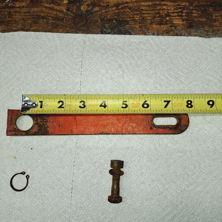

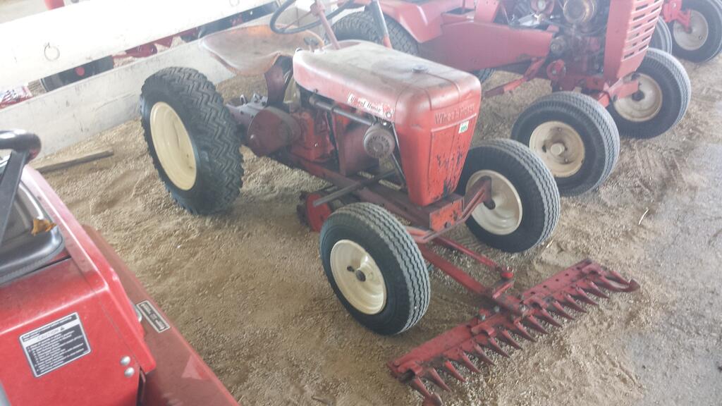

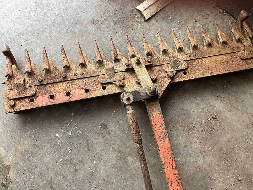

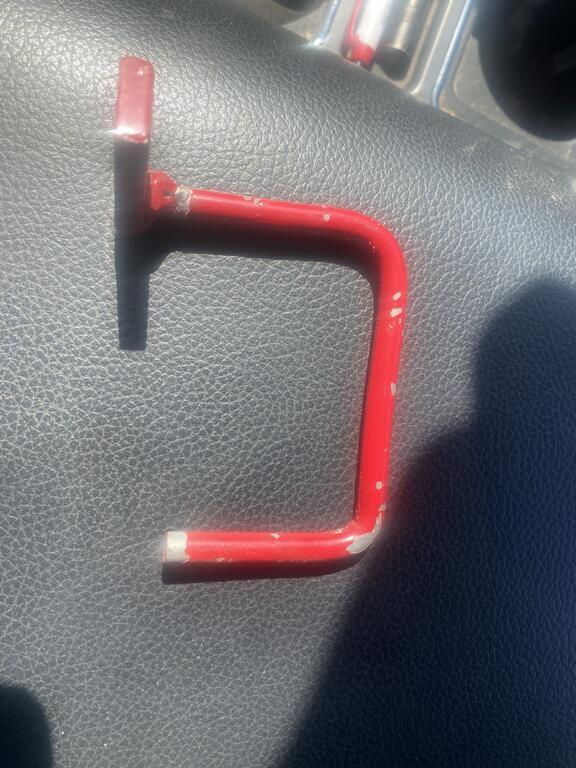

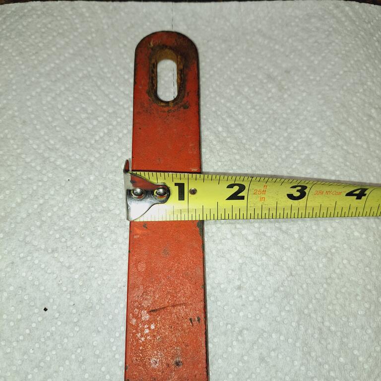

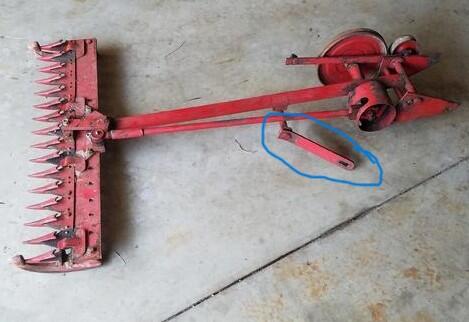

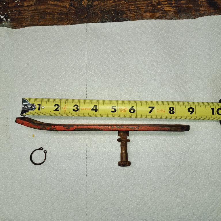

wh315-8 638 #1 Posted January 22, 2025 Borrowed picture to show missing part. Could anyone measure this lift link for me and post it? 1 Share this post Link to post Share on other sites
Racinbob 13,192 #2 Posted January 22, 2025 @Lane Ranger can probably help you out. 2 1 Share this post Link to post Share on other sites
WHX?? 58,135 #3 Posted January 22, 2025 I may have that piece too... will look for ya. @Lane Ranger will have it fer sure but he doesn't see his mentions... he's an old coot ... 2 3 Share this post Link to post Share on other sites

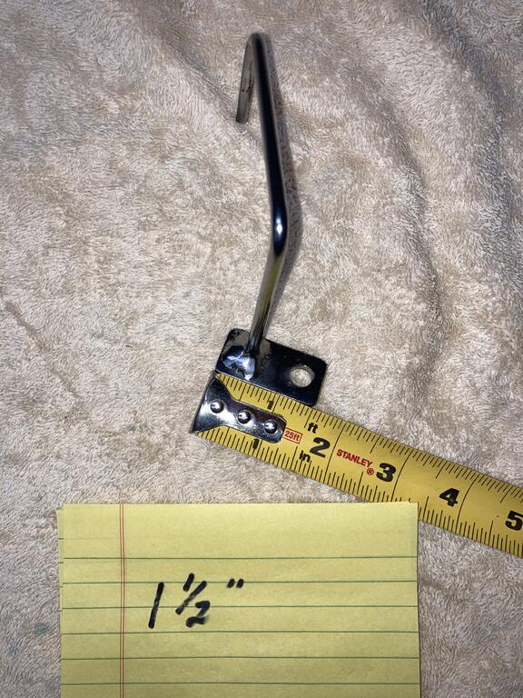

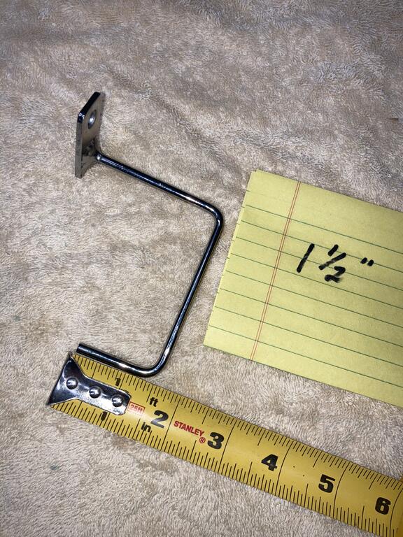

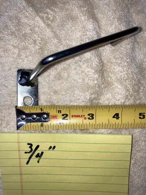

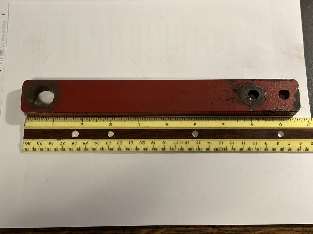

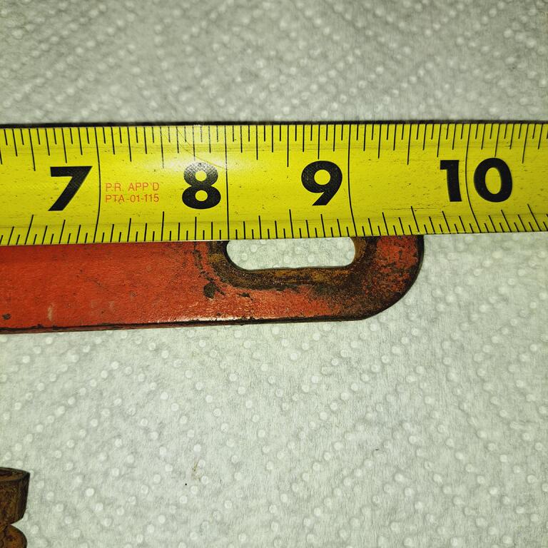

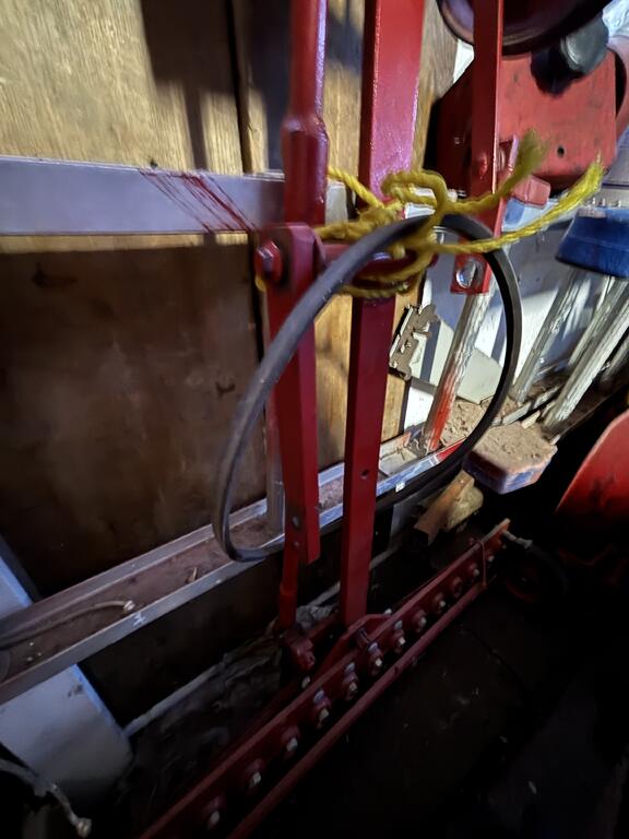

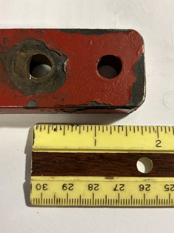

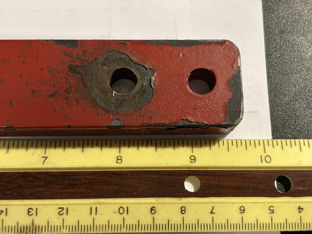

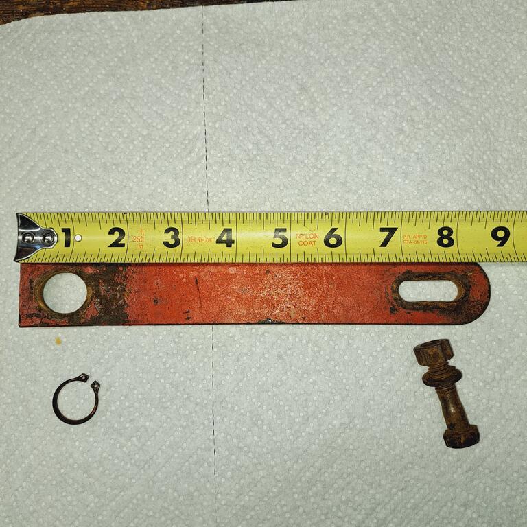

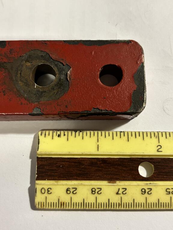

WHX?? 58,135 #5 Posted January 23, 2025 (edited) I'll head out to the magic parts shed tomorrow and take it off for some dims ... too freakin cold out there tonite ... tongue stuck to the door handle. Looks like there is one hanging on it & should be easy to fab one. Edited January 23, 2025 by WHX?? 3 Share this post Link to post Share on other sites
wh315-8 638 #6 Posted January 23, 2025 (edited) Thank You WHX, I will be able to fab one up with the measurements. Whenever you get a chance, I don’t want you to Freeze,🥶 I probably won’t be working on it till late spring anyway.. this is mine, I found the measurements for the engagement pedal on the site just couldn’t find the lift link. Edited January 23, 2025 by wh315-8 Wrong picture 1 Share this post Link to post Share on other sites

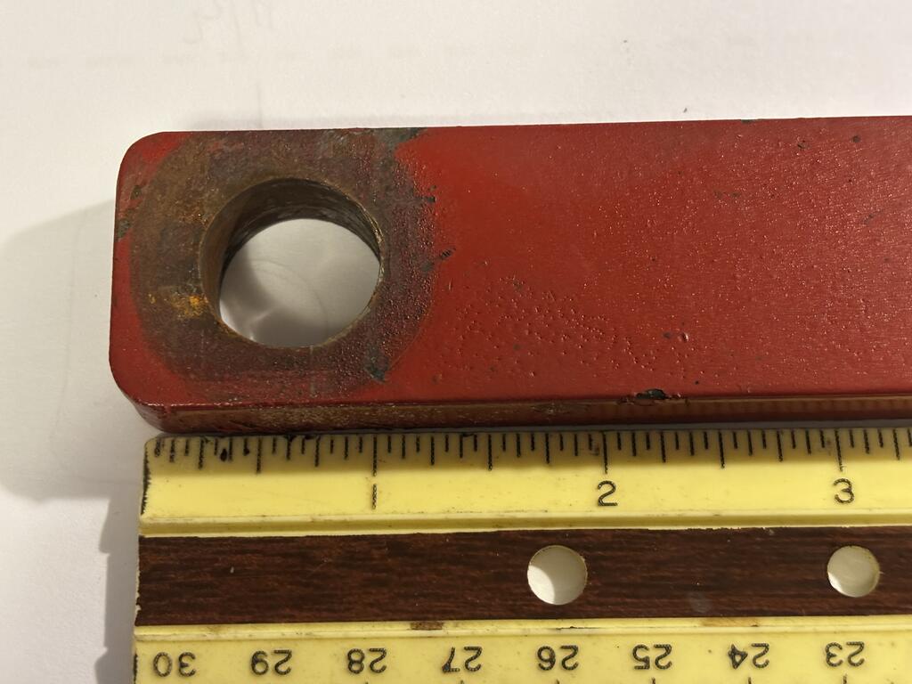

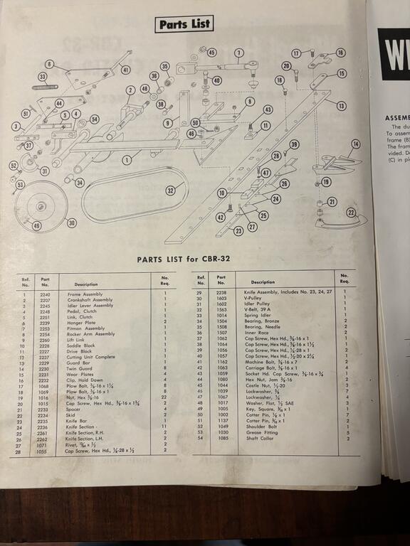

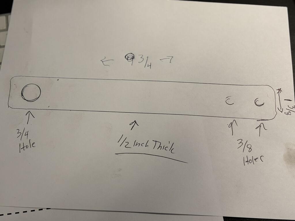

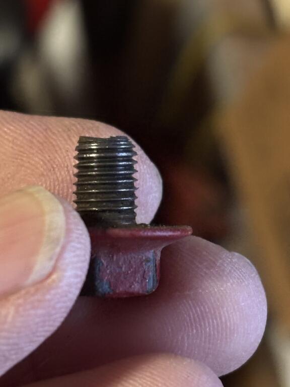

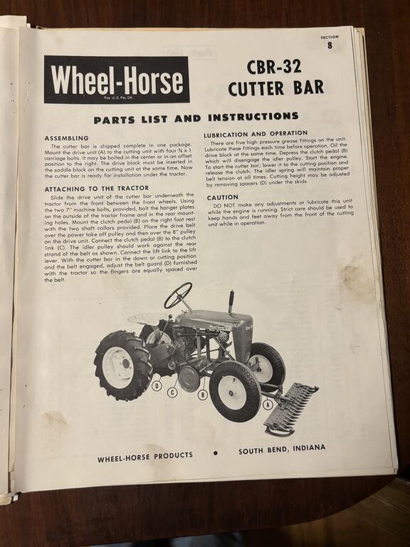

Lane Ranger 12,106 #7 Posted January 23, 2025 (edited) The old coot may be slow but he is sure! And he is not afraid of a little cold weather -you know sub zero stuff! RE: CBR-32. Lift Link. Part 2260. (No 9 in drawing) The hex bolt on the end needs the cap type head fyi secure it too! Also the red/black belt guide is an important piece to make the CBR-32 front cutter bar operate correctly with the clutch pedal on snd off! Denny Clarke posted the dimensions on Red Square when I needed to make one a dozen years ago (as a younger coot)! Note: This piece should not be bent as shown in your pic and Jim’s - it should be flat at the bolt on point!!! Edited January 23, 2025 by Lane Ranger 5 1 Share this post Link to post Share on other sites
WHX?? 58,135 #8 Posted January 23, 2025 (edited) Thank you and interesting Lane. Mine is not held on by a flange bolt but a 3/4" snap ring. I don't believe it has the two holes either. Pics when I get it off today As for the bend I have no idea if it's supposed to be there or not. Note in 315's borrowed pic it appears to have that bend?? I have never mounted mine just layed it underneath a 400 for Portage Show display. Now that 315 has put a bug in my a$$ I will mount it on a RJ-59 or better yet the RJ-35 I am supposed to be working on. Better yet get it working. Edited January 23, 2025 by WHX?? 3 Share this post Link to post Share on other sites
Lane Ranger 12,106 #9 Posted January 23, 2025 (edited) 4 minutes ago, WHX?? said: Thank you and interesting Lane. Mine is not held on by a flange bolt but a 3/4" snap ring. I don't believe it has the two holes either. Pics when I get it off today As for the bend I have no idea if it's supposed to be there or not. I have never mounted mine just layed it underneath a 400 for Portage Show display. Now that 315 has put a bug in my a$$ I will mount it on a RJ-59 or better yet the RJ-35 I am supposed to be working on. Better yet get it working. Yes in the early days things changed at the factory making these items. Not sure if the bolt or snap ring was first. Also the two holes is to allow more adjustment on height of the cut. Could have been changed during production! Mine must be an early one of maybe this part was made after production. The mysteries on the early Wheel Horse attachments are numerous. Make sure you get the belt guid when you mount your front cutter bar. Edited January 23, 2025 by Lane Ranger 1 Share this post Link to post Share on other sites
WHX?? 58,135 #10 Posted January 23, 2025 2 minutes ago, Lane Ranger said: Could have been changed during production! Yes mine appears to have the slotted hole as in the first pic. Share this post Link to post Share on other sites

wh315-8 638 #12 Posted January 23, 2025 Thank You Lane Ralph and WHX for braving the cold and the pictures with measurements. Didn’t know about the belt guide, hope to make these parts and have the CBR32 hooked up for my local shows this fall. Sure it will be a great conversation piece. 1 1 Share this post Link to post Share on other sites

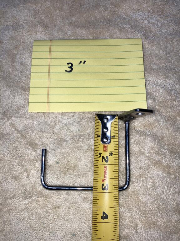

wh315-8 638 #13 Posted January 23, 2025 Found the other link. Don’t know how to link it here but here’s the title: CBR-32 Front Cutter Bar -Belt Guide 1 Share this post Link to post Share on other sites

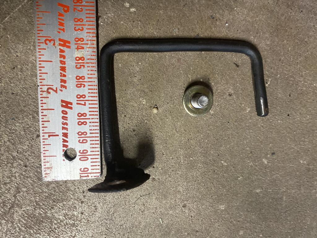

WHX?? 58,135 #14 Posted January 24, 2025 8 hours ago, wh315-8 said: Found the other link. Don’t know how to link it here but here’s the title: CBR-32 Front Cutter Bar -Belt Guide Lost me here 315 ...guessing you are referencing that u shaped hooby doo Lane pictured? Where does it mount got a pic Lane? I do not see it in the IPL. This one is only 1/4" thick. 1 Share this post Link to post Share on other sites
wh315-8 638 #15 Posted January 24, 2025 I figured it out, had to use my desktop to copy and paste. Here it is WHX 1 Share this post Link to post Share on other sites

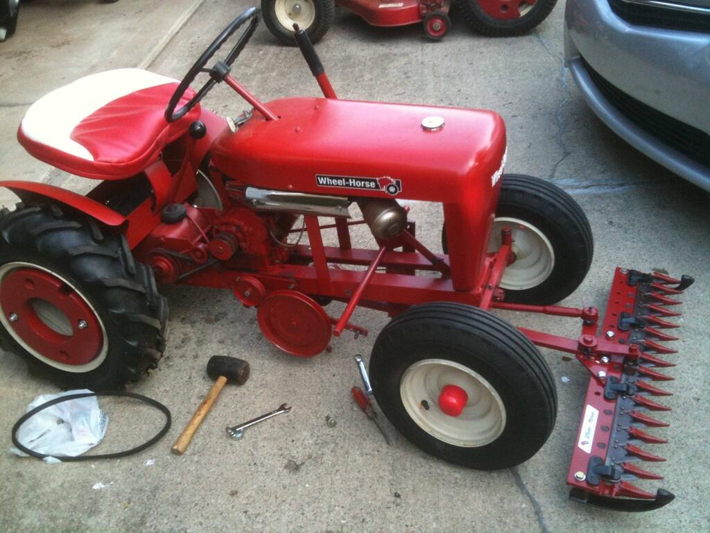

WHX?? 58,135 #16 Posted January 24, 2025 (edited) Thanks 315... I tried copy paste in the search bar but came up empty. Question for Lane ... can this bar be used or fiited on a 701? I may have to lean on you when I get ready to work on it. Edited January 24, 2025 by WHX?? 1 Share this post Link to post Share on other sites
wh315-8 638 #17 Posted February 6, 2025 I just happened to have this popup on YouTube, good video short Lane Ranger.. https://youtube.com/source/tuQmW-JXJqQ/shorts?si=Aqny_pvRa8iV0Tji 1 Share this post Link to post Share on other sites

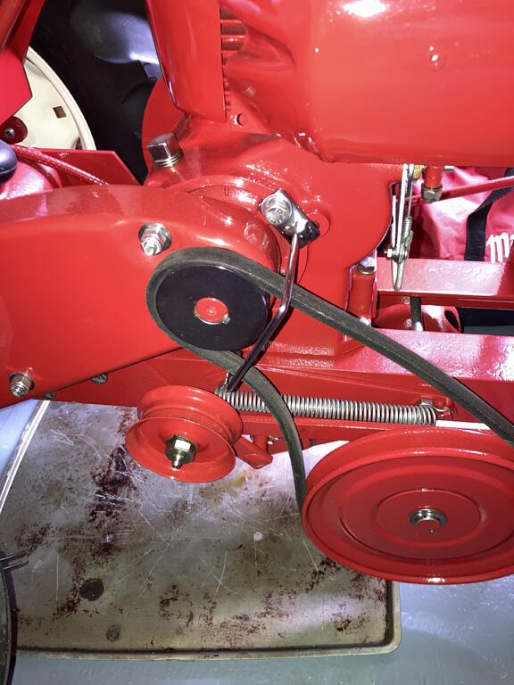

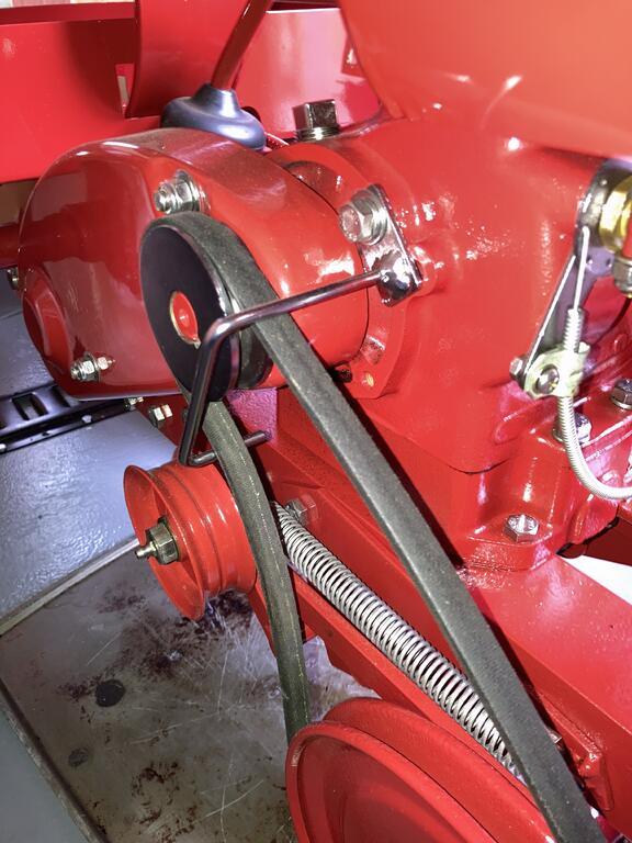

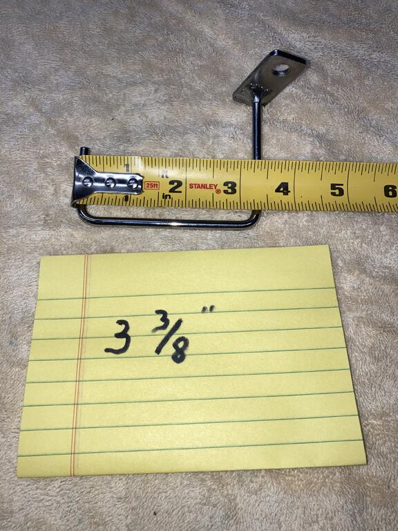

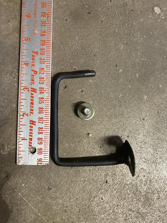

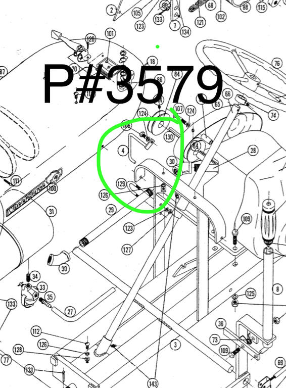

wh315-8 638 #18 Posted February 6, 2025 Item 4, part #3579 belt guard, attachment.. it’s supposed to be part of the tractor, never seen one on a RJ. Guess most people just took them off. 1 1 Share this post Link to post Share on other sites
WHX?? 58,135 #19 Posted February 6, 2025 I see how it works now thanks for the you tube. Guessing the belt guard fits over it? @dclarke 1 Share this post Link to post Share on other sites

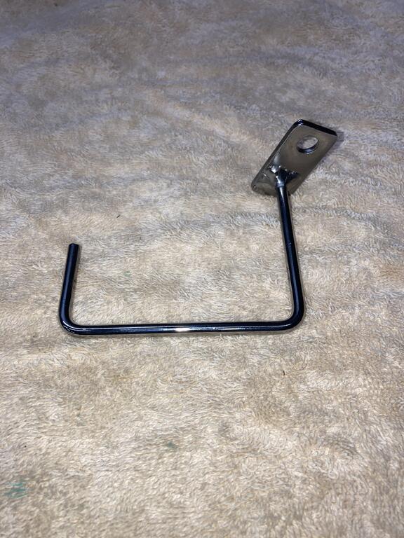

Lane Ranger 12,106 #20 Posted February 6, 2025 1 hour ago, WHX?? said: I see how it works now thanks for the you tube. Guessing the belt guard fits over it? @dclarke Jim and WH315-8: 1) The RJ/Suburban Sickle will not work on a &01. Without a 701 Type Mule Drive in the front attach a magic, You can use an old 32/36 gear driven Mower Deck from attachment rod with the three race pulley and two needle bearings to build a 701 Mule Drive for front cutter bar. 2) The belt guide dimensions are on this site somewhere as Denny Clarke posted them many years ago. We made one of the belt guides that goes with the RJ?Suburban front Cutter Bar. They do help provided smooth operation. 1 Share this post Link to post Share on other sites
dclarke 4,274 #21 Posted February 6, 2025 (edited) I made this 3579 guard for mine and it works well. Edited February 6, 2025 by dclarke 1 3 1 Share this post Link to post Share on other sites
Lane Ranger 12,106 #22 Posted February 6, 2025 Thanks. Denny!! 1 1 Share this post Link to post Share on other sites
WHX?? 58,135 #23 Posted February 6, 2025 Thanks Denny ... pics saved to my sickle folder 2 1 Share this post Link to post Share on other sites

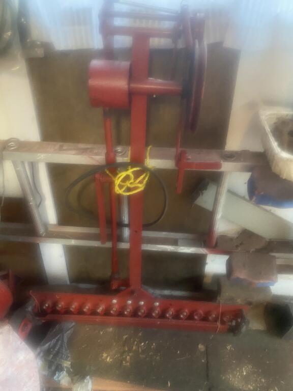

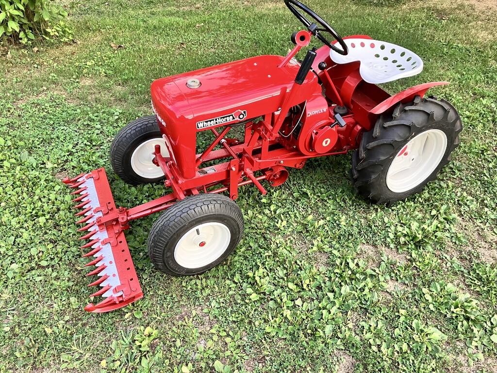

wh315-8 638 #25 Posted August 31, 2025 Got her together, Thanks to the guys here that led me to the measurements for my missing parts. 1 3 Share this post Link to post Share on other sites
