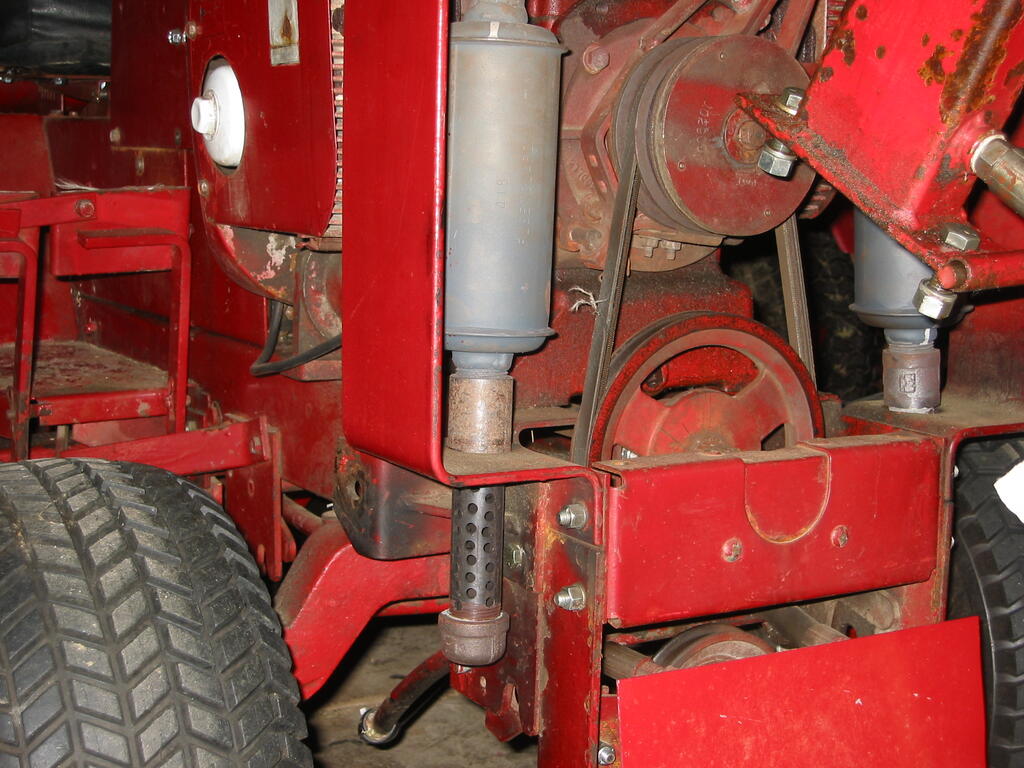

artfull dodger 442 #10 Posted January 12, 2025 I need to get a couple 90' elbows to turn out the exhaust on each muffler, right now it blows straight down which will really stir up dust at the Portland swap meet or anywhere else I ride around that is dusty. She has the replacement mufflers with just a piece of threaded pipe sticking straight down. She is very quiet so want to keep this set up. If all the pipes were not solid rust, I would reroute and turn them into stacks with chrome turnouts. But I think it will stay like they are. Wish I could find a nice stubby chrome pipe to put on each side, like a turndown, Not much out there in this small of a pipe that is chrome though. 2 Share this post Link to post Share on other sites
ebinmaine 81,271 #11 Posted January 12, 2025 3 minutes ago, artfull dodger said: I need to get a couple 90' elbows to turn out the exhaust on each muffler, right now it blows straight down which will..... In a lot of public lands that's illegal. Down pointed exhaust is a viable way to spark a fire. Two of mine point down & forward at a 45⁰ angle. I don't use them on leaf covered ground though. 3 minutes ago, artfull dodger said: Wish I could find a nice stubby chrome pipe to put on each side, like a turndown, Not much out there in this small of a pipe that is chrome though You could make whatever you want out of black iron and have someone powder coat it. 1 Share this post Link to post Share on other sites
artfull dodger 442 #12 Posted January 12, 2025 I agree on them being a fire hazard being pointed straight down. Not my doing. I will point them 90' sideways and slightly angled forward when I get some shop time. To cold right now to mess in my shop much. Gonna be brutal cold in Indiana the next couple days. Hibernation weather! I will use a couple black iron 90' short elbows then a short piece of nipple to make them. I can tack weld them with my mig welder so they dont move or unscrew. I have some chrome sink drain pipe I might be able to sleeve over the nipple and hose clamp it to make it look a bit more dressed up. 2 Share this post Link to post Share on other sites
ebinmaine 81,271 #13 Posted January 12, 2025 1 minute ago, artfull dodger said: chrome sink drain pipe Actually that's an excellent idea! My stack on the Cinnamon Horse C160-8 is exactly that. I found a metal P trap half piece years ago. Cut it to the angle I wanted at the top. 1 Share this post Link to post Share on other sites
Achto 32,960 #14 Posted January 12, 2025 @artfull dodger & @ebinmaine stainless grab handles from a bathroom stall make excellent exhaust pipes too. 2 1 Share this post Link to post Share on other sites
pfrederi 21,342 #15 Posted January 13, 2025 The original mufflers aimed straight down however they were capped. and the nipple between the muffler and the cap had holes drilled in it. I used some B&S mufflers on my D aimed straight down... it left a few dead spots on the grass so i put nipples and caps on it with a bunch of 1/4" holes drilled in the outer third of the nipple just like the original. I don't like stacks blowing exhaust at face level. 2 1 Share this post Link to post Share on other sites
ebinmaine 81,271 #16 Posted January 13, 2025 32 minutes ago, pfrederi said: I don't like stacks blowing exhaust at face level 8 hours ago, artfull dodger said: I would reroute and turn them into stacks with chrome turnouts. Paul brings up an excellent point. Having exhaust blow back at you is NOT good. My Cinnamon Horse C160-8 has a VERY tall stack. It's good for driving around. It is However... not that great for operation of the chipper shredder that lives on it. I'll be replacing that stack with a straight up piece and a flapper. 1 Share this post Link to post Share on other sites
artfull dodger 442 #17 Posted January 13, 2025 (edited) Mine will point outwards at an angle so forwards and at an angle. Cant be worse that the IH cubs that exhausted straight out the grill. I just dont want it blowing straight down kicking up dust. Even the factory exhaust on the Onan on my 416h will get blown back at me sometimes. No big deal and it does not bother me. A wiff once and awhile lets me know how the engine is running by its scent. After 25+ years of wrenching on them professionally, I can tell when its lean, rich or starting to burn oil long before I see blue smoke. I never cared for the "pepper pot" pipe set up on the stock original mufflers. When I did stacks, I never had them at face level, to much exhaust in my face. I will take pics of my solution in a couple days. Gotta go to the hardware store as I dont have any elbows on hand. The idea is to keep her quiet as she is now. Less I have to wear my headset while running the beast. Edited January 13, 2025 by artfull dodger 1 Share this post Link to post Share on other sites
