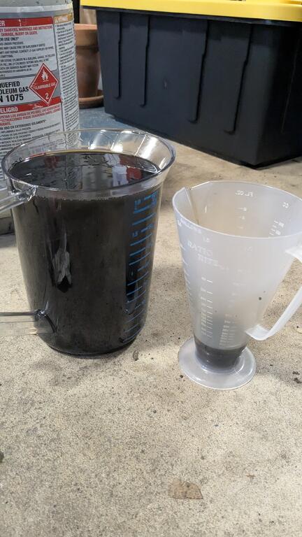

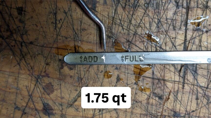

Alrashid2 476 #6 Posted January 19, 2025 (edited) UPDATE! Sorry guys, I have been sick with the flu all week so didn't get a chance to get back to you guys or even do much to the tractor. Finally got sick and tired of being sick and tired and pushed myself to get back in the garage. I know blowby can't be fixed without an engine rebuild, but in the past I have been able to reduce it by using thicker oil. Likewise, I have seen cases with other small engines where the piston rings get suck and allow some blowby, and can sometimes be loosened back up. So, I did a few things: I pulled the spark plug and using a plastic pipette, placed about half an ounce of Marvel Myster Oil on top of the cylinder. I let that soak overnight before starting the tractor. For the hell of it, I also poured 2 oz of MMO into my 2 gal fuel tank and ran that through after too (made the exhaust smell sweet!) I drained my oil (10w30 basic Walmart brand oil) and replaced it with Rotella T4 15w40 diesel oil. I had read good things about the Rotella T4 with helping with blowby and burning oil, and likewise I think the 40w will help a bit with blowby at running temps. While changing the oil, I drained the old oil into precise measuring cups and measured that, after all the oil I lost during my last plowing session, I still drained out 72 oz which is 2.25 quarts... that tells me I was definitely overfilled before. This time around, I filled with just 1.75 quarts of the Rotella T4 15w40 oil. This put me about halfway between the Add and Full marks. Just to be safe, I pulled the carb and took apart the breather assembly. Everything was put together correctly, except that I noticed that one of the two gaskets was ripped. I doubt this would have caused my issues but I replaced the gasket with a new one. Well, today we got the most snow we've gotten since I bought my Wheel Horse - 4 inches! I plowed the driveway as I have and it performed beautifully. Once I was done, about an hour later, I parked her and popped the hood - NO OIL LEAKAGE! The engine face looked a bit wet but I believe that was just from snow hitting the engine and melting - wiping my finger it just felt damp, not oily. As far as I can tell, I had zero blowby or oil leakage during this session of plowing, with the engine under heavy load plowing uphill. I'm hoping that my "blowby" was really due to thin oil and being overfilled... but time will tell. I'm happy though! Edited January 19, 2025 by Alrashid2 Share this post Link to post Share on other sites
squonk 47,419 #7 Posted January 20, 2025 Over filling will cause the oil to get whipped into a foamy, frothy mess and can easily overwhelm the crankcase breather system. Share this post Link to post Share on other sites
oliver2-44 11,632 #8 Posted January 20, 2025 44 minutes ago, squonk said: Over filling will cause the oil to get whipped into a foamy, frothy mess and can easily overwhelm the crankcase breather system. Share this post Link to post Share on other sites
lynnmor 8,914 #9 Posted January 20, 2025 On January 8 I tried to tell you that the oil pan is special and the capacity would be 1 to 1.75 quarts. Share this post Link to post Share on other sites
Alrashid2 476 #10 Posted January 20, 2025 1 minute ago, lynnmor said: On January 8 I tried to tell you that the oil pan is special and the capacity would be 1 to 1.75 quarts. Thanks @lynnmor - my engine does have the A label but it looks like it was repurposed with the larger oil pan for Wheel Horses. Regardless the 1.75 it seems to be working well so far Share this post Link to post Share on other sites
