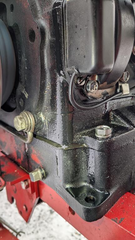

Alrashid2 476 #26 Posted January 7, 2025 Here is what I have on my phone, let me know if this suffices ! Oil drain plug on bottom left side of photo Share this post Link to post Share on other sites
rmaynard 17,612 #27 Posted January 7, 2025 That looks like a standard pan (4 pints). 1 1 Share this post Link to post Share on other sites

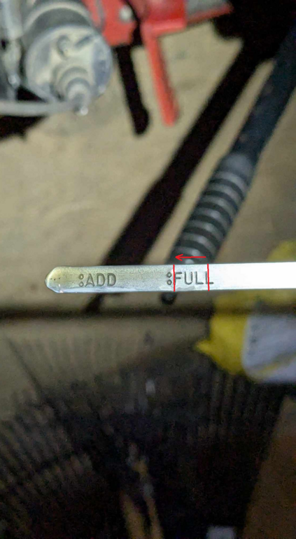

Alrashid2 476 #35 Posted January 8, 2025 Side question for you guys - anyone know how much oil it takes to go from the Add to Full lines on the dipstick? After rechecking, I now see that my oil moved about from the L in FULL to between the : and F on the dipstick after running for 1 hour under heavy load, and appearing to lose a lot of oil (but was just messy and really didn't lower it all that much it seems). If this holds true, I could run another 3 hours before needing to top off, but I'm not sure how much oil would be in the crankcase at the ADD mark Share this post Link to post Share on other sites
OutdoorEnvy 1,817 #36 Posted January 8, 2025 I would guess around 1/2 quart or so. You could try running it not completely at the Full mark. Maybe half way or less to the Full line, like in the Add word range and see if it leaks. It might have like an 1/8-1/2 quart too much. As long as you aren't below the Add line you should be safe to run it. Just keep an eye on it more in case it burns a little bit. Share this post Link to post Share on other sites
Alrashid2 476 #37 Posted January 8, 2025 Thanks @OutdoorEnvy. I'll experiment with running it lower on oil, see if the blowback effects change at all. If not, then I rather run it slightly overfill just to avoid ever accidentally running it on low. Share this post Link to post Share on other sites
pfrederi 21,215 #38 Posted January 8, 2025 You only fill it to the two dimples just to the left of the word full (the word full should not be in the oil) 2 Share this post Link to post Share on other sites
