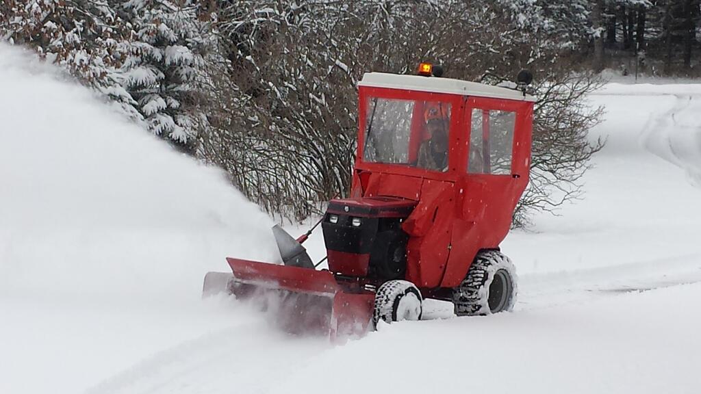

rmaynard 17,494 #6 Posted January 2, 2025 When I had a snow blower years ago, it was a short chute. I found that in heavy snows it would clog occasionally. I can't imagine how much more a tall chute version would clog without some sort of secondary assistance. I think that Bob "Duke" Davis @HorseFixer modified his Ultimate Snow Chucker various times to get more volume and distance. I'm sure if you search Ultimate Snow Chucker you should be able to see what he did. Share this post Link to post Share on other sites
