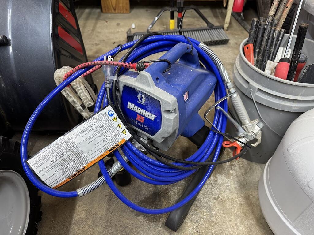

Bar Nuthin 3,115 #12 Posted December 26, 2024 (edited) In addition to what's already been said... Use disposable 5-gallon bucket liners - so you can strain your paint rather than spraying directly from the pail it comes in. (fewer tip clogs) Thin your paint only if (and as much) as required Practice on a section on the ground to get the right viscosity and spray pressure - that way you can fix any flaws and get prepared for ladder work where you only get one chance The spray gun extensions are useful to cover more area at a time, but can be a bit awkward - especially clearing clogged tips on a ladder Be prepared to get coated with overspray/blowback - including eyeglasses (if you wear them) Have some spare buckets for purging the line and general cleanup - also some cheap brushes and rags It takes more solvent (or water) to flush the lines than you expect. Whenever I'm stopping for more than a few hours or permanent - I flush enough Mineral Spirits to clear the line and leave it in the gun and line. Most importantly, use PPE and work safe! Here's the Graco sprayer I have. It always performs well and being a brand name, parts and accessories are available Edited December 26, 2024 by Bar Nuthin add photo 1 1 Share this post Link to post Share on other sites
