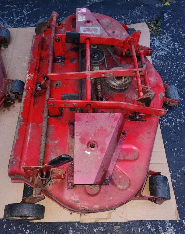

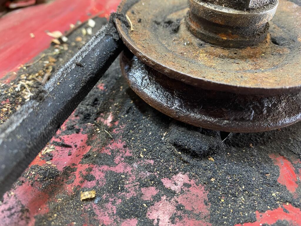

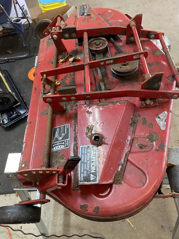

Sparky-(Admin) 26,380 #1 Posted December 25, 2024 Bought this 42” RD this fall, only used it twice and it seems to be eating the belt. Investigating I have discovered that all the pulleys are severely corroded and the belt groves are shot. I think the rough surface is destroying the belt. Spindles run quiet though. Never removed this type of pulley before, they aren’t cast so I can only assume a 3 jaw puller would bend em up. Any tricks? 1 Share this post Link to post Share on other sites

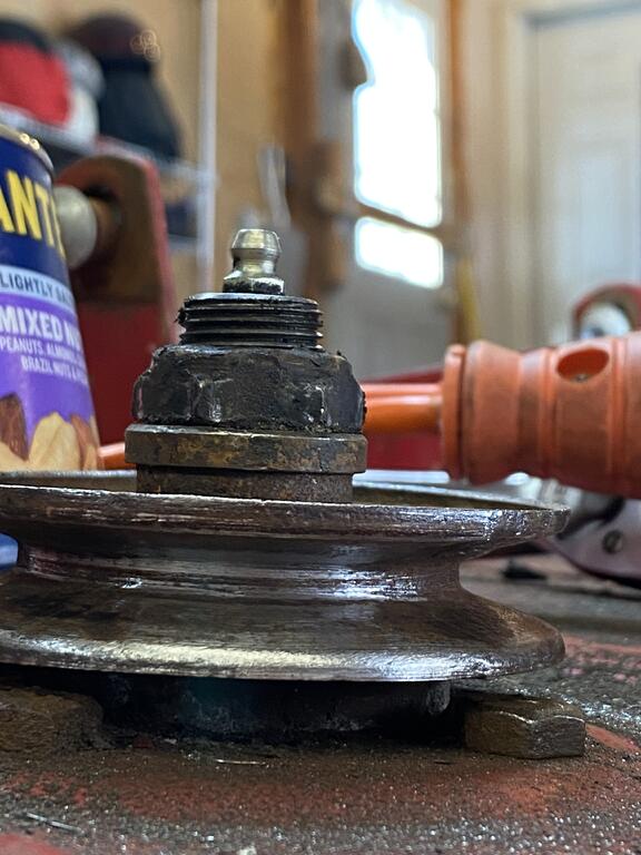

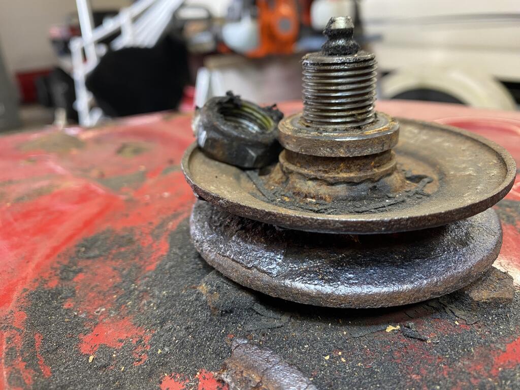

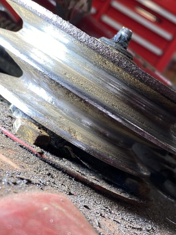

Sparky-(Admin) 26,380 #9 Posted December 25, 2024 Long story short…this deck cuts well and the spindles are quiet, but these nasty pulleys are destroying the belt. Decided to try and clean up the pulleys. First I chisled off the large chunks of rust, then did some heavy wire wheeling. They seem to be ok now. Will know better when I order a new deck/spindle belt and probably a new idler pulley ( @76c12091520h ) for it and spin it up. 3 1 Share this post Link to post Share on other sites
squonk 48,132 #10 Posted December 25, 2024 That one looks a bit nasty. 1 Share this post Link to post Share on other sites
Sparky-(Admin) 26,380 #11 Posted December 25, 2024 48 minutes ago, squonk said: That one looks a bit nasty. It’s still a bit nasty…but much better than it was. 1 Share this post Link to post Share on other sites
SylvanLakeWH 32,558 #12 Posted December 25, 2024 Run em now and see what happens... I'd try to smooth off that one @squonk noted a bit more... (Inflation) 1 Share this post Link to post Share on other sites
Sparky-(Admin) 26,380 #13 Posted December 25, 2024 1 hour ago, SylvanLakeWH said: I'd try to smooth off that one @squonk noted a bit more... (Inflation) Yeah, tomorrow I’ll attack that pulley again. I have like 4 months before I need this deck 1 1 Share this post Link to post Share on other sites

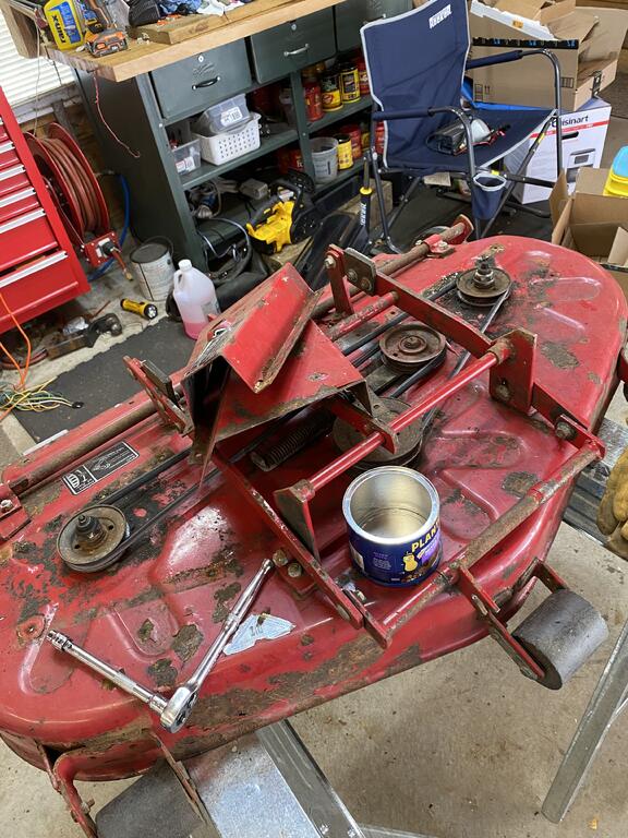

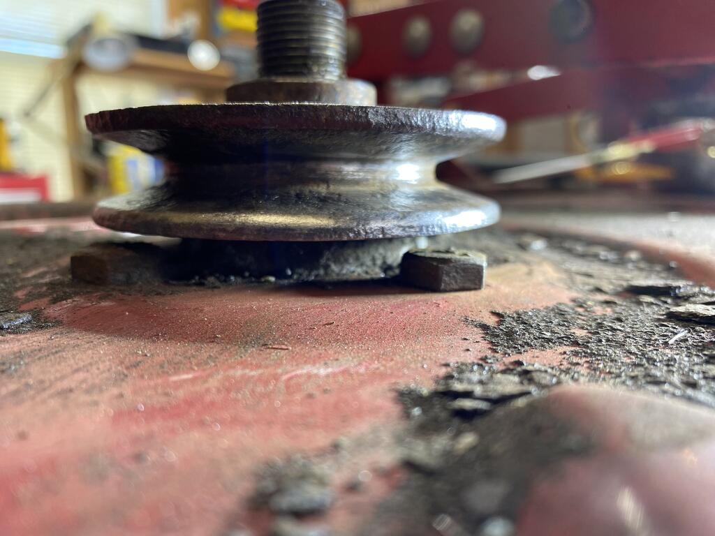

peter lena 10,070 #15 Posted December 25, 2024 @Sparky those decks are cake to refit , those pulleys easily remove with 2 WONDER BAR , pry bars , NEVER USE A PULLER ON A PULLEY ! been trying to find my write up on that , done years ago , there are bolts under the pulleys , remove top pulley nut , use 2 wonder bars , 90 deg bend , under pulley , sitting on TOP OF DECK BOLT , and up against pulley center mount , strongest point of angular advantage, push pry bars OUTWARD ,AWAY from pulley , lifts right up , also a great time to re fit new bearings , with lucas 550 drop point green chassis grease , have 3 decks with this set up , no noise or failures . notice thin space of pulley to deck bolt ? thats your wonder bar leverage advantage, pulleys lift right off , no damage . pete 1 Share this post Link to post Share on other sites

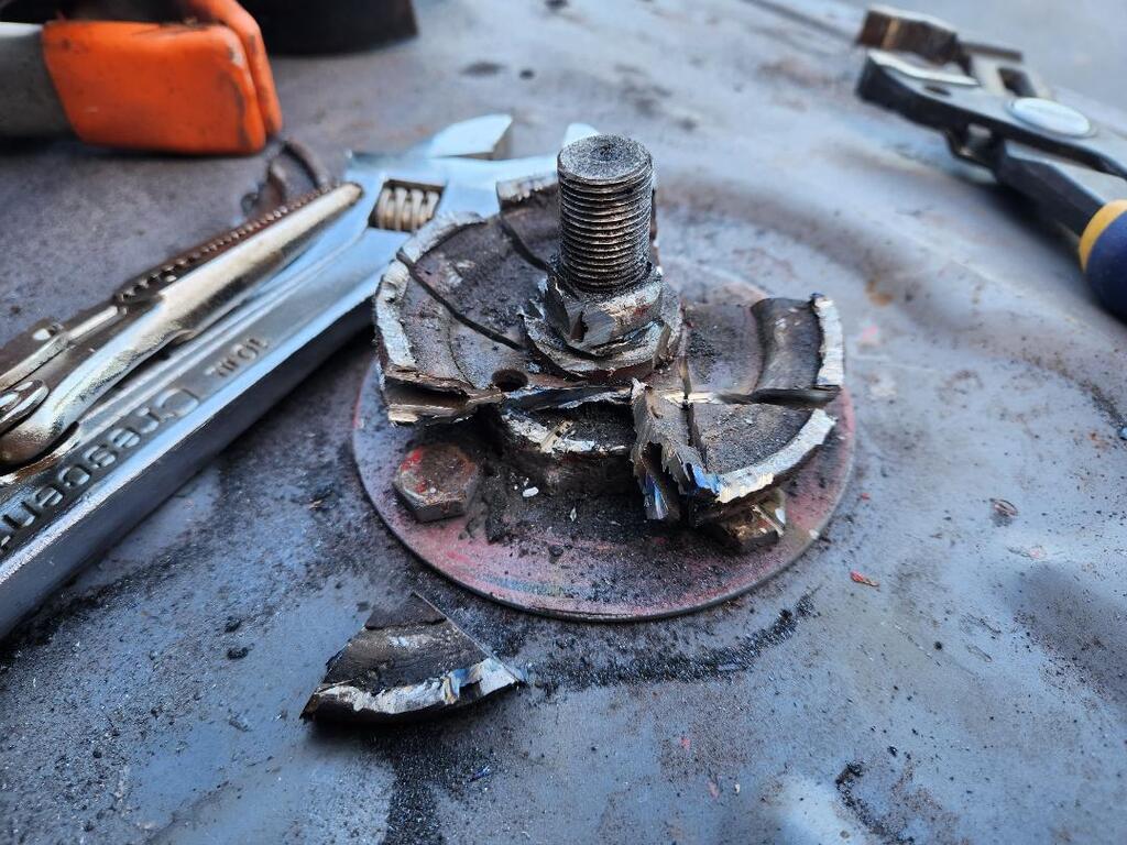

Brockport Bill 2,478 #18 Posted December 26, 2024 i had started a similar thread last year asking for help to remove frozen pulleys on a 42 rd deck left out in weather that i obtained and wanted to rescue and rehab - - i tried every suggestion made from R Sq members - penetrating oil for a week - heat - pry bars etc -- nothing worked thus only solution left was cutting off - - see photo... Certainly frustrating having to buy 2 new pulleys but the end result was a nice rehabbed deck should last for years - - good luck 1 1 Share this post Link to post Share on other sites
Sparky-(Admin) 26,380 #19 Posted December 26, 2024 You can see on the idler pulley mounting bar how much it was jumping by the shiny section. After cleaning up all the pulleys it’s riding so much nicer! Still going to get a new belt and replace the idler, it’s just a bit noisy, before she goes back into service Share this post Link to post Share on other sites
