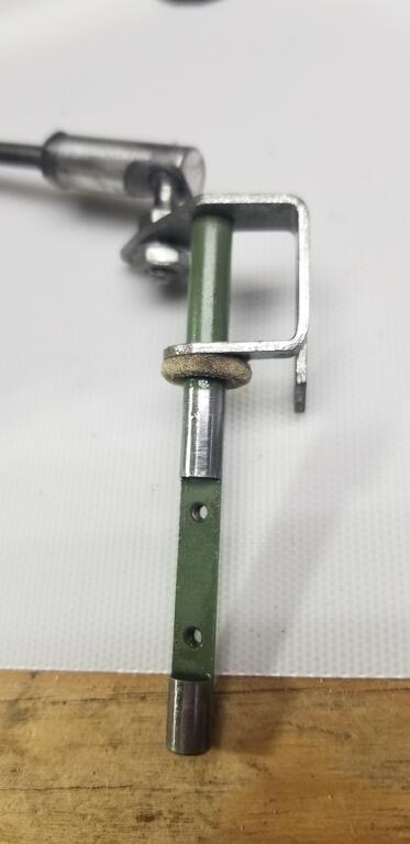

ebinmaine 79,716 #28 Posted December 22, 2024 @Bar Nuthin I have a needle here. Pop yours out and look at the configuration of holes. 1 Share this post Link to post Share on other sites

Bar Nuthin 2,637 #30 Posted December 22, 2024 2 hours ago, ebinmaine said: @Bar Nuthin I have a needle here. Pop yours out and look at the configuration of holes. May be a short wait- working out of state tomorrow. Thanks a ton! 1 Share this post Link to post Share on other sites

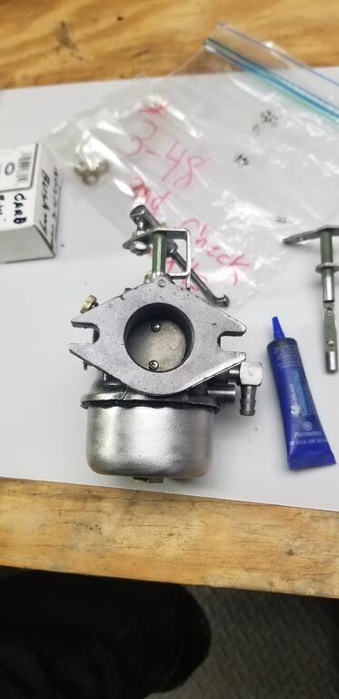

siebenaler 114 #36 Posted December 31, 2024 Just wondering where you found the 3/48 steel screws I'm looking? Mines a carter model n on a k181 engine. 1 Share this post Link to post Share on other sites
ebinmaine 79,716 #37 Posted December 31, 2024 11 minutes ago, Mark siebenaler said: Just wondering where you found the 3/48 steel screws I'm looking? Mines a carter model n on a k181 engine. I believe it was Bolt Depot in Hingham MA. K. L. Jack also sells them. PM me your address and I'll send you a few. Share this post Link to post Share on other sites

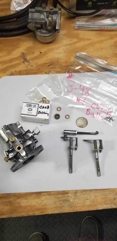

gt14rider 1,245 #39 Posted April 10, 2025 Big thank you to Eric (Ebinmaine), he sent me some #3-48 screws to finish up a rebuild on my carb. Had to swap out the throttle shaft off a parts carb. Will have to drill and tap broke off screw in old shaft. 1 1 Share this post Link to post Share on other sites
ebinmaine 79,716 #40 Posted April 10, 2025 Niiiiice! Glad to help. 1 Share this post Link to post Share on other sites
