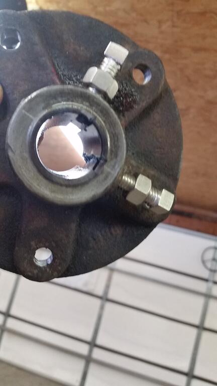

ebinmaine 80,745 #4 Posted December 20, 2024 Niiiiice save! On that hub, some folks can cut a new groove in them. @WHX?? may be able to comment here. Carefully check the carb for throttle shaft wear. Remember to utilize the "New to the Herd" thread. Excellent tool there. 4 Share this post Link to post Share on other sites

OutdoorEnvy 1,817 #6 Posted December 20, 2024 37 minutes ago, ebinmaine said: Niiiiice save! On that hub, some folks can cut a new groove in them. @WHX?? may be able to comment here. Carefully check the carb for throttle shaft wear. Remember to utilize the "New to the Herd" thread. Excellent tool there. Yeah that's a great thread! I'll inspect it. I have cleaned the carb already and it was pretty clean all in all. The throttle cable had been broke off at the lever but I think I have saved it but cutting a few inches off the metal tube and putting a new Z-bend in it. It barely reaches but does, we'll see over time how it does. The choke cable was seized but a few days of penetrating oil soaking and it has freed up. The gas tank has old gas that I'll need to clean out and already have new fuel lines and filter ready to be put on. 1 Share this post Link to post Share on other sites
WHX?? 58,157 #7 Posted December 21, 2024 (edited) 4 hours ago, ebinmaine said: On that hub, some folks can cut a new groove in them. @WHX?? may be able to comment here. Oh yeah totally fixable... Edited December 21, 2024 by WHX?? 5 Share this post Link to post Share on other sites
ebinmaine 80,745 #8 Posted December 21, 2024 10 hours ago, WHX?? said: Oh yeah totally fixable... I found a few I should send you sometime. 1 Share this post Link to post Share on other sites
ebinmaine 80,745 #9 Posted December 21, 2024 @WHX?? Anyone here on Redsquare putting full length hub key grooves in axles? Share this post Link to post Share on other sites

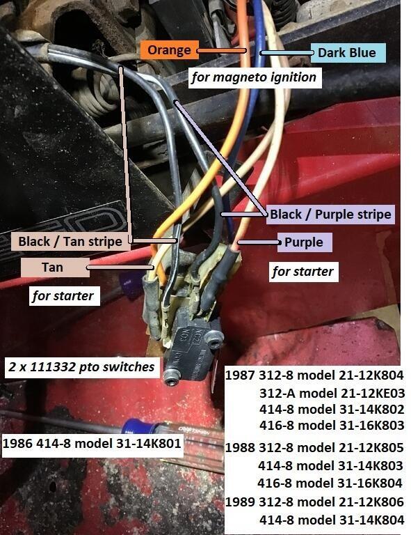

953 nut 69,374 #10 Posted December 21, 2024 20 hours ago, OutdoorEnvy said: If anyone has a pic or knows which of these 3 wires goes where that would be most helpful! Looking at the photo from our manuals section posted below I think those wires were once connected to the PTO switch. The smaller black with a tracer color wires would go to the idiot lights. Your starter solenoid signal feed passes through the low oil level relay, it is probably a metal can relay. There is a five wire connector (with only four wires) that goes to your engine, two of these wires will activate the relay on low oil level. If you unplug this connector for testing purposes it will take the low oil switch out of the equation. The other two wires are an ignition kill wire and a charging system wire and won't interfere with the solenoid signal. I will follow along to see what you find. 3 Share this post Link to post Share on other sites
kpinnc 18,969 #11 Posted December 21, 2024 10 hours ago, ebinmaine said: Anyone here on Redsquare putting full length hub key grooves in axles? My Bronco has them. I wish I had a mill and could do it myself. So much better than woodruff keys! I would make every axle I have use standard key stock. Another benefit is that penetrating oil could actually reach into the hub if the keyway was visible. 3 1 Share this post Link to post Share on other sites
OutdoorEnvy 1,817 #12 Posted December 24, 2024 Success! Well after more hours than I'd care to admit to of probing around I think I finally figured it out. So in the pic below of the PTO Switch the prong that is bare is what the purple striped wire set was connected to. I was not getting signal from that when key was in the start position. I had traced the signal through the low oil sensor to the relay and at the PTO Switch. But no signal was making it to the clutch switch. So after probing around I realized the bare prong beside it was getting signal when the key was in the start position. So I switch the purple wires to that one and I have start signal all the way to the solenoid wire. So I guess someone switched these at some point? That's my best guess as there are no other wires that are not connected. So the push button in the last pic is removed and I think we are back to a functioning electrical system with the key switch and all safety switches still connected. Outside of the ugly hole by the throttle lever I think we are in a good position going forward. Next up I am waiting on parts to arrive. I need to replace the axle seal and get the new good hub on so I can wheel it out for a wash. Then we have a clutch pulley, drive belt, and other engine tune up and maintenance to do like the gas tank cleaning and new fuel lines, etc. Parts can't arrive soon enough! 2 1 Share this post Link to post Share on other sites
