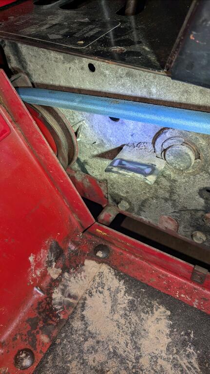

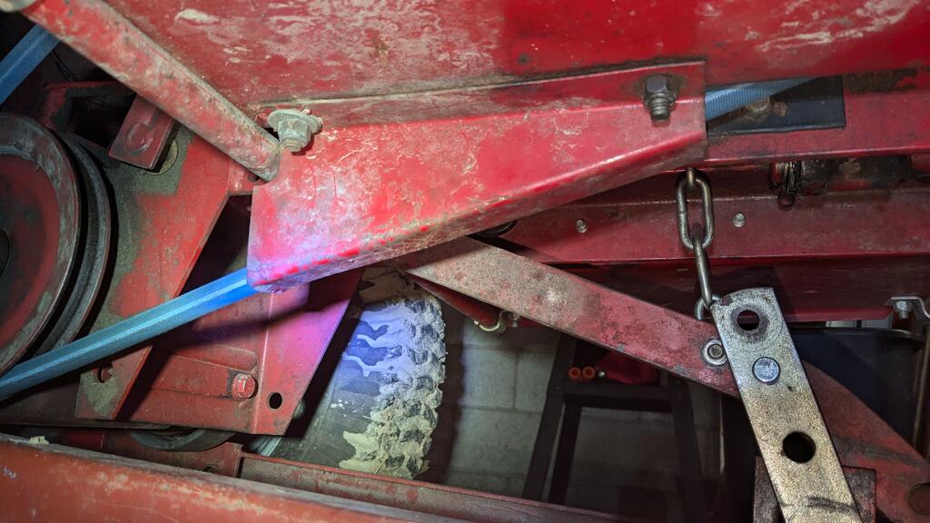

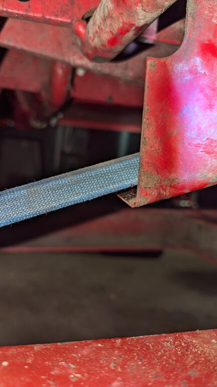

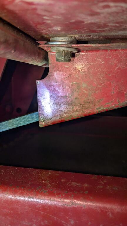

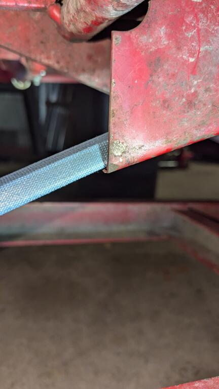

Alrashid2 476 #16 Posted December 18, 2024 So, picture time! I'll try to outline what i see. Not finding any answer anywhere on what clearances are normal so some help would be great... Even if one of you could look at one of your 300 series horses. Thanks guys Going to make a few replies in a row to explain what is what. 1. Belt guard at bottom left rear axle pulley: definitely touching on the left side, while there is at least a half inch gap on right side where it exits. The angle of the guard doesn't match the angle of the belt. Should I bend this guard? Or maybe add some spacers between the guard and bolts to add some clearance? Share this post Link to post Share on other sites

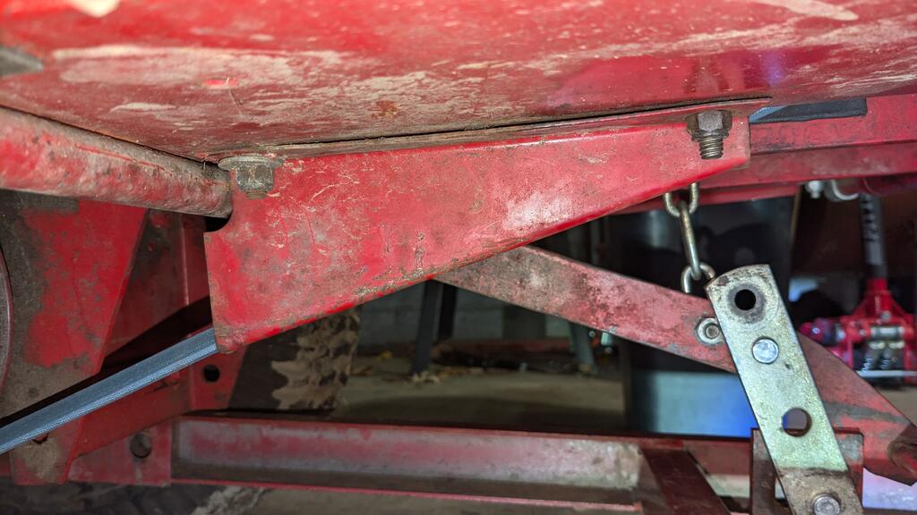

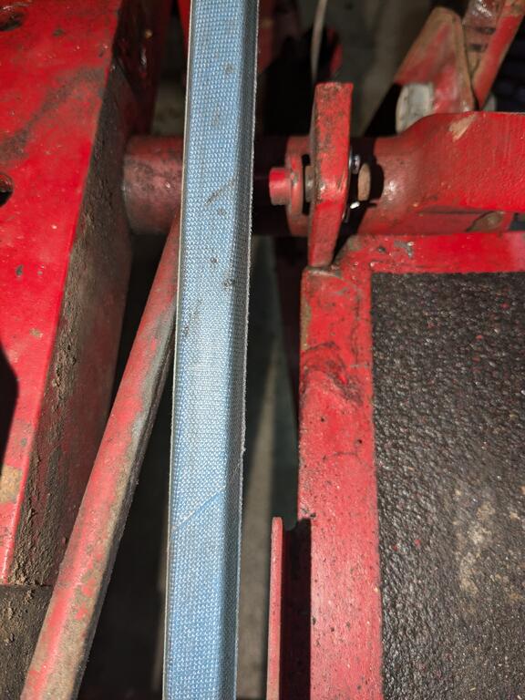

Alrashid2 476 #17 Posted December 18, 2024 2. Wire guards x2 near drive pulley: when clutch engaged, there's around quarter inch of clearance on top guard and a half inch on bottom guard. When clutch is disengaged (pedal down) though, belt touches both of them. Not sure if that is how they are supposed to act though. Share this post Link to post Share on other sites

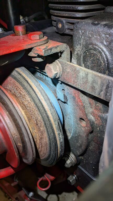

Alrashid2 476 #18 Posted December 18, 2024 3. "Guard" to right of clutch pulley: shiny and blue. Not sure if that's normal though. Share this post Link to post Share on other sites

953 nut 68,500 #20 Posted December 18, 2024 13 minutes ago, Alrashid2 said: 12 minutes ago, Alrashid2 said: "Guard" to right of clutch pulley: shiny and blue. Normal 18 minutes ago, Alrashid2 said: definitely touching on the left side, while there is at least a half inch gap on right side where it exits. The angle of the guard doesn't match the angle of the belt. Should I bend this guard? A bit of a downward tweak couldn't hurt. When clutch is disengaged (pedal down) though, belt touches both of them Normal 1 Share this post Link to post Share on other sites
Alrashid2 476 #21 Posted December 18, 2024 (edited) Thanks for looking @953 nut. Sounds like my only issue then is the belt guard on the bottom left... seems weird to me it'd throw dust all the way over to the drive pulley but what do I know! Just to confirm, the belt is NOT supposed to touch that guard? EDIT: ended up putting a few thick washers as spacers between the guard and frame on the back bolt. Now the belt does not touch the guard! Edited December 18, 2024 by Alrashid2 2 Share this post Link to post Share on other sites

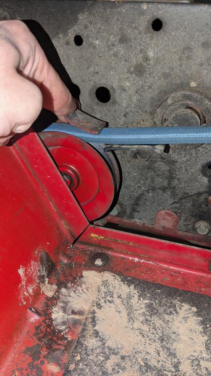

Alrashid2 476 #22 Posted December 18, 2024 NEW UPDATE: I think I figured out where the dust is coming from, but I found another issue in result ha... go figure! 1 hour ago, 953 nut said: Your drive pulley turns counter clockwise and the pattern of the "Blue Dust" leads me to think the heavy wire belt guide on the engine is contacting the back of the belt. @953 nut you were right. When the engine is off, clutch engaged, the belt doesn't touch that Heavy Wire Belt Guide. However, with the engine running, the belt is flopping up and down and definitely rubbing the back of the belt. I think that is what was creating the dust and whipping it around the drive pulley. So, I loosened the bolt there and just slightly moved that Wire Guide downward. However, once I do that and the belt doesn't touch the guide when running any longer, now I get a very loud SQUEAL when pushing the clutch pedal in. I can hear it with engine at full throttle and with ear plugs in! Push it in, squeals. Let go, nothing. Push again, squeals. Hell, if I hold the clutch pedal down midway, it'll just continue to squeal until I push it all the way down or let off. When I push the Wire Guide back up, squealing stops. It's definitely coming from the drive pulley area - any idea what that is? Not sure if I should put the guide back tight and let it rub or give it clearance and deal with the squeaking? Share this post Link to post Share on other sites

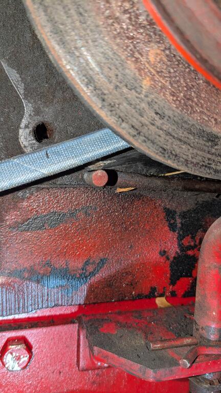

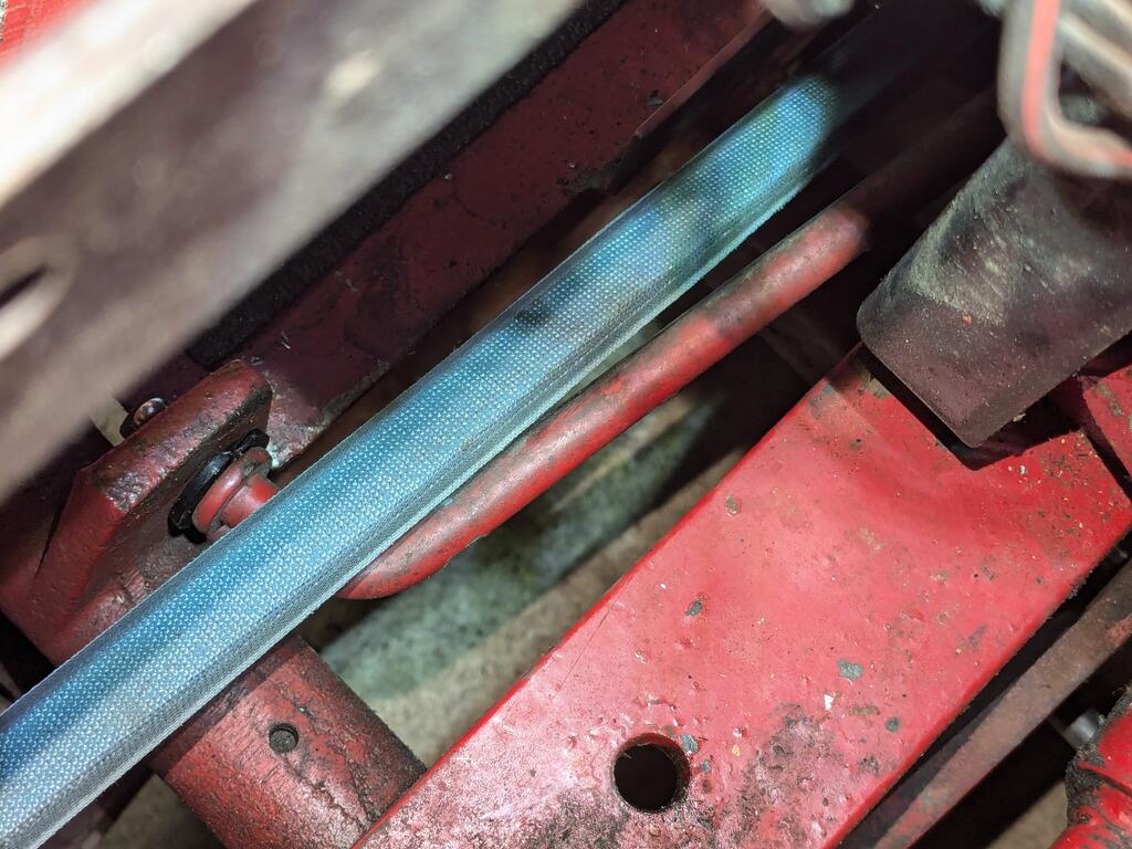

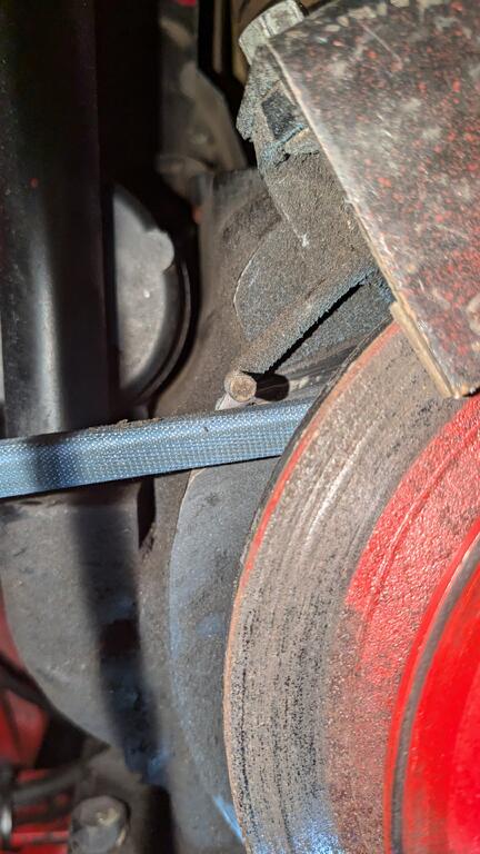

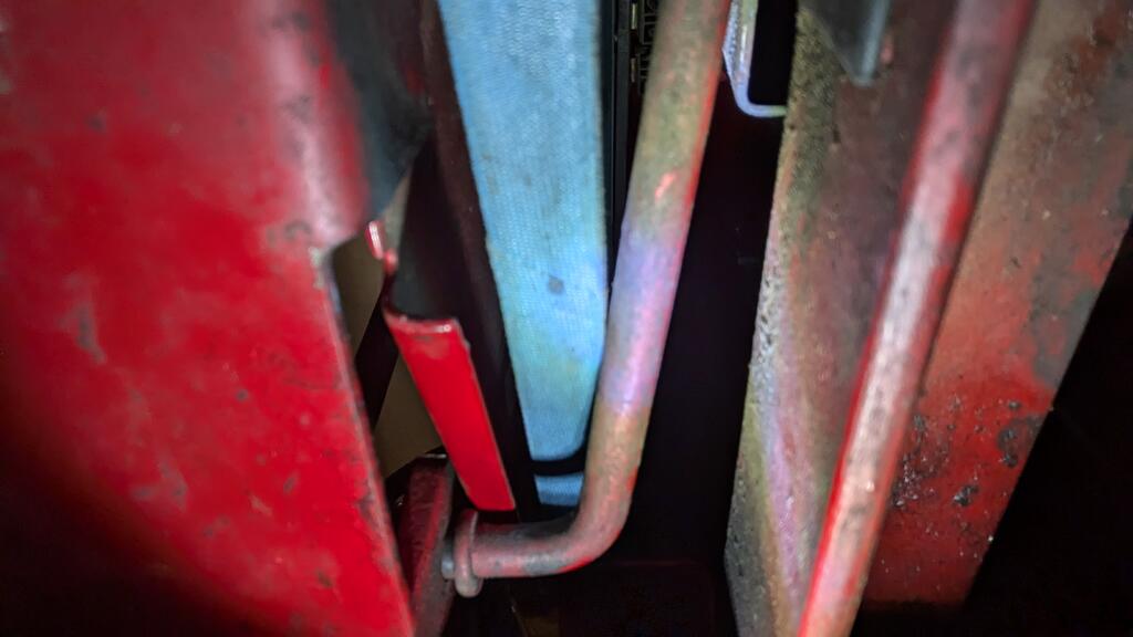

Alrashid2 476 #23 Posted December 18, 2024 (edited) Another update: Scratch all I said before. I finally found the true culprit of the belt dust and wear. The belt is rubbing the brake rod! Tried to snap a photo from underneath, and one from up top with brake guard removed . Solved the mystery! But I have no freaking clue how to fix this one... My only idea at this point is to get under there with a file and file down that side of the brake rod 1/8" so theres some clearance... Anyone seen this before? Any ideas ? Edited December 18, 2024 by Alrashid2 Share this post Link to post Share on other sites
Alrashid2 476 #25 Posted December 18, 2024 4 minutes ago, Bar Nuthin said: Ha, praying somebody weighs in! Share this post Link to post Share on other sites
