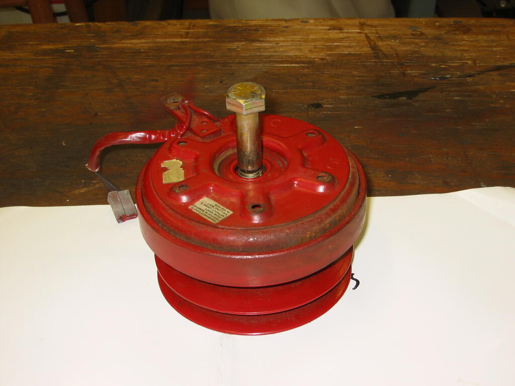

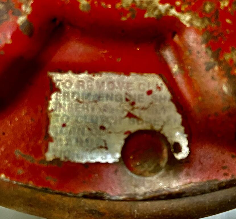

kpinnc 18,744 #1 Posted December 15, 2024 (edited) Anybody got a clutch with a legible decal on it? Just curious what is on there. I can’t make mine out… Edit: Sorry fellas, I wasn’t thinking. Below is a pic I borrowed from @pfrederi that at least shows the type of clutch I’m asking about. Edited December 15, 2024 by kpinnc Share this post Link to post Share on other sites
pfrederi 20,867 #2 Posted December 15, 2024 Bit out of focus Basically warms you warranty will be voided if you do not demount the clutch using a pusher bolt. 1 Share this post Link to post Share on other sites

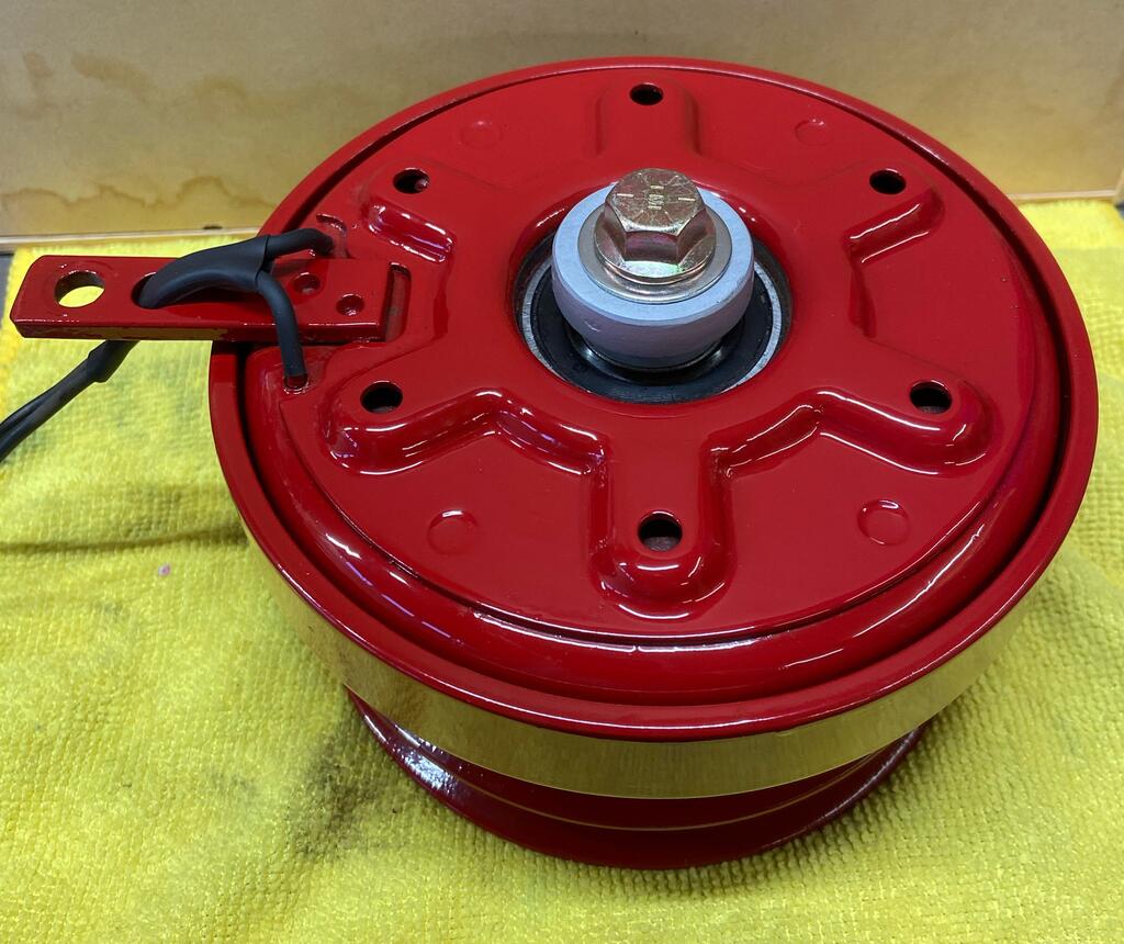

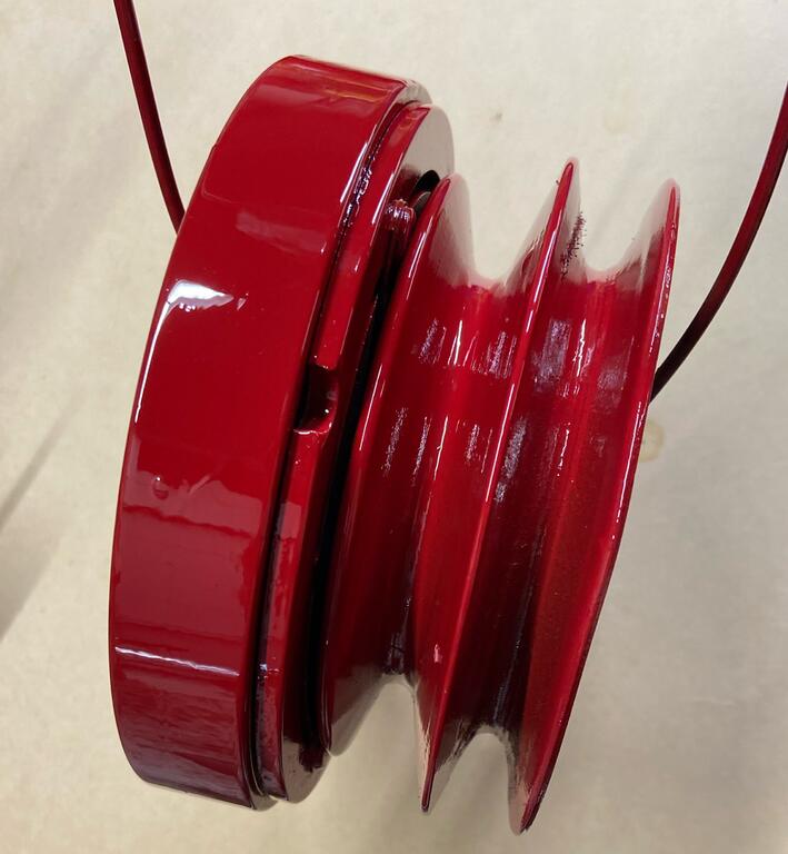

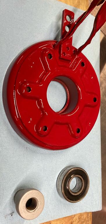

kpinnc 18,744 #3 Posted December 21, 2024 Well I repacked the bearings, cleaned it up and did a little painting today. Maybe Sunday it will get installed… Thank you @WHX?? 1 Share this post Link to post Share on other sites

kpinnc 18,744 #6 Posted December 21, 2024 7 hours ago, peter lena said: @kpinnc just curious , what did you use in the bearings ? I used regular red grease. Cleaned the bearings out with carb cleaner until nothing came out. It’s messy, but the bearings are very smooth afterwards. Then just carefully reinstalled the seals. New connectors will be here tomorrow. Hopefully I’ll get it installed then. 1 Share this post Link to post Share on other sites

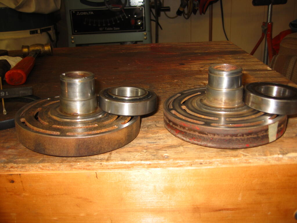

pfrederi 20,867 #7 Posted December 22, 2024 They used two different inside bearing one had a longer inner race was yours the long race (left) or the more normal one (right)?? Share this post Link to post Share on other sites
kpinnc 18,744 #8 Posted December 22, 2024 6 hours ago, pfrederi said: They used two different inside bearing one had a longer inner race was yours the long race (left) or the more normal one (right)?? I think mine looks more like the one on the right. The race is flush on both sides. 1 Share this post Link to post Share on other sites
