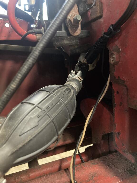

SylvanLakeWH 32,823 #13 Posted December 13, 2024 If weak battery is ruled out as @Bar Nuthin points out, try a Marine primer bulb. I bet it fires right up... Heres mine: 4 Share this post Link to post Share on other sites

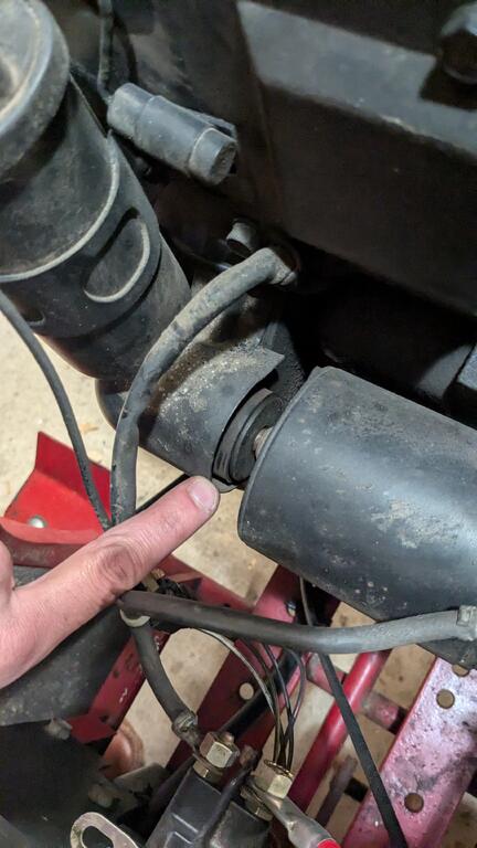

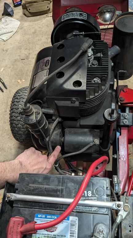

Alrashid2 476 #19 Posted December 14, 2024 Hey guys I appreciate your advice. @oliver2-44 maybe you're into something.. I noticed by manually turning the crank pulley, it sounded very early when I know it didn't before. Well, I found some loose components. Any idea what I'm looking at here and how to repair? Maybe it's just something that came un-torqued? Share this post Link to post Share on other sites

D_Mac 9,339 #21 Posted December 14, 2024 It's your starter. Check to see if it is loose or lubricate the armature. It's not fully engaging and disengaging. Share this post Link to post Share on other sites
Alrashid2 476 #22 Posted December 14, 2024 Any idea how to get to it? I'm thinking removing the engine shroud? The pieces im moving seem to thread/unthread but not sure which direction they should go Share this post Link to post Share on other sites
953 nut 70,281 #23 Posted December 14, 2024 You are pointing to the Bendix drive from your starter motor. It will spin out to engage the flywheel when the starter is turning and spring back when it is not. 38 minutes ago, oliver2-44 said: a block heater Oliver has your answer if you don't want to change the oil twice a year. Wallyworld can send you one for under $ 20.00. https://www.walmart.com/ip/HOMEMAXS-Car-Engine-Block-Heater-Pad-Car-Oil-Pan-Heater-Pad-Hydraulic-Fluid-Pad-US-Plug/1035683369 1 Share this post Link to post Share on other sites
D_Mac 9,339 #24 Posted December 14, 2024 Grab a hold of the starter and see if it came loose. It will move up and down if it did. Some times they work loose and need to be tightened back down. It's not turning over because the starter isn't engaging. You don't want to strip the gears so tighten it up and lubricate the bendix. 1 Share this post Link to post Share on other sites
