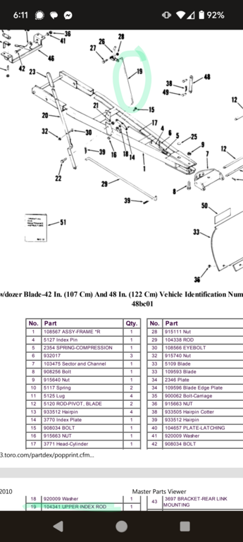

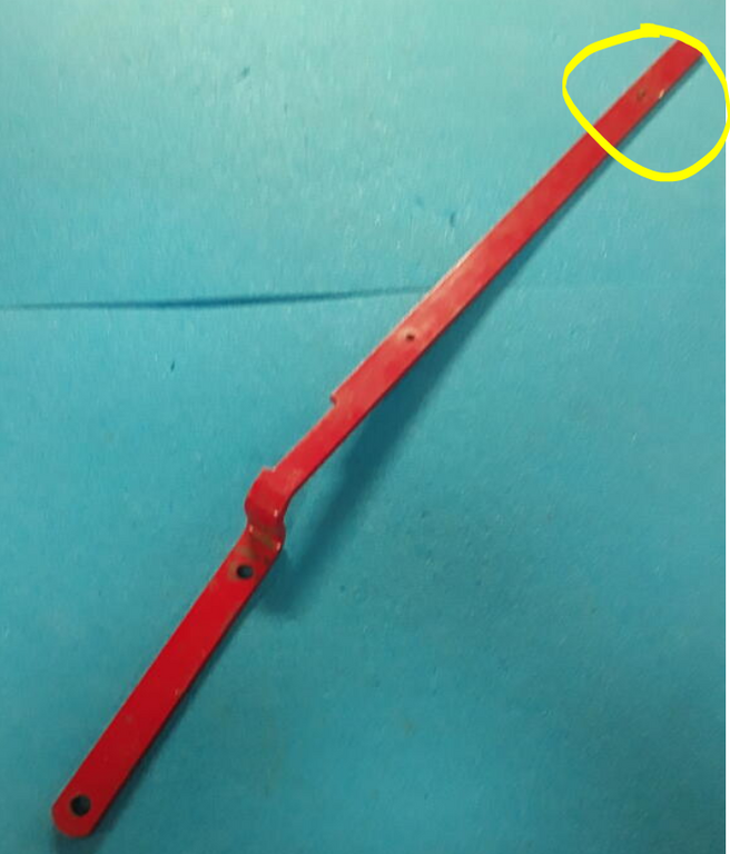

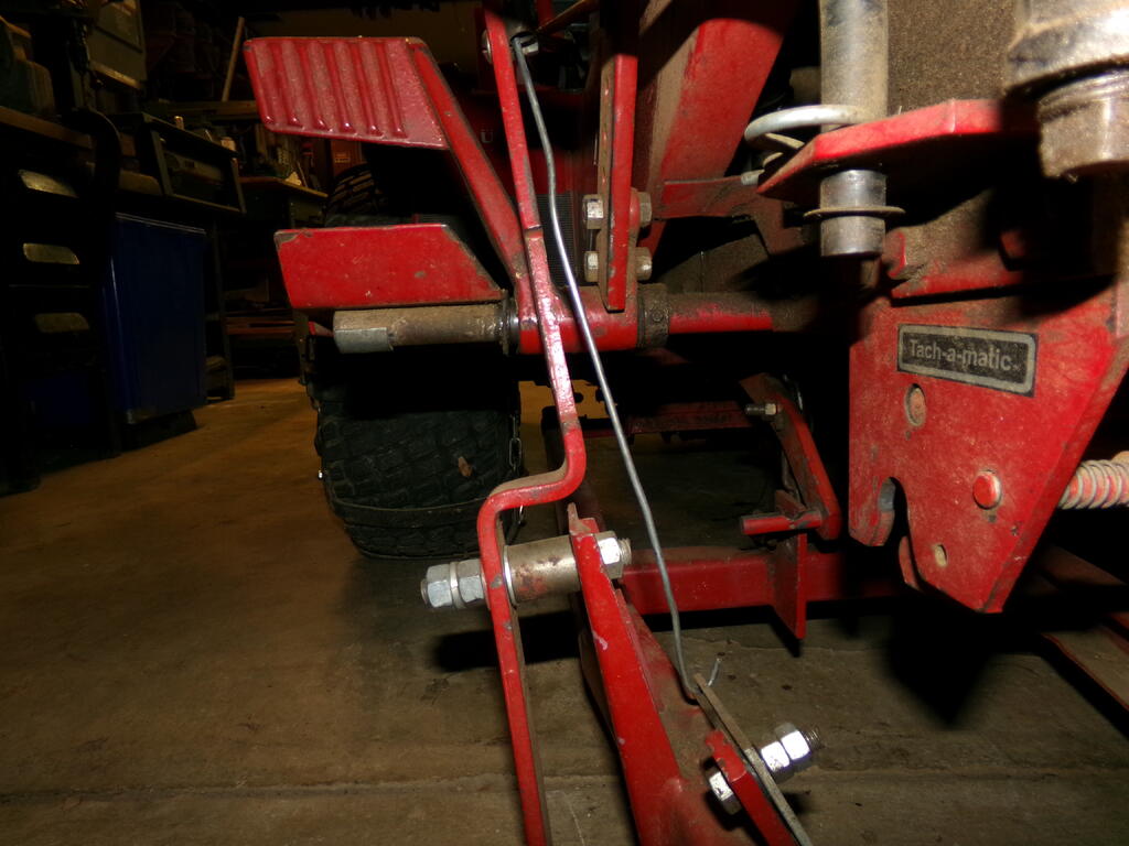

Ed Kennell 47,381 #104 Posted December 15, 2024 1 hour ago, Alrashid2 said: You guys think this is the right part? And what's the middle hole for? That is the lever I had to use on my312H. I use the middle hole to bolt on a small clamp to guide the wire that pulls the sector pin. Not sure why the top hole would be missing. May be full of paint. 2 1 Share this post Link to post Share on other sites

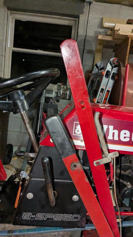

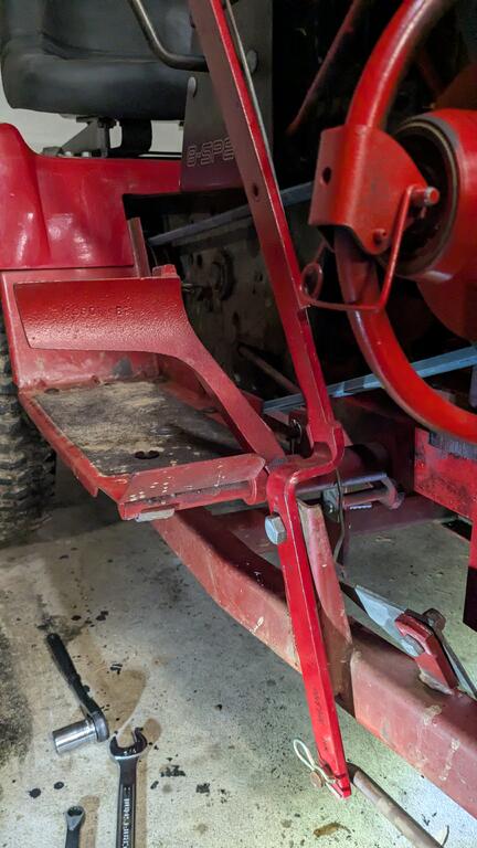

SylvanLakeWH 32,558 #105 Posted December 15, 2024 And notice the spacers etc. in Ed's pic above...don't be shy using washers, spacers whatever to clear the pedal... a little love is usually needed to line things up... 1 1 Share this post Link to post Share on other sites
Alrashid2 476 #106 Posted December 15, 2024 Thanks @SylvanLakeWH and @Ed Kennell! Now that I have my plow on and understand the geometry of it all more, I'm studying Ed's photo... so why did you install the spacer there? It is pushing the lever outward more - was your lever hitting the muffler or body/hood of the tractor? Currently on my setup, the only issue is the lever hitting my brake pedal. I don't think I'll need spacers - if anything I'll have to bend the lever inward even more! My straight lever is currently not hitting the hood, muffler, or anything else except the pedal. Share this post Link to post Share on other sites
Ed Kennell 47,381 #107 Posted December 15, 2024 Just now, Alrashid2 said: was your lever hitting the muffler or body/hood of the tractor? No, if you look at the upper section you can see it is actually inside the lever support. I needed it in this location to clear the pedal and the motion control bar I have bolted to the pedal lug. I probably could have used a straight flat lever with a slight inward bend, but this is the lever I had. I know your pedal is different as mine is a custom made motion control pedal for the hydro. With this arrangement though you should be able to position the upper lever left to right to clear the pedal. Share this post Link to post Share on other sites
Alrashid2 476 #108 Posted December 15, 2024 Ah I think I understand now. Yes your setup is a tad different than me - I see now without the spacer you'd hit that bolted on section. Thanks for explaining! Hopefully me and Brian from K&B can get this ordered tomorrow and I'll get her setup soon! 1 Share this post Link to post Share on other sites

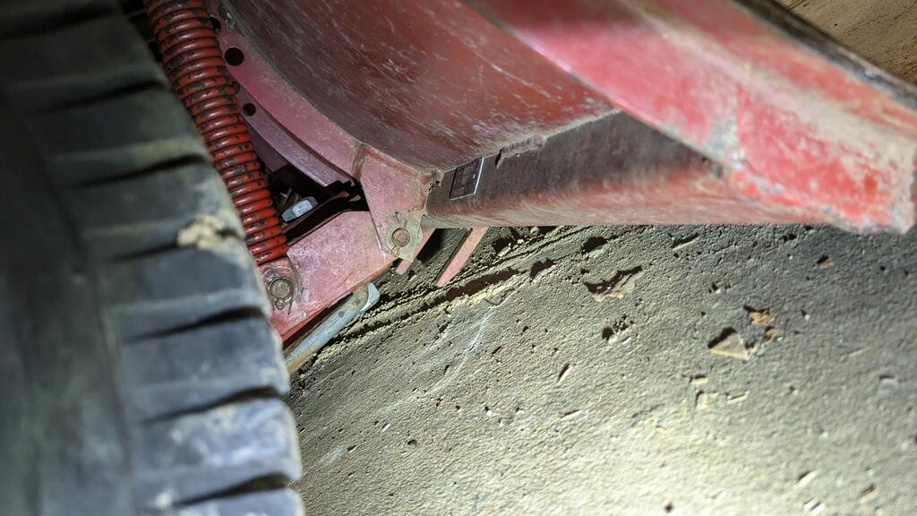

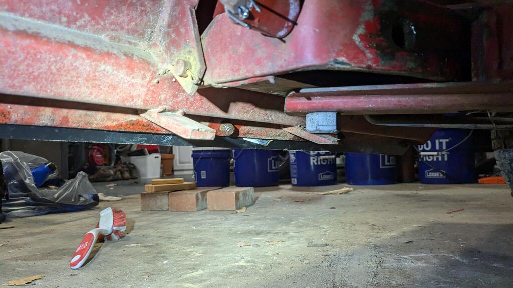

Alrashid2 476 #111 Posted December 16, 2024 (edited) Hey guys, any of you know what these 2 tabs are on the bottom of my plow? With the angle I have my plow set at, I wouldn't be surprised if these end up wearing down as the wear bar wears... just curious and want to make sure I'm not wrecking something important Edited December 16, 2024 by Alrashid2 Share this post Link to post Share on other sites
Handy Don 17,480 #112 Posted December 16, 2024 (edited) I’m not sure they should be touching the ground with the angle set correctly. Earlier blades did not have them--and some of those had adjustable skids. I have noticed on my son’s, that with the blade off the frame, the tabs hold the blade standing upright. Otherwise Edited December 16, 2024 by Handy Don 1 Share this post Link to post Share on other sites
Alrashid2 476 #113 Posted December 16, 2024 Thanks for weighing in @Handy Don. Ya you are probably right, but unfortunately I need as much clearance as I can and having the plow angled this way allows for an additional 1.5" of ground clearance compared to the default angle position. Interesting earlier blades didn't have them - maybe I'll just take the angle grinder and cut them off, haha... Share this post Link to post Share on other sites

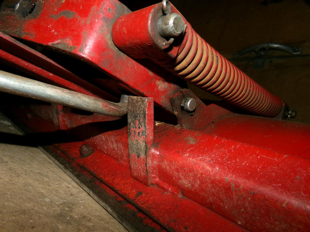

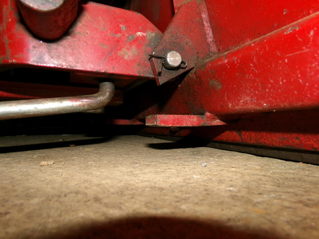

Ed Kennell 47,381 #114 Posted December 16, 2024 Those tabs are the trip spring stops. They should have 1" clearance when the blade is down. Tab clearance Tab hits sector and stops blade from tripping too far 1 2 Share this post Link to post Share on other sites
Alrashid2 476 #115 Posted December 16, 2024 (edited) Ah interesting, thanks @Ed Kennell. In what situation would the springs move toward those tabs though? If I'm thinking of it correctly, the springs should only move upward, and not be able to compress anymore than possible? Edit: or maybe those tabs are just to stop the trip springs from hitting the ground when the plow is disconnected from the frame? Edited December 16, 2024 by Alrashid2 Share this post Link to post Share on other sites
Bar Nuthin 3,246 #116 Posted December 16, 2024 8 minutes ago, Alrashid2 said: Ah interesting, thanks @Ed Kennell. In what situation would the springs move toward those tabs though? If I'm thinking of it correctly, the springs should only move upward, and not be able to compress anymore than possible? When the blade hits strong enough resistance, it folds forward to avoid damage - stretching the springs. The stops prevent it from folding completely down flat against the ground.. Share this post Link to post Share on other sites
Ed Kennell 47,381 #117 Posted December 16, 2024 2 minutes ago, Alrashid2 said: Ah interesting, thanks @Ed Kennell. In what situation would the springs move toward those tabs though? If I'm thinking of it correctly, the springs should only move upward, and not be able to compress anymore than possible? The springs are there to hold the blade upright. When plowing and the bottom of the blade hits an obstruction( a curb, a crack in the pavement, a tree root, etc.) the blade will trip forward to a horizontal position stretching the springs and allowing the blade to pass over the obstruction. After passing the obstruction, the springs will pull the blade back up to working position. Those tabs only prevent the blade from tripping too far for the springs to reset the blade upright. In the second picture the blade is tripped forward to the horizontal position. Share this post Link to post Share on other sites
Alrashid2 476 #118 Posted December 16, 2024 Ah I understand now, so just from the "recoil" basically of folding forward, the stops stop the springs from bouncing backward and hitting the ground... got it, thank you guys! Share this post Link to post Share on other sites
Ed Kennell 47,381 #119 Posted December 16, 2024 (edited) 6 minutes ago, Alrashid2 said: Ah I understand now, Ah, not quite. The tabs do nothing when the springs are pulling the blade back to the vertical working position. The springs themselves stop and hold the blade in the upright position. The tabs only stop the blade from going too far forward when it is tripped . You can stand on the top of your blade and force it forward to the tripped position and watch the function of the springs and tabs. This is what I did to take these pics. Edited December 16, 2024 by Ed Kennell 1 2 Share this post Link to post Share on other sites

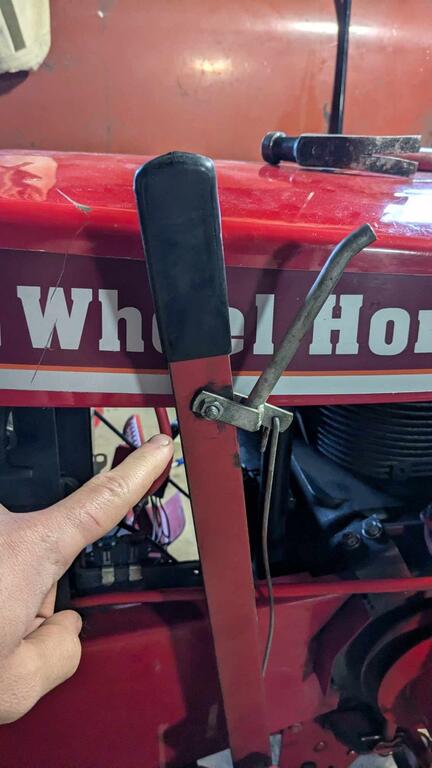

Alrashid2 476 #120 Posted December 18, 2024 (edited) Welp, got my updated index lever today from Brian @ K-B Horse parts. Thanks Brian! Unfortunately it's one step forward, two steps backwards... The lever clears the brake pedal - yay! However, this lever is about 5" longer than the older straight lever... Now the wire connecting the latch mechanism is 5" too short! I've thought of two options: 1. Cut the new lever 5" shorter with an angle grinder, and drill a new hole 5" down. Id prefer not to do this as I risk cutting/drilling something wrong. 2. Make myself a new, longer metal wire (called the upper index rod in the parts diagram, #19). This one looks much simpler and less permanent/risky! Get some thick wire, cut to length, bend onto either latch, and good to go! My only issue with Option 2 is I'm not sure where to find sturdy metal wire like that... Not even sure what the right term is for what I need to Google or ask for at Ace... Any ideas boys? Appreciate the help here - snow in bound Friday so I'm up against the clock at this point! P.S. Why does the new lever have 2 holes for the latch mechanism??? Edited December 18, 2024 by Alrashid2 Share this post Link to post Share on other sites
SylvanLakeWH 32,558 #121 Posted December 18, 2024 Just get wire at the hardware store... standard stuff. Cut to fit. Don't worry about extra holes... after 40 plus years these things have previous owner holes everywhere... adds character, like Swiss cheese. 1 Share this post Link to post Share on other sites
Alrashid2 476 #122 Posted December 18, 2024 3 minutes ago, SylvanLakeWH said: Just get wire at the hardware store... standard stuff. Cut to fit. Don't worry about extra holes... after 40 plus years these things have previous owner holes everywhere... adds character, like Swiss cheese. Ha! I do love cheese... I probably sound stupid here. But I'm learning as I go. What's the name of the wire? What aisle am I looking? What's it's usual use? Tried looking online and I'm just finding fencing and electrical wire... Share this post Link to post Share on other sites
SylvanLakeWH 32,558 #123 Posted December 18, 2024 Take a piece of your existing wire in and match it. If you can, go to a real hardware store for some help... You're overthinking this... match the wire and cut it... it'll be fine... mine looks like it was used on the Mayflower and it's still going strong... it does not have a tough job. 1 3 Share this post Link to post Share on other sites
ebinmaine 80,750 #124 Posted December 18, 2024 2 minutes ago, SylvanLakeWH said: mine looks like it was used on the Mayflower Share this post Link to post Share on other sites
ebinmaine 80,750 #125 Posted December 18, 2024 A hunk/chunk/section/piece of metal coat hanger would even get ya outta trouble. Not permanent... but usable. 1 1 Share this post Link to post Share on other sites
