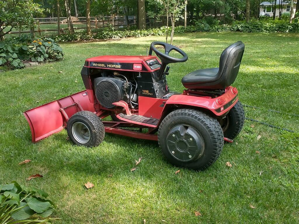

Alrashid2 476 #8 Posted December 9, 2024 Thanks all for the responses. I guess once i get the plow/frame figured out and installed, I'll be able to take her for a test drive and see how she does in the forest. Anyone have a side photo of a 300 series with a plow fully raised? I'd be curious to visually see how much ground clearance I lose with that frame under there Share this post Link to post Share on other sites

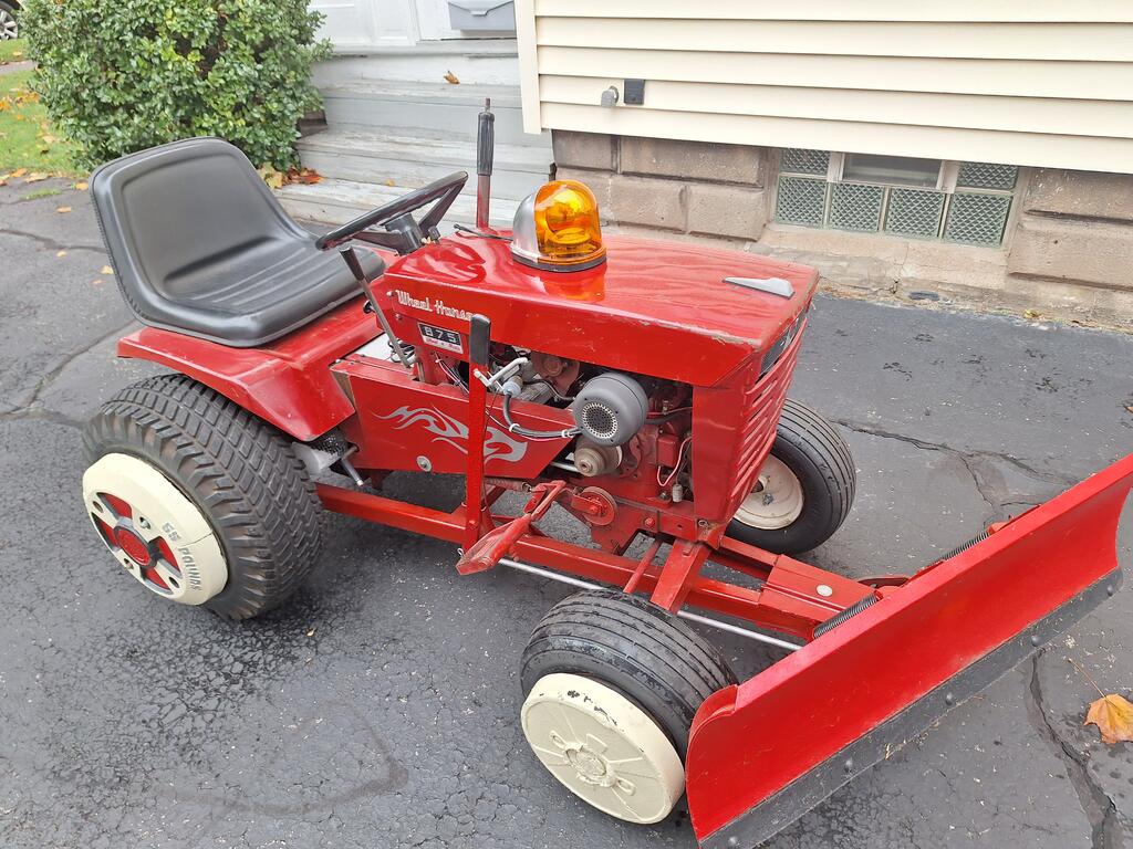

D_Mac 9,339 #10 Posted December 9, 2024 On my 875 I leave weights and blade on all year. Takes up some extra space in garage but it's worth not putting them on and taking them off. If I needed to remove the blade that's easy enough but for sure leave the wheel weights on. 2 Share this post Link to post Share on other sites

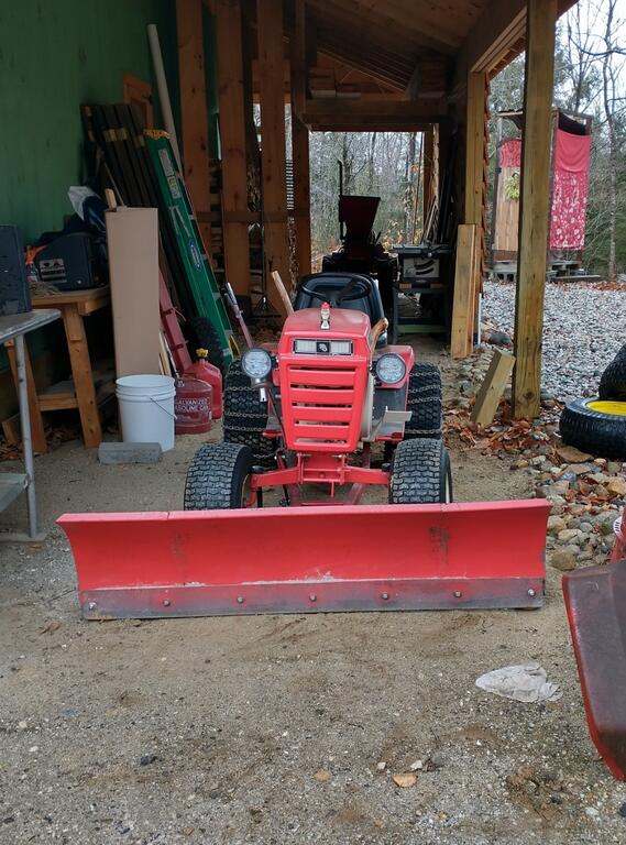

ri702bill 13,394 #11 Posted December 9, 2024 Notice on @D-Mac's setup above he has the plow raised. There is only roughly four inches of clearance under the cutting edge and about a quarter of that between the A frame and the underside of the pivoting axle..... NOT an ideal off-road setup. Share this post Link to post Share on other sites
