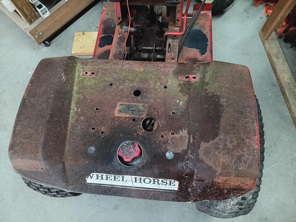

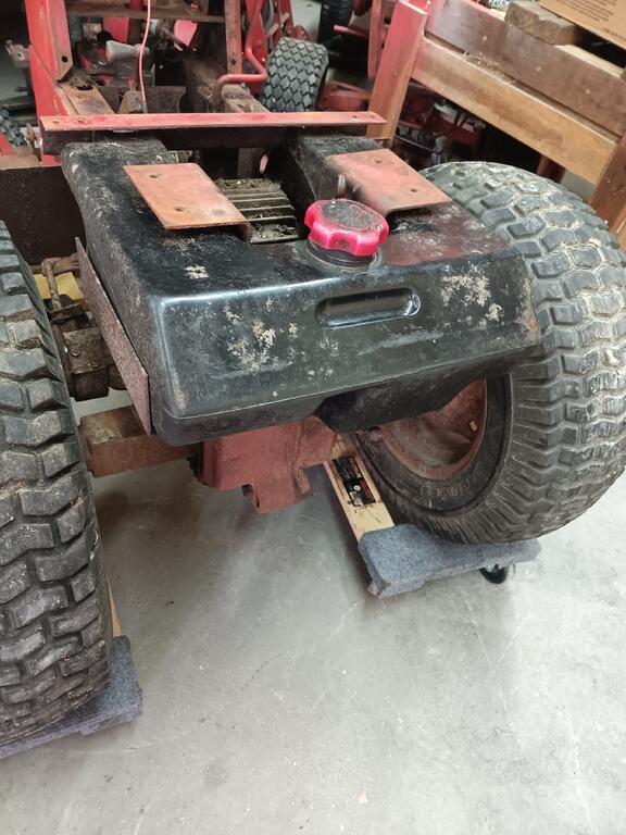

ebinmaine 79,518 #26 Posted November 30, 2024 8 hours ago, Easton Rich said: You would need square hood fender brackets with the rear gas tank because the 76 front tank was just a straight up and down bracket. Unless you want to make or modify one? Somewhere around here I have a fender bracket from a 77 C160-8 speed. I'm wondering if I used that bracket with the fender and tank from a 78 it'd be close. Then use spacers as needed like @Lee1977 suggests. Share this post Link to post Share on other sites

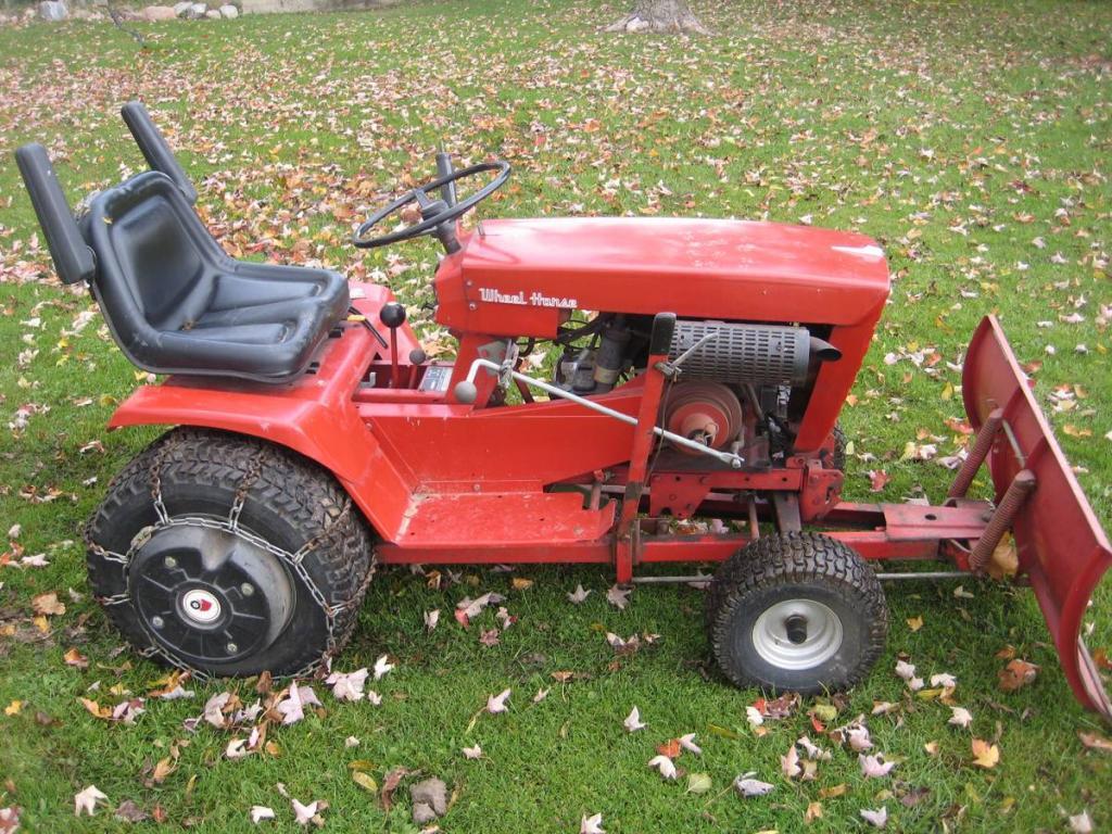

Lee1977 7,690 #27 Posted November 30, 2024 (edited) Extend the steering wheel shaft up, add larger tires on the 520 front axle and 25" on the rear and you will have a C-series twin to my 316-8. Can't go much bigger then the 25" with the 300 frame you'll hit the rear bar Edited November 30, 2024 by Lee1977 2 Share this post Link to post Share on other sites
Lee1977 7,690 #28 Posted November 30, 2024 (edited) Here is a couple more pictures of the 316. Iused a couple of pieces of 2" channel ( use what you have ) a couple of pieces of 3/4" pipe will workI have a little trouble reaching the clutct, your tall enough it may be an improvement. Edited November 30, 2024 by Lee1977 1 1 Share this post Link to post Share on other sites

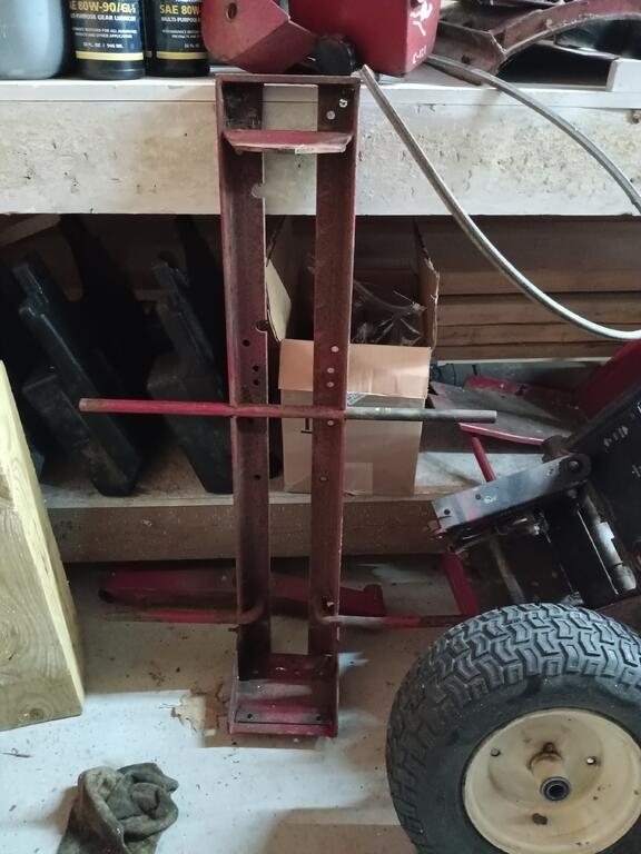

ebinmaine 79,518 #29 Posted November 30, 2024 On 11/28/2024 at 6:51 PM, 953 nut said: Here's a few of the possibilities... 518 frame from @Handy Don 312-8 parts rig from @PWL216 '78 C141 Automatic parts rig also from @PWL216 2 1 Share this post Link to post Share on other sites
Bar Nuthin 2,564 #30 Posted November 30, 2024 4 hours ago, ebinmaine said: '78 C141 Automatic parts rig also from @PWL216 I would say the saddle tank is a "must have" 2 Share this post Link to post Share on other sites

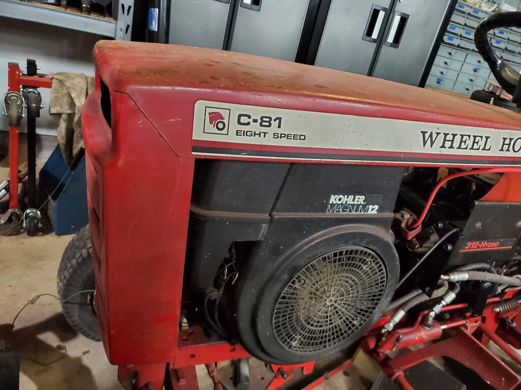

Thor27 891 #35 Posted December 1, 2024 As far as the magnum with the early sheetmetal, it will all be fine except the muffler. This is a 91 312h. 2 1 Share this post Link to post Share on other sites
kpinnc 18,723 #36 Posted December 1, 2024 (edited) 4 hours ago, Thor27 said: As far as the magnum with the early sheetmetal, it will all be fine except the muffler. There ya go. Easy to extend it and the brace out about an inch. Longer pipe nipple and a spacer for the brace. Edited December 1, 2024 by kpinnc 1 1 Share this post Link to post Share on other sites
Thor27 891 #37 Posted December 1, 2024 @kpinnc Brilliant, that would certainly work. 1 Share this post Link to post Share on other sites
kpinnc 18,723 #38 Posted December 1, 2024 56 minutes ago, Thor27 said: Brilliant, that would certainly work Did this on my Bronco. 4 Share this post Link to post Share on other sites
