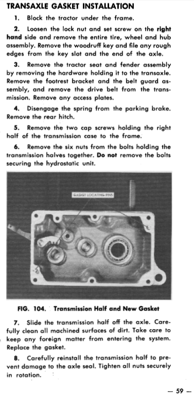

Bar Nuthin 2,521 #1 Posted November 20, 2024 The directions to replace the parking pawl seem pretty straight forward. I have the pawl, gasket and a new axle seal (if needed). Does anyone have any tips they'd like to share before I attempt this? Share this post Link to post Share on other sites

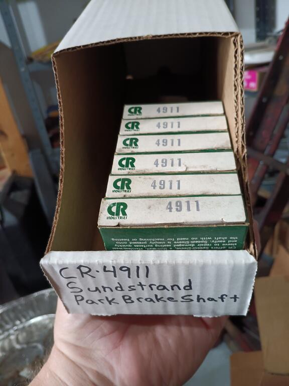

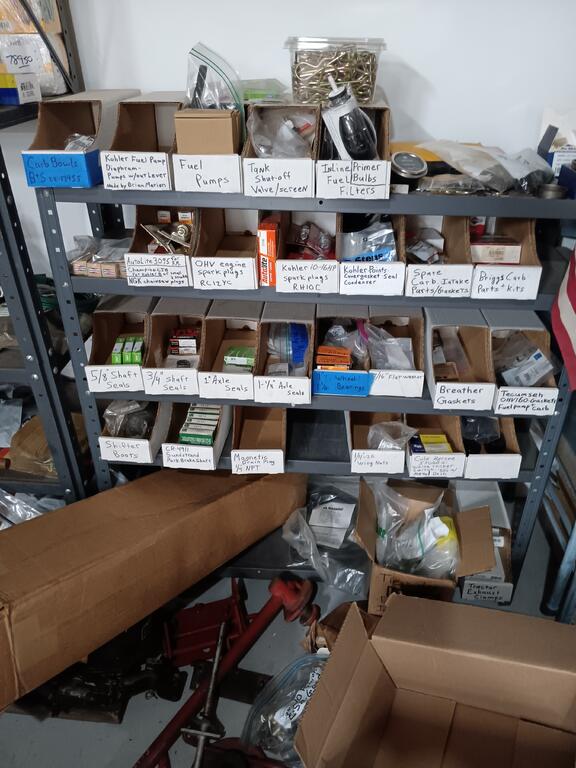

ebinmaine 79,121 #5 Posted November 20, 2024 6 hours ago, Bar Nuthin said: @ebinmaine I'm only planning to pull the RH case. I can only come up with the Axle Seal, the Brake Seal, and the housing gasket. You reference 4 seals - what am I overlooking? I was figuring: 2 axles seals. 1 brake shaft seal. 1 park shaft seal. 6 hours ago, Bar Nuthin said: If you have a brake shaft seal, I will gladly buy it from you. Likewise, if you have an extra magnetic drain plug. I have several New Old Stock CR 4911 seals. I have a few magnetic drain plugs but they stick DOWN from the case. I'll be buying some that set flush as stock ones do. You may be able to find one of them at a local store. Another option is to get some Rare Earth magnets and simply stick one the the bottom of the case. This is one of several ares of my not very well-organized Parts Department. PM me your address. I'd be glad to send a seal. I'll treat ya right. 1 Share this post Link to post Share on other sites

Bar Nuthin 2,521 #7 Posted November 20, 2024 (edited) 4 hours ago, ebinmaine said: I was figuring: 2 axles seals. 1 brake shaft seal. 1 park shaft seal. I have several New Old Stock CR 4911 seals. Very generous of you! I guess I need to rethink this. What is the difference between the brake shaft seal and the park shaft seal? To my limited knowledge, my C-120A doesn't have any brakes, Only the parking cog. Since I'm only planning to pull the RH side off (leaving the internals intact) I can only identify 1-RH axle seal 1-parking shaft seal 1-RH case gasket I have the gasket and axle seals, and I'll grab a drain plug locally. I'll send you a message on the CR 4911 if you don't mind parting with one. Thanks again! Edited November 20, 2024 by Bar Nuthin Share this post Link to post Share on other sites

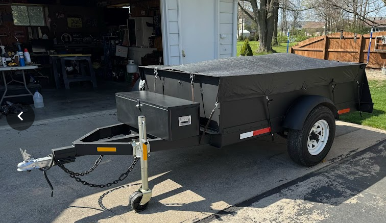

Bar Nuthin 2,521 #13 Posted November 22, 2024 (edited) 1 hour ago, daveoman1966 said: Bt writing "lose power", I mean ...losing torque at the wheels. Thank you. I haven't really put it through its paces yet - short of pulling my leaf vac around for a couple hours. Seemed to handle that well. I bought it primarily for navigating my heavy gravel/dirt trailer around the yard. That's also the reason I want an operation brake pawl. Edited November 22, 2024 by Bar Nuthin 1 Share this post Link to post Share on other sites
