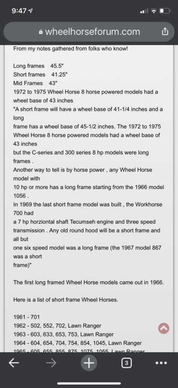

John2189 605 #14 Posted November 20, 2024 I took a screenshot of this sometime ago. No clue who posted it. Hope this helps 5 Share this post Link to post Share on other sites

Retired Wrencher 7,043 #16 Posted November 21, 2024 22 hours ago, John2189 said: I took a screenshot of this sometime ago. No clue who posted it. Hope this helps @John2189 Thanks for the info this helps. 3 Share this post Link to post Share on other sites
