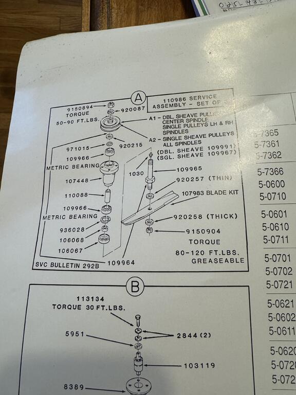

elcamino/wheelhorse 9,363 #1 Posted November 3, 2024 I am replacing the spindles on a 1972 36-inch RD deck. Does anyone know what the torque specs for the bolts that mount the spindle housing to the deck. I can find specs on the bolts for blades and bolt for the pulleys , but not for the mounting bolts. Anyone want to suggest a SWAG (scientific Wild A** guess) for the torque spec. I did find out that the carriage bolts that WH used are not standard. The square portion of the WH bolts are the same thickness of the deck. Any help from the head lug nut (you know who you are) would be appreciated. thanks Waldo Share this post Link to post Share on other sites

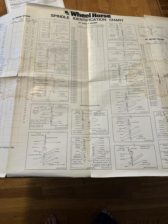

PWL216 1,310 #5 Posted November 3, 2024 @elcamino/wheelhorse Do you know what the part number is for the deck? I have this spindle identification poster that shows the detail of the decks, including torque spec. If you have a part number, I can find it for you. I’ve attached a couple of pictures as an example from the poster. 1 Share this post Link to post Share on other sites

elcamino/wheelhorse 9,363 #8 Posted November 3, 2024 @Ed Kennell Thanks for the chart, the bolts are 3/8 - 16 x 1 carriage style bolt and The square part of the bolt depth is the same thickness as the metal of the deck. @PWL216 I'll get back you , if I can find the part number , The deck number is a 05-620. Share this post Link to post Share on other sites
Ed Kennell 47,952 #9 Posted November 3, 2024 16 minutes ago, elcamino/wheelhorse said: the bolts are 3/8 - 16 x OK, 23 ft lb should work. 1 Share this post Link to post Share on other sites
elcamino/wheelhorse 9,363 #10 Posted November 3, 2024 @PWL216 here are the part numbers for the bolts 900234-4 , the nuts are number 915113-6 . The spindle is a number 100675 which was replace by 101525. The 101525 came with threaded holes and non threaded holes for mounting to the deck. Share this post Link to post Share on other sites
