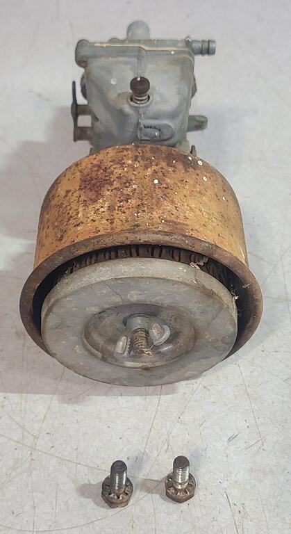

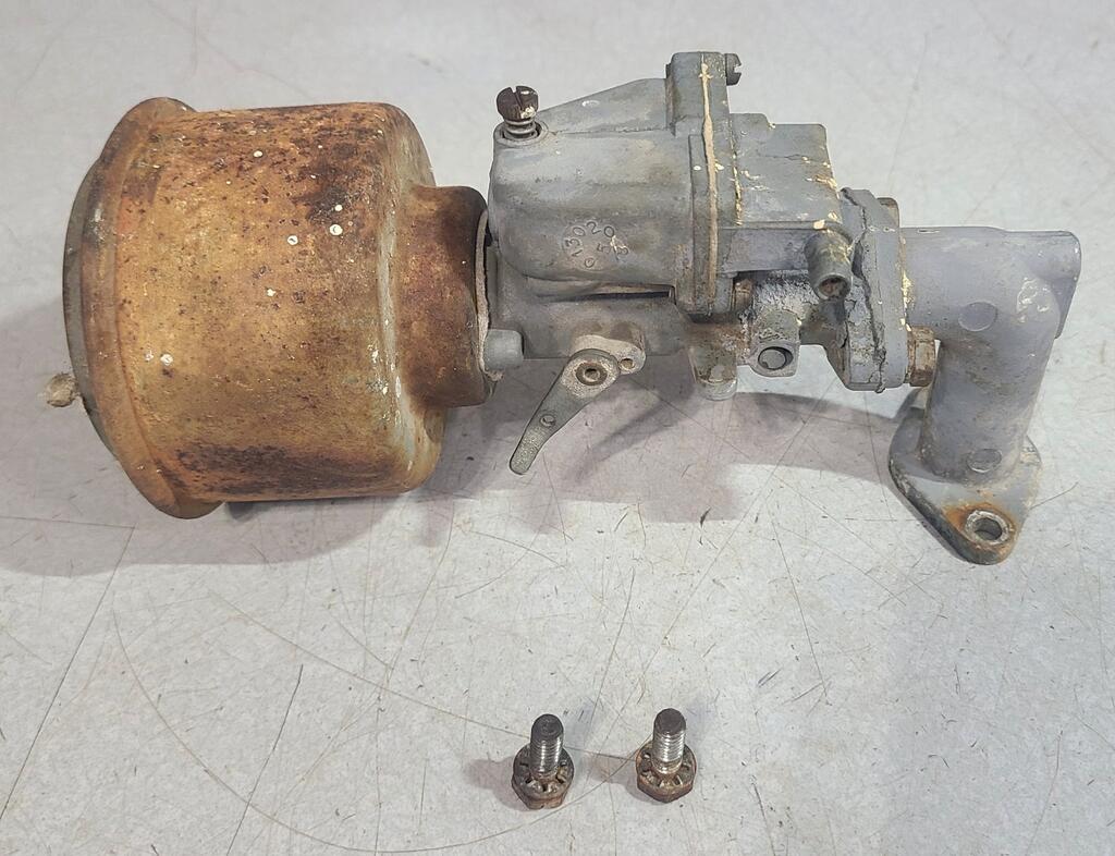

Shuboxlover 490 #1 Posted October 31, 2024 Hey all, This was on a Kohler K181 that was in an old Wheel Horse I bought. I have never seen a carb like this before. I've searched the internet and can't find any info on it. I figured someone on here will know what it is. Does anyone know anything about it? Thanks everyone! Tyson 1 1 Share this post Link to post Share on other sites

953 nut 68,503 #4 Posted October 31, 2024 Very unusual to see an updraft carburetor with the breather at the bottom. 1 Share this post Link to post Share on other sites
Oldskool 6,678 #5 Posted October 31, 2024 58 minutes ago, ebinmaine said: Interesting piece. @Oldskool or @Stepney you seen anything like it? That's an odd cuss. Would that have been on a generator originally? 1 Share this post Link to post Share on other sites
ebinmaine 80,279 #6 Posted October 31, 2024 2 minutes ago, Oldskool said: That's an odd cuss. Would that have been on a generator originally? Same thoughts I had 1 Share this post Link to post Share on other sites

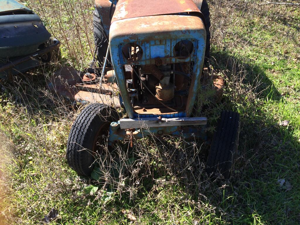

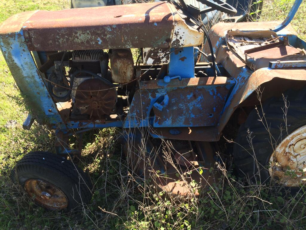

Shuboxlover 490 #7 Posted October 31, 2024 This is the post of the tractor... obviously not the original engine. Share this post Link to post Share on other sites
Shynon 7,646 #8 Posted November 1, 2024 Tillotson updraft carburetor used on a Wheel Horse 633 3 Share this post Link to post Share on other sites

Wayne0 1,624 #10 Posted November 1, 2024 Looks like a real old Flo-jet. Is the motor a Briggs? Share this post Link to post Share on other sites
Shuboxlover 490 #11 Posted November 1, 2024 It was on a Kohler, don't know if it would fit other blocks or not. Share this post Link to post Share on other sites
ebinmaine 80,279 #12 Posted November 1, 2024 7 minutes ago, Wayne0 said: Looks like a real old Flo-jet. Is the motor a Briggs? 5 minutes ago, Shuboxlover said: It was on a Kohler, don't know if it would fit other blocks or not. Now that's a neat piece of information. I was just reading the other day that there's a Briggs carb base gasket which is a near perfect interchange for a Kohler small block. Share this post Link to post Share on other sites
953 nut 68,503 #13 Posted November 1, 2024 10 hours ago, Shuboxlover said: It was on a Kohler, don't know if it would fit other blocks or not. @Pullstart has used a Kohler carburetor on a Tecumseh, as long as the bolt holes are close enough to bolt it up I don't see why not. The one you have looks like it may be considerably older than the Wheel Horse. Wouldn't be a Briggs because the main jet runs straight in rather than an upward angle. 1 Share this post Link to post Share on other sites
Pullstart 71,098 #14 Posted November 2, 2024 21 hours ago, Shuboxlover said: It was on a Kohler, don't know if it would fit other blocks or not. 10 hours ago, 953 nut said: @Pullstart has used a Kohler carburetor on a Tecumseh, as long as the bolt holes are close enough to bolt it up I don't see why not. The one you have looks like it may be considerably older than the Wheel Horse. Wouldn't be a Briggs because the main jet runs straight in rather than an upward angle. The basic principles apply, and the mechanicals don’t actually care what brand or color they are working with. Seems there’s a lesson to be learned there.. 3 Share this post Link to post Share on other sites
kpinnc 18,884 #15 Posted November 2, 2024 (edited) On 11/1/2024 at 8:52 AM, ebinmaine said: Now that's a neat piece of information. I was just reading the other day that there's a Briggs carb base gasket which is a near perfect interchange for a Kohler small block. @953 nut beat me to it, but I’ve also used a Kohler carb on a Tecchy before. No telling what that carb is from, but it certainly is interesting given the fuel pump is integrated. Edited November 2, 2024 by kpinnc 1 Share this post Link to post Share on other sites

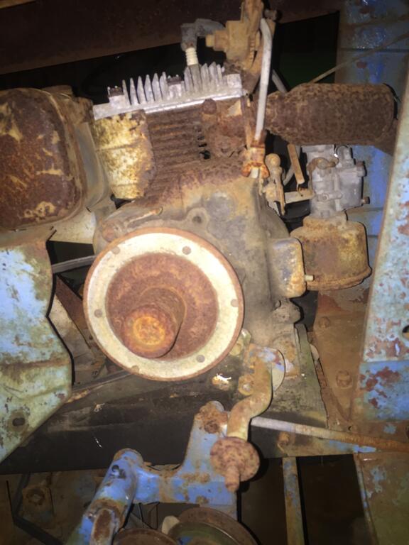

oliver2-44 11,694 #16 Posted November 3, 2024 Since this is still getting kicked around here's another thread of a 633. scroll down and there is a picture to confirm this is a Tillson carb on a Kohler. Also the Ol Blue 953 carcass I have has that same tillson carb on the Kohler K141 or k161 that is on it. 1 1 Share this post Link to post Share on other sites
