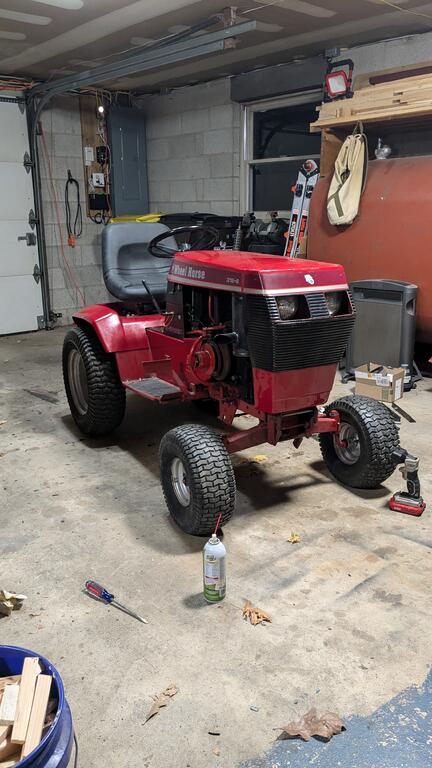

Alrashid2 476 #1 Posted October 29, 2024 (edited) Hey guys. I appreciated all of your help and welcoming words on my first post! Here is the original thread if anyone is interested in my questions and what I got answered and figured out. Logged all the work I have done there. Anyway, post was getting bloated and I realized discussion was slim to none so I wanted to start fresh and hopefully get a bit of help on a few more things I'm trying to figure out. 1. I have 15x6.00-6 tubeless tires up front and 22x7.50-12 tubed (I believe) tires in the rear. All of the tires are pretty dry rotted but are shockingly holding air just fine! Looks like the front tire size are easy to replace in today's modern world, but couldn't find replacements for the rear, and learned from many of you that I can get 23x8.50-12 tires pretty easily. My question is, should I go Tube or Tubeless for replacement tires? What are the pros and cons of either? I'd like to stick to what will be easier to install as I'd be putting these on myself at home. What do you guys think? 1.5 Speaking of tires, where can I buy quality tractor tires? Tried googling and I'm getting all sorts of sites 2. How can I check if my belt needs replaced or not? And are there any straight forward instructions/videos on how to replace the belt? The machine runs just fine, no slippage, but the belt does look a bit older in spots. Some frayed edges and such. 3. How essential are the shims on the front wheels? Realized mine only had 1 on one side and 0 on the other. Wheel has some play but wasn't sure if this was just a fine-tuning thing or if it was bad to drive it with that play. Figured I could just go to Ace Hardware and buy varying washers to work as shims? 4. Are the headlight bezels essential? Mine didn't come with any! Was going to buy some online but they were pricy. Wasn't sure if they were just a cosmetic thing. 5. What do I need to look for in a replacement battery? Battery currently works fine but having trouble finding model info and/or specs to make sure I check for the inevitable replacement. Thanks brothers! Love being here! P.S. Thought I'd outline what I've done so far or will be doing soon, thanks to you all: Oil change spark plug change air filter replacement fuel filter replacement Transaxle gear oil flush and change Greased all 6 zerk fittings Replaced the shifter boot Replaced the gas cap with a Kelch fuel gauge version Adjusted the toe of the front wheels Replaced the broken volt meter gauge with an aftermarket replacement Cleaned up various rusted hardware and painted Will be replacing the seat as soon as it gets delivered! Edited October 29, 2024 by Alrashid2 4 Share this post Link to post Share on other sites
oliver2-44 11,753 #2 Posted October 29, 2024 (edited) 54 minutes ago, Alrashid2 said: Hey guys. I appreciated all of your help and welcoming words on my first post! Here is the original thread if anyone is interested in my questions and what I got answered and figured out. Logged all the work I have done there. Anyway, post was getting bloated and I realized discussion was slim to none so I wanted to start fresh and hopefully get a bit of help on a few more things I'm trying to figure out. 1. I have 15x6.00-6 tubeless tires up front and 22x7.50-12 tubed (I believe) tires in the rear. All of the tires are pretty dry rotted but are shockingly holding air just fine! Looks like the front tire size are easy to replace in today's modern world, but couldn't find replacements for the rear, and learned from many of you that I can get 23x8.50-12 tires pretty easily. My question is, should I go Tube or Tubeless for replacement tires? What are the pros and cons of either? I'd like to stick to what will be easier to install as I'd be putting these on myself at home. What do you guys think? If you think you might want to put fluid in the tires for weight some day, then install tubes now. Otherwise, tubeless is fine. 1.5 Speaking of tires, where can I buy quality tractor tires? Tried googling and I'm getting all sorts of sites 2. How can I check if my belt needs replaced or not? And are there any straight forward instructions/videos on how to replace the belt? The machine runs just fine, no slippage, but the belt does look a bit older in spots. Some frayed edges and such. Take the belt and bend it backwards. does the inside surface stay fairly smooth or show cracks, chips etc. 3. How essential are the shims on the front wheels? Realized mine only had 1 on one side and 0 on the other. Wheel has some play but wasn't sure if this was just a fine-tuning thing or if it was bad to drive it with that play. Figured I could just go to Ace Hardware and buy varying washers to work as shims? Your OK driving it some, but the shims are a good general adjustment. Their probable good for the bearings to help reduce side loading or banging back and forth also. When you pull the front wheels you might consider installing sealed front bearings. Saves a greasy mess with the hub pumped full of grease. 4. Are the headlight bezels essential? Mine didn't come with any! Was going to buy some online but they were pricy. Wasn't sure if they were just a cosmetic thing. Their not essential. One of the guys here "Wheel Horse 3D" prints and sells them. 5. What do I need to look for in a replacement battery? Battery currently works fine but having trouble finding model info and/or specs to make sure I check for the inevitable replacement. Their are 3 companies that manufacture most of the batteries in the world to the spec of the place they are sold at. Walmart, NAPA, Autozone, O'Reillys, etc seem to change suppliers every few years as they renew their supply contract. At the time your ready for a new one, see if you can tell which ones are made by "East Penn" which is the only stateside manufacturer. To extend the life of your current battery, keep it on a "Battery Tender" If your not using the tractor for a while (I'm going to throw out 6 weeks, no magic time period). Heat (and to a smaller extent cold) is one your batteries biggest killer. I worked with large industrial battery banks at power plants and the vendors said 77 deg F is the ideal temp. I realize you not going to keep you garage or shed 77F, but store it in the shade vs leaving it outdoors. If your not using the tractor all summer, or all winter you might consider removing it and storing it in the garage or basement. Just my thoughts, your mileage may vary Thanks brothers! Love being here! P.S. Thought I'd outline what I've done so far or will be doing soon, thanks to you all: Oil change spark plug change air filter replacement fuel filter replacement Transaxle gear oil flush and change Greased all 6 zerk fittings Replaced the shifter boot Replaced the gas cap with a Kelch fuel gauge version Adjusted the toe of the front wheels Replaced the broken volt meter gauge with an aftermarket replacement Cleaned up various rusted hardware and painted Will be replacing the seat as soon as it gets delivered! Edited October 29, 2024 by oliver2-44 4 1 Share this post Link to post Share on other sites
kpinnc 18,969 #3 Posted October 29, 2024 (edited) @oliver2-44 got you covered pretty well. All I would add is your #3 question: Tractor supply and even Harbor freight carry “machine spacers” in 3/4 ID. Depending on the amount of play you have in your wheels, these are a good thing to have for taking up slop in the wheels. Unlike 3/4 washers, these are typically thinner and have a smaller outside diameter. Edited October 29, 2024 by kpinnc 4 1 Share this post Link to post Share on other sites
953 nut 69,380 #4 Posted October 29, 2024 4 hours ago, Alrashid2 said: 2. How can I check if my belt needs replaced or not? @oliver2-44 has you covered on most of the questions, I would add that a drive belt that LOOKS good can need replacement. Connect a chain low on the rear of the tractor, chain the tractor to a tree, slowly pull forward in third gear high range until the slack comes out of the chain then stop, With the throttle at less than half let the clutch out slowly, if the engine stalls or the wheels spin you have a good belt, if the belt slips you need a new one. 3 1 Share this post Link to post Share on other sites
Alrashid2 476 #5 Posted October 30, 2024 6 hours ago, oliver2-44 said: 1. I have 15x6.00-6 tubeless tires up front and 22x7.50-12 tubed (I believe) tires in the rear. All of the tires are pretty dry rotted but are shockingly holding air just fine! Looks like the front tire size are easy to replace in today's modern world, but couldn't find replacements for the rear, and learned from many of you that I can get 23x8.50-12 tires pretty easily. My question is, should I go Tube or Tubeless for replacement tires? What are the pros and cons of either? I'd like to stick to what will be easier to install as I'd be putting these on myself at home. What do you guys think? If you think you might want to put fluid in the tires for weight some day, then install tubes now. Otherwise, tubeless is fine. Don't foresee putting water in, so will look into tubeless! Any suggestions on where to buy tires? 1.5 Speaking of tires, where can I buy quality tractor tires? Tried googling and I'm getting all sorts of sites 2. How can I check if my belt needs replaced or not? And are there any straight forward instructions/videos on how to replace the belt? The machine runs just fine, no slippage, but the belt does look a bit older in spots. Some frayed edges and such. Take the belt and bend it backwards. does the inside surface stay fairly smooth or show cracks, chips etc. Oh ya, I remember that trick growing up checking car belts. No cracks! 3. How essential are the shims on the front wheels? Realized mine only had 1 on one side and 0 on the other. Wheel has some play but wasn't sure if this was just a fine-tuning thing or if it was bad to drive it with that play. Figured I could just go to Ace Hardware and buy varying washers to work as shims? Your OK driving it some, but the shims are a good general adjustment. Their probable good for the bearings to help reduce side loading or banging back and forth also. When you pull the front wheels you might consider installing sealed front bearings. Saves a greasy mess with the hub pumped full of grease. That makes sense. I actually came to realize that my front bearings do have sealed bearings installed from the PO! I tried to grease via the zerk fittings: none came out on one, and the other barely seeped out. That's when I realized they were the sealed types. 4. Are the headlight bezels essential? Mine didn't come with any! Was going to buy some online but they were pricy. Wasn't sure if they were just a cosmetic thing. Their not essential. One of the guys here "Wheel Horse 3D" prints and sells them. Will look him up! 5. What do I need to look for in a replacement battery? Battery currently works fine but having trouble finding model info and/or specs to make sure I check for the inevitable replacement. Their are 3 companies that manufacture most of the batteries in the world to the spec of the place they are sold at. Walmart, NAPA, Autozone, O'Reillys, etc seem to change suppliers every few years as they renew their supply contract. At the time your ready for a new one, see if you can tell which ones are made by "East Penn" which is the only stateside manufacturer. To extend the life of your current battery, keep it on a "Battery Tender" If your not using the tractor for a while (I'm going to throw out 6 weeks, no magic time period). Heat (and to a smaller extent cold) is one your batteries biggest killer. I worked with large industrial battery banks at power plants and the vendors said 77 deg F is the ideal temp. I realize you not going to keep you garage or shed 77F, but store it in the shade vs leaving it outdoors. If your not using the tractor all summer, or all winter you might consider removing it and storing it in the garage or basement. Thank you for this advice sir 2 Share this post Link to post Share on other sites
Alrashid2 476 #6 Posted October 30, 2024 4 hours ago, kpinnc said: @oliver2-44 got you covered pretty well. All I would add is your #3 question: Tractor supply and even Harbor freight carry “machine spacers” in 3/4 ID. Depending on the amount of play you have in your wheels, these are a good thing to have for taking up slop in the wheels. Unlike 3/4 washers, these are typically thinner and have a smaller outside diameter. Thanks man, I see that now! I wonder if they have these at Ace hardware too? That is what is closest to me. I'll see what I can find! 3 Share this post Link to post Share on other sites
Alrashid2 476 #7 Posted October 30, 2024 2 hours ago, 953 nut said: @oliver2-44 has you covered on most of the questions, I would add that a drive belt that LOOKS good can need replacement. Connect a chain low on the rear of the tractor, chain the tractor to a tree, slowly pull forward in third gear high range until the slack comes out of the chain then stop, With the throttle at less than half let the clutch out slowly, if the engine stalls or the wheels spin you have a good belt, if the belt slips you need a new one. Oh wow never heard of this trick before. When I get some time here I will definitely try this and let you all know! 2 Share this post Link to post Share on other sites

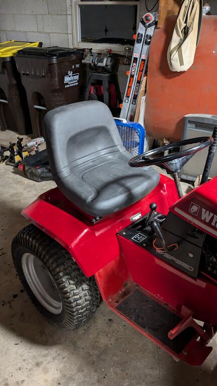

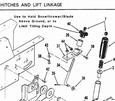

Alrashid2 476 #18 Posted October 31, 2024 (edited) Hey guys, do you know is the Manual Lift Lever on the lefthand side supposed to have only 2 locked positions? Seems like mine only locks all the way lowered, or all the way lifted. Wasn't sure if that was normal. Buying a plow so wanted to see how to fine tune it if there were only 2 positions! Also, installed the new seat from Northern Tool! Edited October 31, 2024 by Alrashid2 3 Share this post Link to post Share on other sites
Lee1977 7,782 #19 Posted October 31, 2024 The 1985 312-8 came with those smaller tires and narrow rims. I'm not sure the actual width, I think they are 4" wide. You might want to check around you area for some 7" wide rims.. 23 x 850 x 12 tires don't look right on those narrow rims.. My 85 312-8 had 8.50's on it, had set in a shed with the roof blown off and the rims were rusted badly. I had 7" wide rims with new 8.50 tire that came with a Raider so I used them. This is the only picture I have with the narrow rims and the 8.50 tires. I saw some where in this tread about the charging system. The 1985 312-8 is the only 312 with a 3 amp charging system and AC lights. Two wires, one to the light switch and one back to the PTO switchand back key switch.battery post also to the hot side of the solenoid switch before the PTO switch. According to the manual all the 1985 300's where like this. That is unless some PO change the charging system. 1 1 Share this post Link to post Share on other sites
Alrashid2 476 #20 Posted October 31, 2024 On 10/29/2024 at 5:14 PM, kpinnc said: @oliver2-44 got you covered pretty well. All I would add is your #3 question: Tractor supply and even Harbor freight carry “machine spacers” in 3/4 ID. Depending on the amount of play you have in your wheels, these are a good thing to have for taking up slop in the wheels. Unlike 3/4 washers, these are typically thinner and have a smaller outside diameter. @oliver2-44@kpinnc thanks guys, you saved me today. Found machine washers at Ace and they were perfect: essentially thinner versions of washers. They worked perfectly and no play on the front wheels now! 2 1 Share this post Link to post Share on other sites
kpinnc 18,969 #21 Posted November 1, 2024 5 hours ago, Alrashid2 said: Hey guys, do you know is the Manual Lift Lever on the lefthand side supposed to have only 2 locked positions? Later machines came with “dial-a-height” setups to allow adjustability in how far down a given implement would lower. Heck, so did a lot of older models. Point being, if you buy the parts, they bolt right into your 312. You’ll need a new cover for the center tunnel, but I’d bet the vendors here can fix you right up. Share this post Link to post Share on other sites
Alrashid2 476 #22 Posted November 1, 2024 Ah so that's what that is. Do I require those mods to plow? Or can I plow with the current setup, without the dial o matic? Share this post Link to post Share on other sites
oliver2-44 11,753 #23 Posted November 1, 2024 On 10/30/2024 at 2:09 PM, Alrashid2 said: Back with another Tire Question After doing some shopping and calling my local shop, I'm going back to thinking maybe I should just throw tubes into my current tires. The tires are pretty cracked, but they have a ton of tread left... Local shop quoted me $140 to remove tires, put tubes in, remount versus the approximately $400 for new tubeless tires and mount. If I go tubeless on my current tires though, I've got a few questions... 1. My front tires say "Tubeless" on them. Can you put tubes into tubeless tires? 2. Rear tires, I'm unsure if they currently have tubes or not (nothing written on sidewall). How can I figure this out, other than deflating and removing to check inside? You can definitely tube “Tubeless Tires”. I run several that way Partly Deflate tires. If tubeless the valve stem will stay firm held in place by a grove. If valve stem moves up and down they have tubes. You may need to hold valve stem with a small pliers while you reinflate if they have a tube. Share this post Link to post Share on other sites
Lee1977 7,782 #24 Posted November 1, 2024 (edited) You need a notch in both the shifter plate and the dash plate for a dial-a height on the 300 series. I ground them in mine when I put it Edited November 1, 2024 by Lee1977 Share this post Link to post Share on other sites
