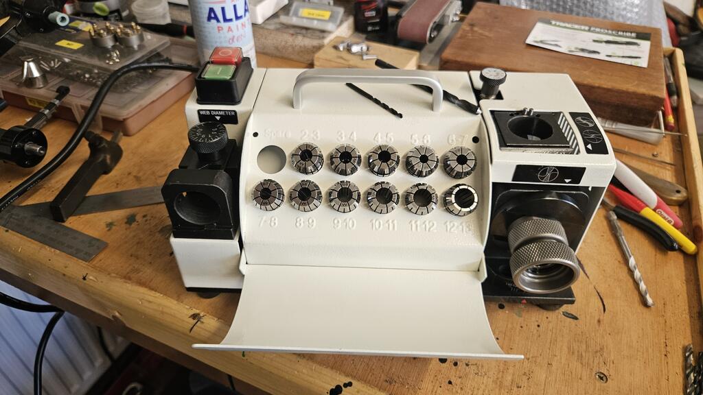

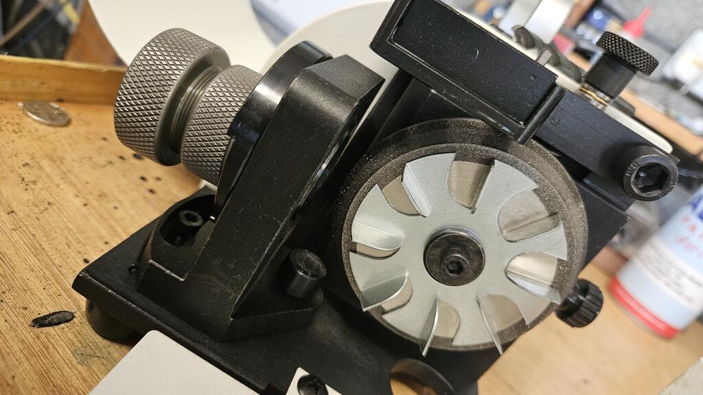

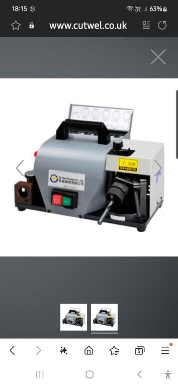

Mickwhitt 5,259 #19 Posted October 29, 2024 Hi all, I did some research and decided on this machine from one of our tool dealers. It is kind of a badge engineered version of a popular design. This one cost £335 with a diamond wheel as standard. Some were well into £1,000 so I'm happy with the price. Vert easy to set up an use, very quick and really good results on drills from 1/8 to 1/2 inch. 3 Share this post Link to post Share on other sites

Mickwhitt 5,259 #21 Posted October 29, 2024 The problem with hand sharpening is repeatable results, or the lack of them. There are too many variables to get everything right by feel according to those in the know. You can probably get a drill good enough, or at least better than it was when you started. But to do that every time is a bit of a stretch. You would probably not do anything in the shop except sharpen drill bits lol. The unit I bought is quite well built, I can't see a lot of difference between it and a thousand quids worth. As I won't be using mine day in day out I figure it was worth the saving on an industrial grade one. The huge box of dull drill bits sat under my bench prompted me to invest in a machine. I'm sure it will be worth it in the long run, now that new bits are so expensive too. 2 Share this post Link to post Share on other sites

Mickwhitt 5,259 #25 Posted October 30, 2024 I saw a Black diamond machine on Ebay, looks complicated and there were bits missing from it. At least with this one everything is there and it's pretty fool proof, even with the Chinglish instruction manual ...."If further is need, turn clockwise, if less is need go left" I will do some pics of setting up and results. 2 Share this post Link to post Share on other sites
