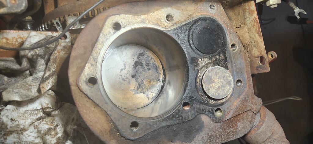

siebenaler 114 #1 Posted October 13, 2024 Your thoughts piston and rings slap it back together or bore it out? Share this post Link to post Share on other sites
ebinmaine 80,752 #2 Posted October 13, 2024 17 minutes ago, Mark siebenaler said: Your thoughts piston and rings slap it back together or bore it out? That's a really a question that can ONLY be answered with proper measurement by a qualified person with accurate tools. It appears the piston is degraded some. Likely from running a little lean for too long. 1 Share this post Link to post Share on other sites
siebenaler 114 #3 Posted October 13, 2024 2 hours ago, ebinmaine said: That's a really a question that can ONLY be answered with proper measurement by a qualified person with accurate tools. It appears the piston is degraded some. Likely from running a little lean for too long. Agree 1 Share this post Link to post Share on other sites
siebenaler 114 #4 Posted October 13, 2024 Just now, Mark siebenaler said: Agree I'm having a hard time finding people around my area that do that kind a work Share this post Link to post Share on other sites
953 nut 69,386 #5 Posted October 13, 2024 What was the engine doing or not doing to make you want to look inside? Share this post Link to post Share on other sites
WHX?? 58,163 #6 Posted October 14, 2024 3 hours ago, Mark siebenaler said: I'm having a hard time finding people around my area that do that kind a work Talk to @Shynon or his boy @prondzy They are in your area. 2 Share this post Link to post Share on other sites
squonk 48,133 #7 Posted October 14, 2024 Run that piston to the top and check it's edge closest to the exhaust valve for erosion. 2 Share this post Link to post Share on other sites
prondzy 3,890 #8 Posted October 16, 2024 Does it smoke when you run it? If not put it back together. If it does then rebuild it 1 1 Share this post Link to post Share on other sites
oliver2-44 11,753 #9 Posted October 16, 2024 33 minutes ago, prondzy said: Does it smoke when you run it? If not put it back together. If it does then rebuild it 33 minutes ago, prondzy said: Does it smoke when you run it? If not put it back together. If it does then rebuild it Good solid simple advice. Share this post Link to post Share on other sites
