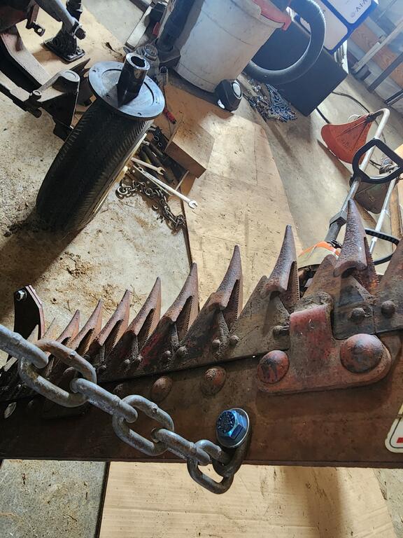

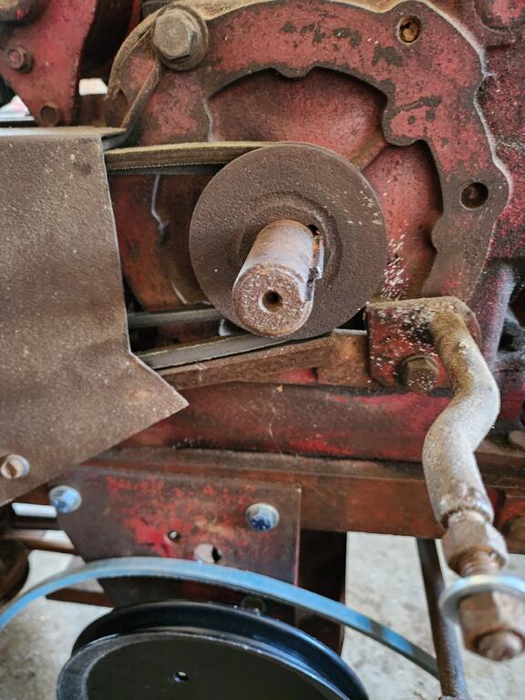

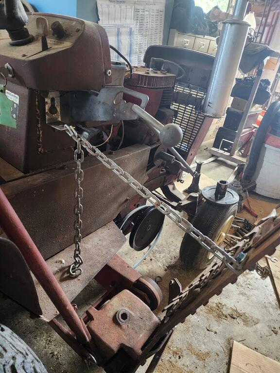

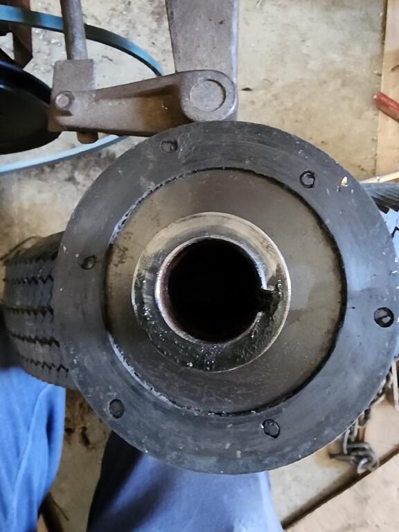

cafoose 3,878 #1 Posted September 14, 2024 (edited) I was trying to run my sickle on the 953 PTO and found that the drive pulley moved. I think it's supposed to be bolted to the engine pulley but there's no bolt holes in the engine pulley or the plate. Do I need to replace the engine pulley with one that has bolt holes? How can I correct the problem? Suggestions? @953 nut @Ed Kennell Edited September 14, 2024 by cafoose Share this post Link to post Share on other sites
953 nut 69,793 #2 Posted September 14, 2024 The PTO on the 953/1054 is attached to the crankshaft with set screws, not bolted to the drive pulley. Share this post Link to post Share on other sites
cafoose 3,878 #3 Posted September 15, 2024 2 hours ago, 953 nut said: The PTO on the 953/1054 is attached to the crankshaft with set screws, Ah just went out and looked. One tiny set screw hole at the inside corner of the collar 1 Share this post Link to post Share on other sites
