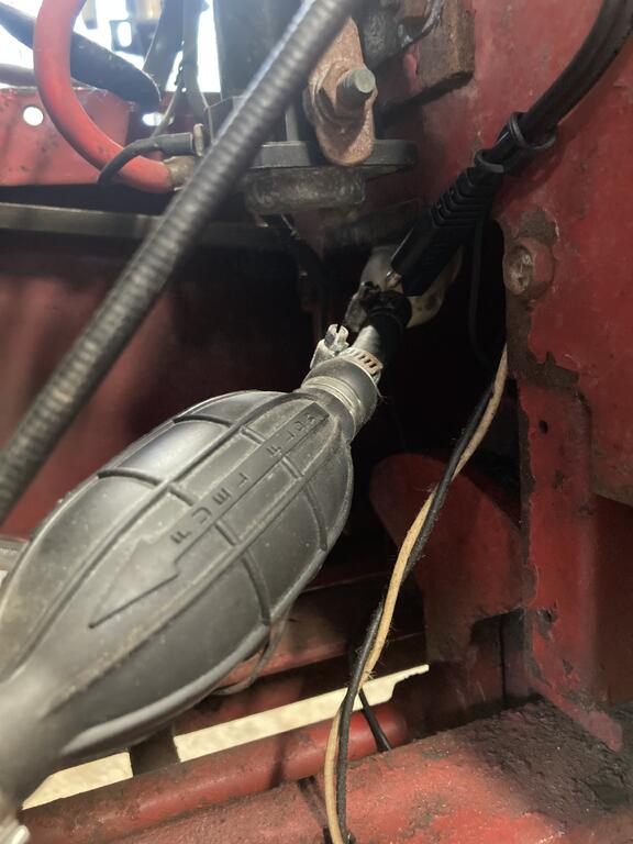

ri702bill 13,394 #6 Posted September 11, 2024 (edited) Is the fuel pump losing prime while sitting?? The 312 has the gas tank under the seat like my C81 - I had the same hard starting problem. Added a 1/4" primer bulb - issue solved. Over time, the OE fuel pump check valves accumulate crud that keeps them from doing the sealing job..... Edited September 11, 2024 by ri702bill 1 Share this post Link to post Share on other sites
SylvanLakeWH 32,921 #7 Posted September 11, 2024 Same on my C-105... Couple squeezes of the bulb and fires up instantly... 1 Share this post Link to post Share on other sites
Ed Kennell 47,948 #8 Posted September 11, 2024 1 hour ago, SylvanLakeWH said: Same on my C-105... Couple squeezes of the bulb and fires up instantly... Same on my 310, 312, and 520. Save a battery and starter....install a primer bulb. 1 Share this post Link to post Share on other sites

jsp_333 306 #15 Posted September 11, 2024 Primer bulb on order. Double checked valve clearances as per Lynnmor. No luck I've attached a brief video of what's happening. Next is static timing. IMG_3179_T2.mov 1 Share this post Link to post Share on other sites

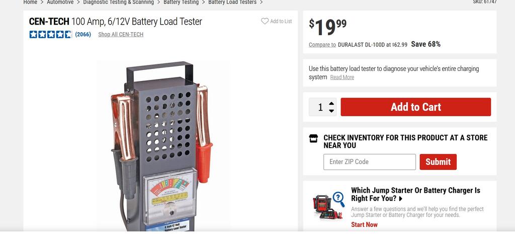

pfrederi 21,342 #16 Posted September 11, 2024 (edited) Did you load test the battery???? Sounds like some of mine with old batteries... Hook up you multimeter while cranking how low does it drop... Edited September 11, 2024 by pfrederi 2 Share this post Link to post Share on other sites
jsp_333 306 #17 Posted September 11, 2024 We have an expression in Canada goes something like this FUUUUUUUUUUUUUCK! New Battery. Fired right up. Feel really embarrassed. I've picked up 3 or 4 tractors this year and I guess a bad battery got in the 312. Tested at 13 volts but dropped to 6 volts under load. This is what comes from being a cheap bastard and not getting a new battery immediately for any new-to-me tractor. 1 2 Share this post Link to post Share on other sites
pfrederi 21,342 #18 Posted September 11, 2024 If you have 3 or 4 tractors it is well worth spending a few buck for one of these 3 Share this post Link to post Share on other sites
jsp_333 306 #19 Posted September 11, 2024 pfrederi yeah got one of those. Just didn't check battery under load. The tractor I put the battery from the 312 in doesn't start now either. Lesson learned. Share this post Link to post Share on other sites
jsp_333 306 #20 Posted October 18, 2024 On 9/11/2024 at 9:22 AM, SylvanLakeWH said: Two squeezes and she fires right up... On 9/11/2024 at 5:19 AM, ri702bill said: Is the fuel pump losing prime while sitting?? The 312 has the gas tank under the seat like my C81 - I had the same hard starting problem. Added a 1/4" primer bulb - issue solved. Over time, the OE fuel pump check valves accumulate crud that keeps them from doing the sealing job..... Update; Tried to fire it yesterday and nothing. Gave up pissed off. Then I remembered I hard installed the primer bulb. Went back outside, couple a squeezes, and she fired beautifully. Again THANKS ALL. 2 1 1 Share this post Link to post Share on other sites
