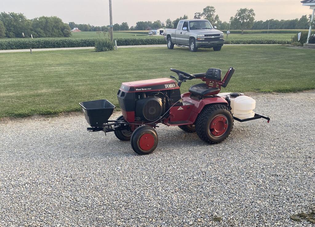

Tonytoro416 1,372 #1 Posted September 9, 2024 Hey guys been good while since I posted anything at all really but I still been working on the herd. Some may remember I made up a sprayer and spreader apparatus for my 416. This has worked out well but has also evolved into more spreading and spraying naturally. So I have been hauling the tractor quite often on my 12ft utility trailer. I have x track across front of the trailer and across the rear. I’d like to see how you guys strap down your horses and other tie down systems that may or may not work. I just haven’t found a good way to strapping the tractor down that is fairly quick and doesn’t loosen up a tad from tractor scooting a little. Any ideas and pictures I’m open to. Just interested to see what others use for hauling adventures 2 3 Share this post Link to post Share on other sites

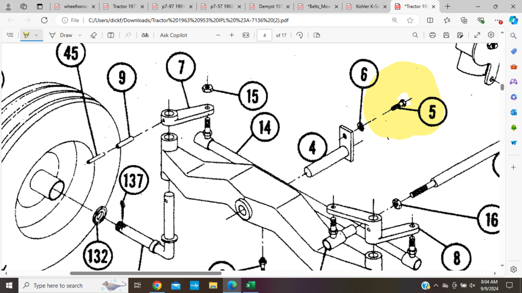

953 nut 68,175 #5 Posted September 9, 2024 I have replaced 3/8" the bolt that holds the front axle pivot pin with a welded eye bolt. Ratchet straps hook into it going out to both sides at the front. At the rear I connect the trailer's strap winch to the trailer hitch of then Wheel Horse. 2 1 1 Share this post Link to post Share on other sites

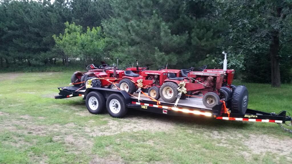

Handy Don 17,202 #16 Posted September 12, 2024 @Pullstart put me onto one of his techniques and I’ve used it since. Two 2”, 6,000 lb ratchet straps front to rear to frame-bolted heavy D-rings at each end. (And yes, an extra $25 on straps is peanuts, gents.) In between, each strap makes one turn around the rear axle and one turn around the front axle. I’ll sometimes add a small strap crosswise. If one of the big straps fails or loosens, the other is still adequate for basic situations. This is unlike separate front & rear straps where if one fails the tractor will likely move. I check trailer tires, hubs, hitch, and straps within the first 30 minutes on the road and again every two hours. 4 1 Share this post Link to post Share on other sites
